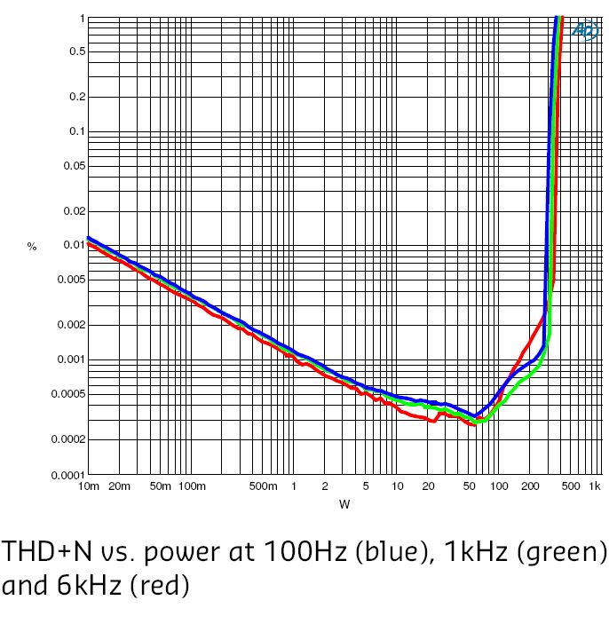

This is the effect of increasing noise with lower levels, because you measure THD+N. The only sure way to measure low level distortion is with a spectrum analysis with enough averages to get the noise down.
jan
Bruno Putzeys' Class A amp, pinched the graph from Sander Sassen's home page.
(mine do close to 100/8, and way better built if i may add in my usual utterly modest self :clown:)
Main point was to show the THD+N at low output level.
At 1mW output (or 1/1000th W for Mr Keiser), distortion total will undoubtedly still be way under 0.05%
Quiescent current level in the Halcro's is much higher than average, the 8.9% figure at 1mW can only be total crock.
