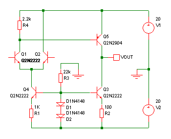

IMHO, the main trick is not to let the IPS current be affected by the VAS output voltage.Some authors suggest to isolate the IPS and VAS ccs references. Some use the same reverence. Cost savings, but would not they have negative influence on each other? Or is the influence an advantage?
The pic below shows how to completely screw it up. If the output ever clips to the negative rail, Q3 saturates, the voltage across the diodes drops, the IPS is starved of current, and the output remains stuck to the negative rail indefinitely.
Correct. How do we fix it?
1K in line with the based of Q3.
And then maybe 1nF from the base of Q3 to that of Q5...
Ciao T
