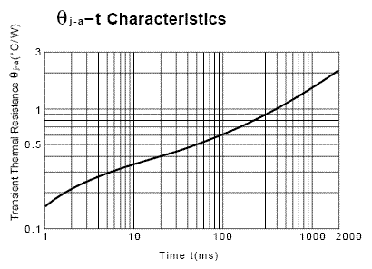

According to this graph from wahab's datasheet, if the device starts to dissipate 30W of heat, it takes only 10mS for the junction temperature to rise by 10 degrees.
So in a class B (or AB) amp reproducing a 50Hz square wave and dissipating 30W alternately in the two output devices, I would expect the junction temperatures to be fluctuating by about 10 degrees at 50Hz in a roughly sawtooth fashion. This is apart from the slow rise in temperature as the heatsink warms up.
Debate about the significance could drag on indefinitely, but can we at least agree that this kind of temperature fluctuation with signal is possible?
