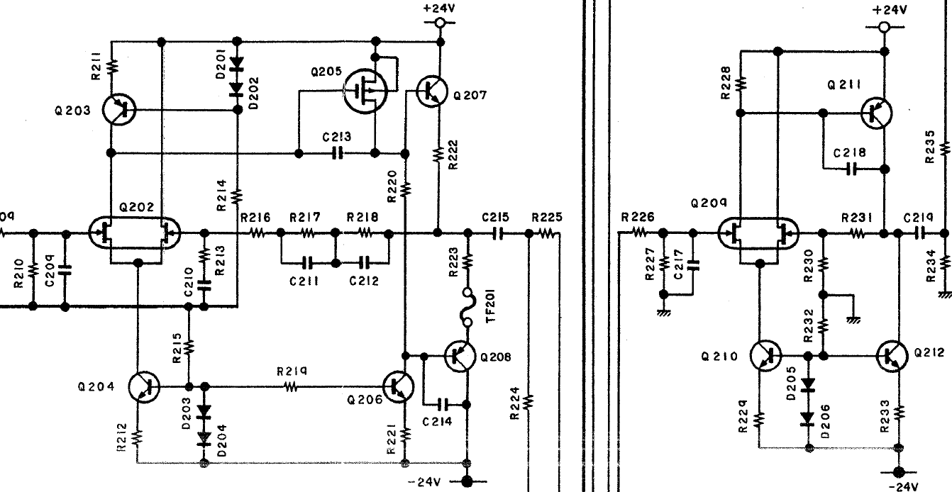

Wonder what the schematic of my "new" C5 Nak looks like. I guess it is all FET as it is a Pass design. Seems to work quite well.
If it is a Nak CA-5 (not C-5) like this:
attachment.php
The MC Stepup is a single 2SK170 in common gate. I have the service manual if you would like it.
