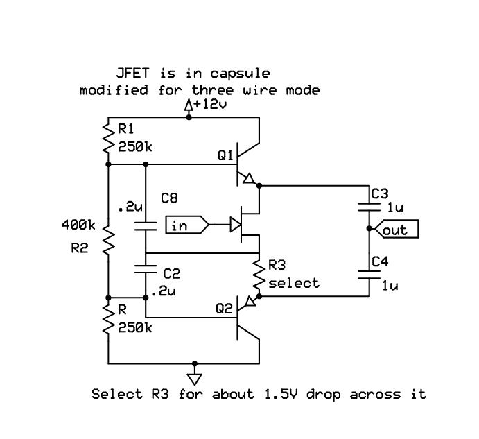

This is a cute circuit for a modified WM61 or equivalent. The distortion will be from the capsule only.

No the gate floats biased by leakage current, just as in the normal connection.
I like it. The loading effects of the FET capacitances are almost entirely bootstrapped out, both at source (which looks like it's being fed from about a megohm or so) and at drain, and with that their propensity to distort is removed. Output Z is fairly low, and who cares if you don't have voltage gain as you can supply that readily enough afterwards. Power consumption is low.
Sometimes capacitors are our friends.
:cool:
