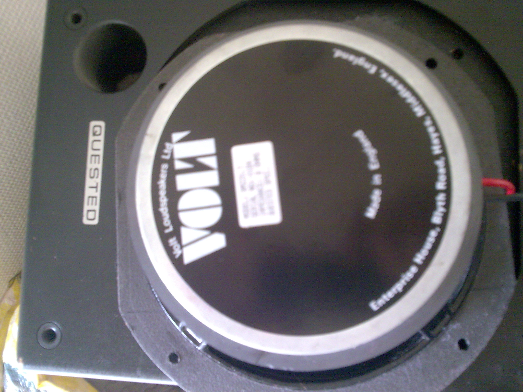

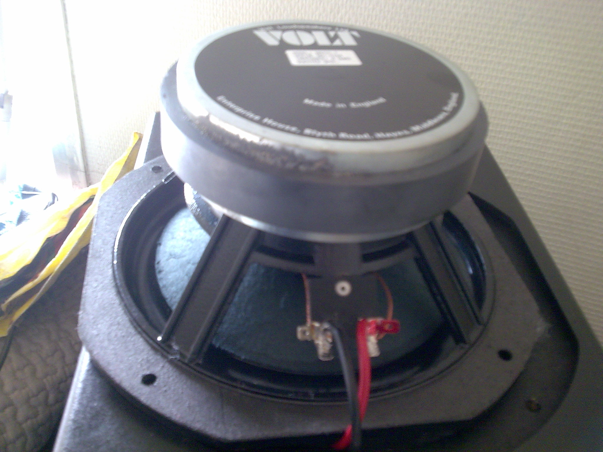

Since there s only four screws i dismonted the bass/medium driver.
It s built specificaly for Quested by Volt Loudspeakers.
The marking is BM220.7 Quested specs.
No trace of THD graph in their datasheet anyway for
current approaching models...
Ah yes, Volt, they have such a low profile these days, I tend to forget about them.
The BM220 generally has good LF performance, but midrange distortion may also be a little on the high side.
Alas, no independent tests I know of either. So as one of our Dutch contributors has in his sig "To Measure is to Know".
As said, the Panasonic WM61 or the Transsound equivalent linkwitz modified is low enough HD to show up big problems.
Ciao T
