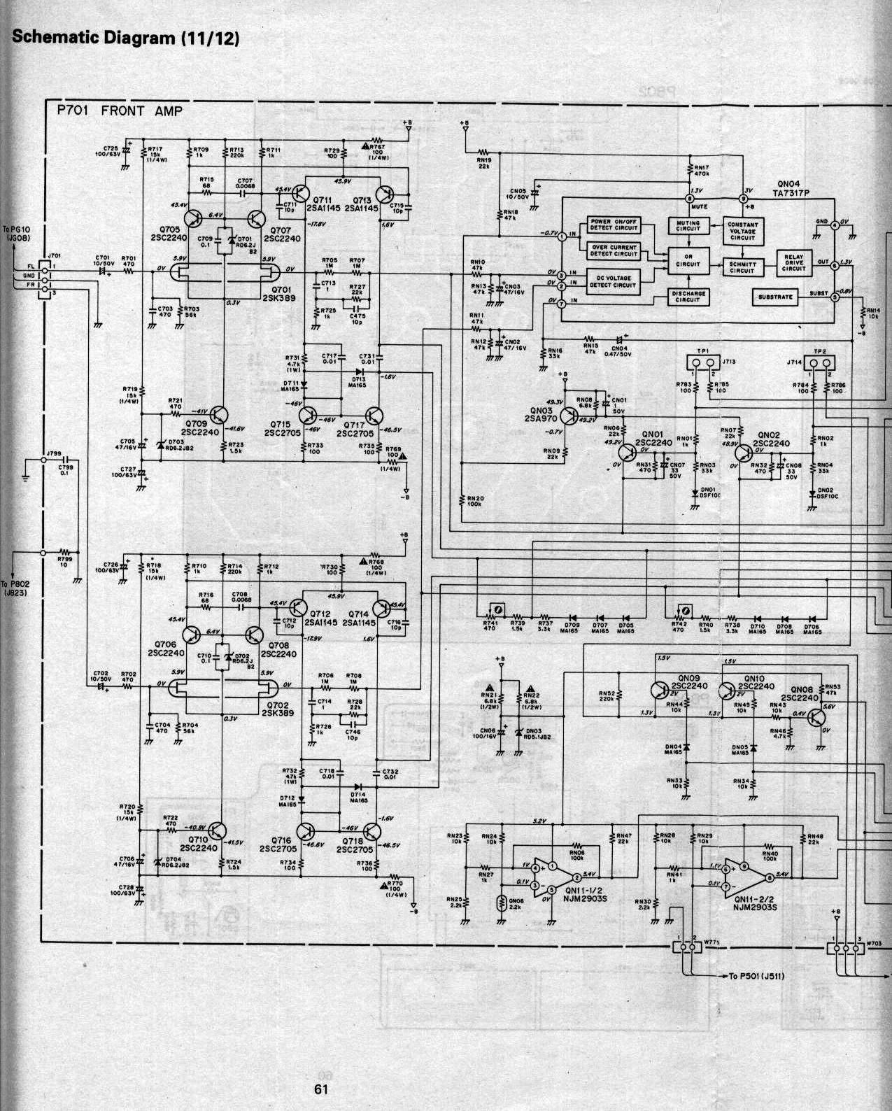

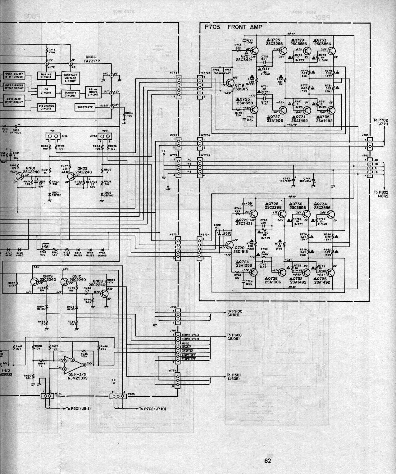

Not wanting to derail the current direction of the thread and drag it back to where it was a few weeks ago, but I found the part of the conversation discussing different design techniques and topologies for power amps quite interesting, particularly different approaches to feedback like high open loop gain with high total loop feedback vs local degeneration with lower open loop gain and feedback etc... and the seeming inadequacy of "conventional" measurements like THD to describe whether an amplifier sounds good or bad...
I have to admit that in years gone by I've been a bit of a sceptic about one amplifier that "measures well" sounding any different from another amplifier that also "measures well", (given how small the measurement differences between good amplifiers are, compared to the huge differences in measurements between one speaker design and another) but I now have to admit that I have heard amplifiers that sound significantly better than many others yet don't measure particularly different, at least in terms of frequency response and distortion.
(I'm aware that there are certainly more advanced measurements than this that can be taken, but not being an amplifier designer myself I don't know what they might be, and which might correspond to perceived quality, which I guess is the whole point of this thread...)
Out of curiosity I've attached the schematic of an amplifier that I particularly like the sound of, which measures well with conventional measurements but I find sounds significantly better than many other similar spec amplifiers I've heard, and I'm quite interested in any comments from the likes of Wavebourn and ThorstenL on (a) whether they think the design is good or bad in their opinion and (b) whether its just a typical by the numbers "textbook" design or whether there is anything clever/unique/novel about it that might account for a subjectively pleasing result. (or is it all just in my head ;) )
Extra points for recognising/guessing what brand/model it is :p
