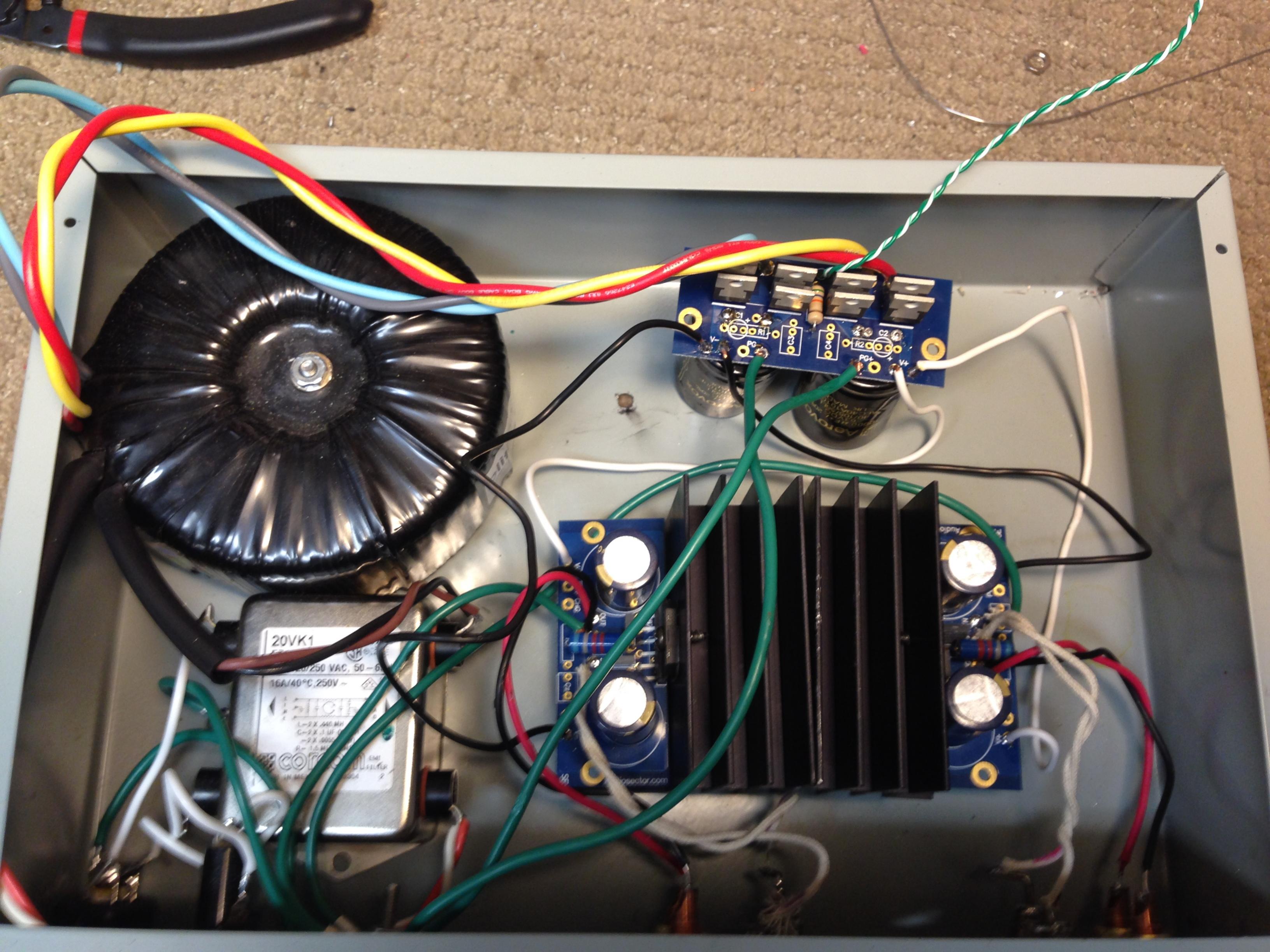

Here's my ZENQUITO EVO 5x50W. I drive Fostex full range speaker with. I buikd a BOSOZ from N.Pass to go with. And sound's quite good : clear, détailed, strong bass, impressive sound stage in depth from front to rear. I have haven't noticed any bad thing.
