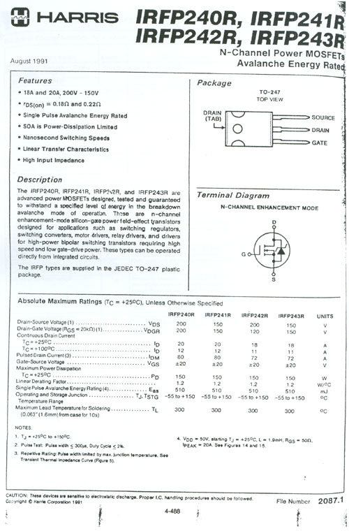

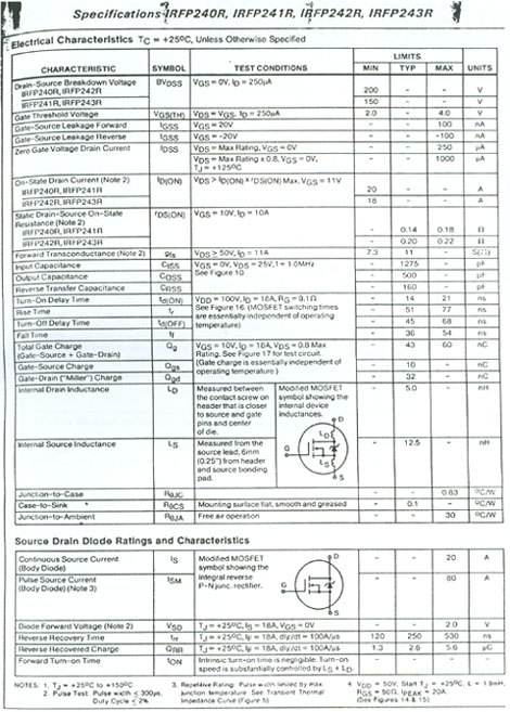

This response is from purely looking at spec sheets and amplifier topologies - I haven't built my hybrid amp yet - it would seem that higher bias (up to a point) tends to boost the effective small signal transconductance of each device, increasing (and reducing the effective dynamic nonlinearity) of the output stage's damping factor particularly in a push-pull topology.
Nelson says that it is the total bias and not the bias of each individual mosfet that matters. These may well be true for Vertical Mosfets running in Class A with a relatively high bias current!
One question in this regard is, what if one were using Lateral Mosfets of say, the Hitachi type; these devices require an optimum bias of 100mA. Hence, when parallelling these devices, would one multiply the number of output devices with 100mA or would TOTAL BIAS be set without taking into account the actual current flowing through each mosfet? In the latter case, would these devices still exhibit their negative TC characteristics?
Would Nelson and/or someone else like to throw some light on the above question?
