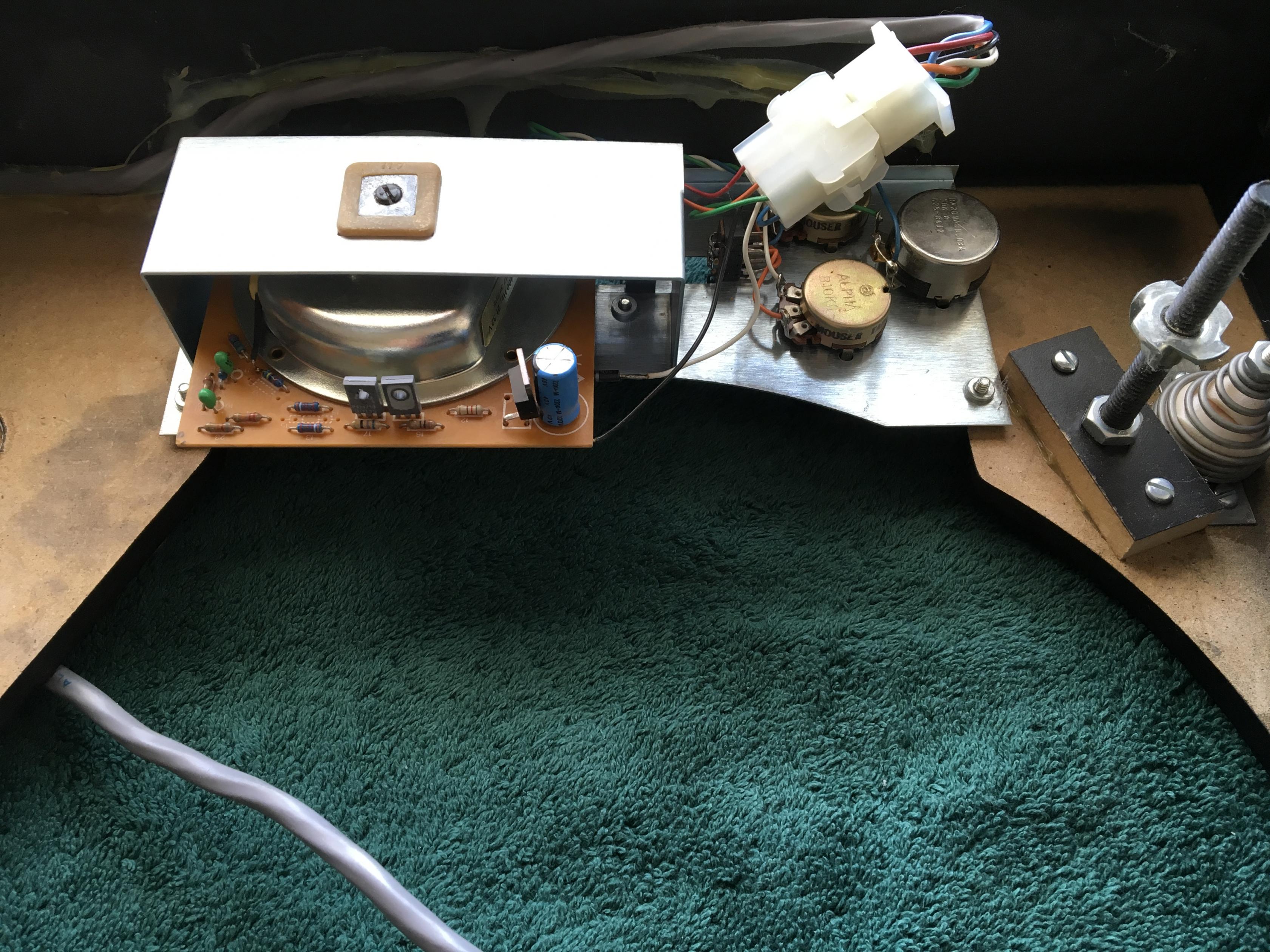

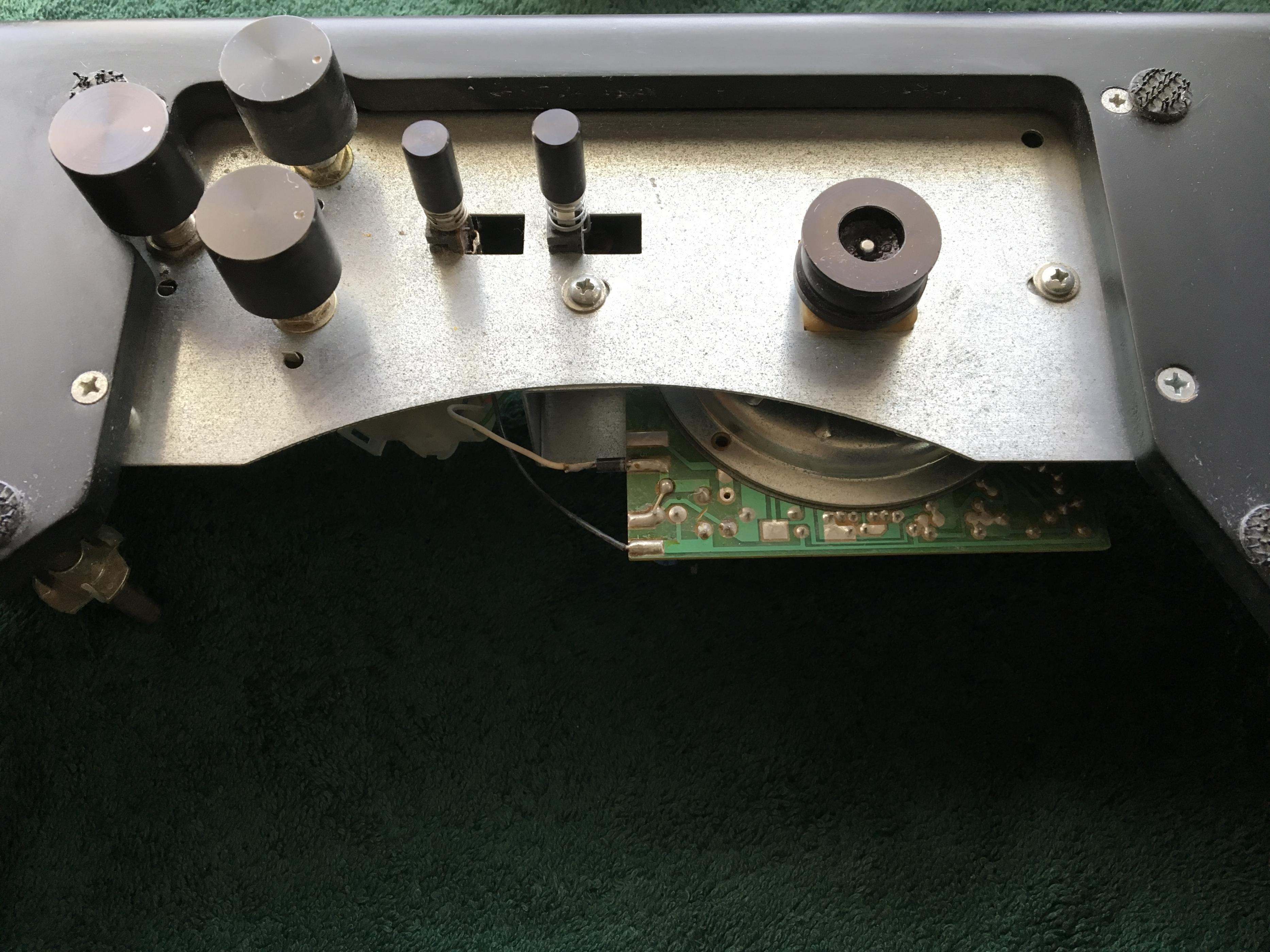

Right now the platter is snugged down by the transport screws. Knowing the Sota reputation for easily damaged bearings, I don't want to remove the platter. I'd like to find some other way to get a look. I suspect some of the screws on the bottom will release the black top surface board; or drop the thrust plate from the chassis. But I don't know which. I removed the aluminum plate that covers the pulley and control buttons. I removed the tonearm board. Easy enough to release the motor mounting plate from the top surface. Obviously Sota won't publish a service manual, or I could get the answer there.

I want able, from the top, to work the motor assembly out of it's space without loosening the platter bolts. And I was able to fix the noise by twiddling the lower motor seating screw. But, there has to be an easy way to remove the bottom cover board to access that adjustment screw.

You can loosen the 4 corner screws and it should come out
The screw in the square adjusts the end play and when excessive, the motor starts making noise. If you have a way to measure the end play with a dial indicator, tell me what it is.
I posted somewhere this info about the tolerance and will have to check or just start reducing the play until the motor noise goes away, but make sure it has some movement

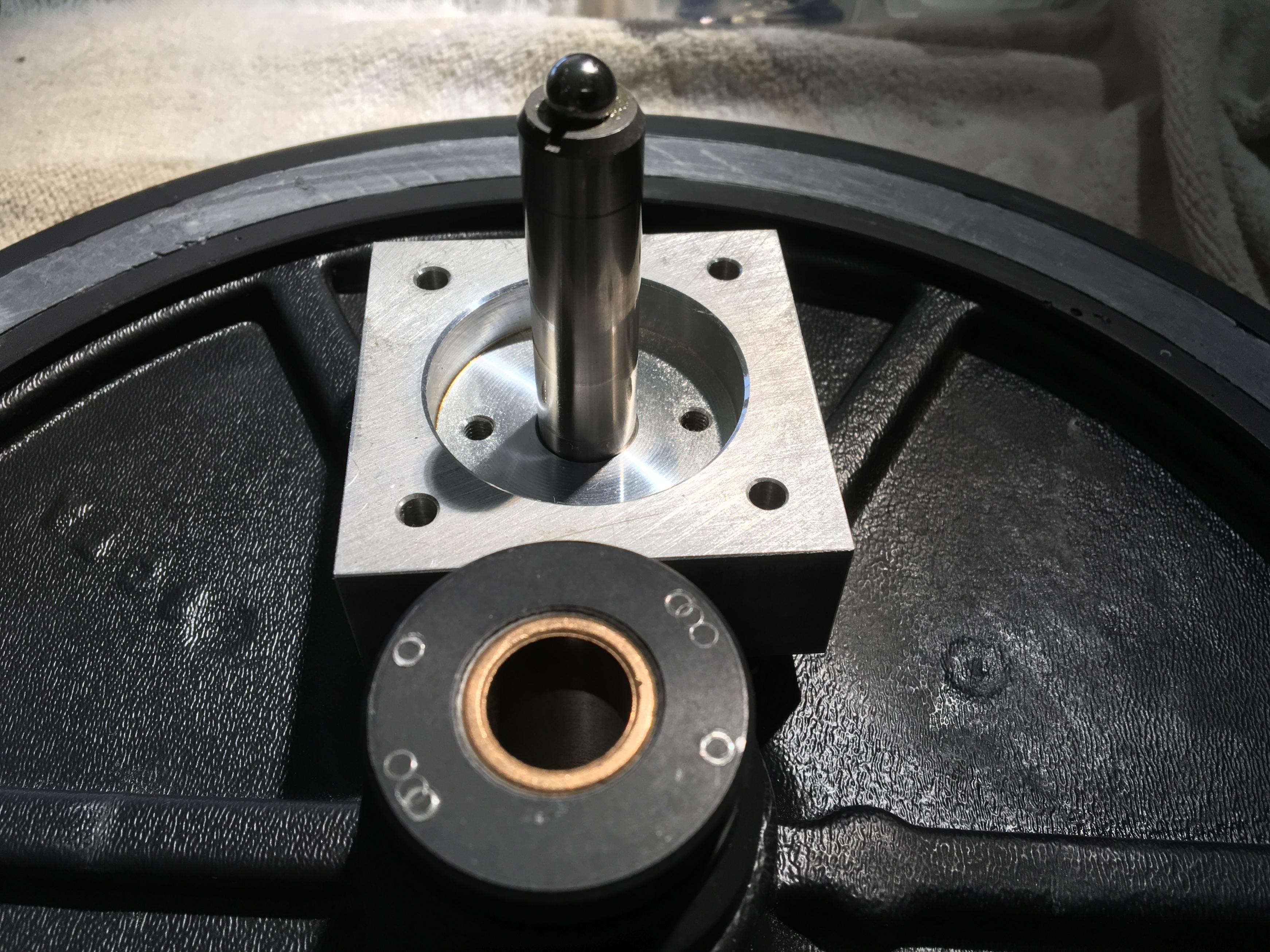

The platter assembly can be removed easily . Inside the base you see 2 screw holes that push against the rim area for transport. This pushes the bearing off the sapphire disc to prevent damage
This one a square mounting block and later ones are round, but the same design
There is a plate that locks the bearing/platter together to prevent the platter from falling out when turned over not shown.

Thanks for both replies. I got the assembly out just the way you recommend; I thought there might be an easier way. Not sure how or where you would measure tolerance. My motor has the square seat and has a set screw at the bottom. I had to remove the set screw all the way then reinsert it before I got the motor to quiet down.

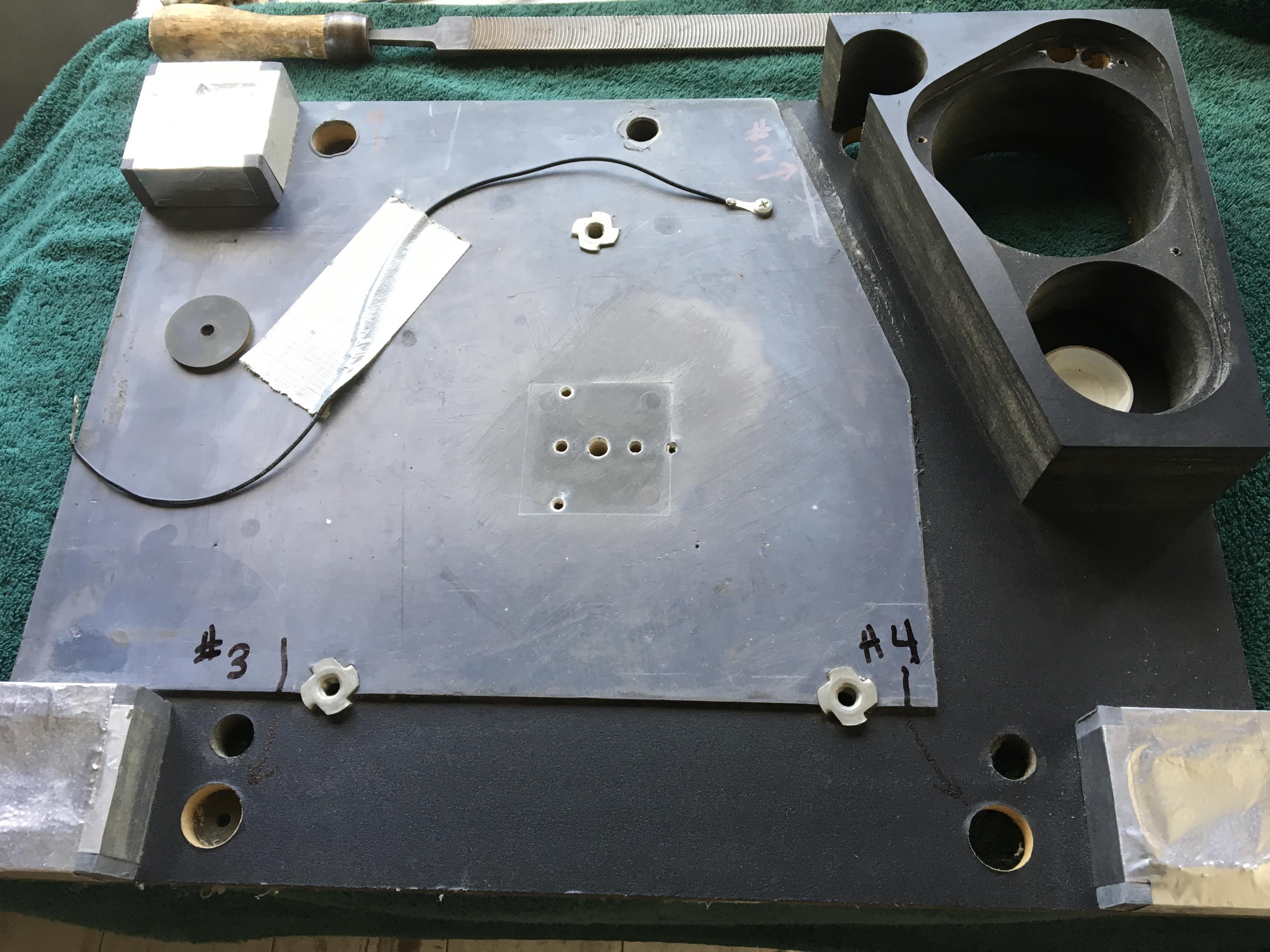

I'd appreciate a pic of the plinth assembly. It's little mysterious. I noted how precisely the arm board fit and wondered in the top black surface might be not attached to the oak plinth - maybe secured by some screws up from the bottom.

The plinth "hangs" on springs from the outside structure
I numbered all 4 spring locations. It is somewhat difficult to reattach and pull back the springs to attach the nut to each spring set, but doable

The only way to seperate the top from bottom plinth is to remove all 4 spring screws and the 3 adjustable feet

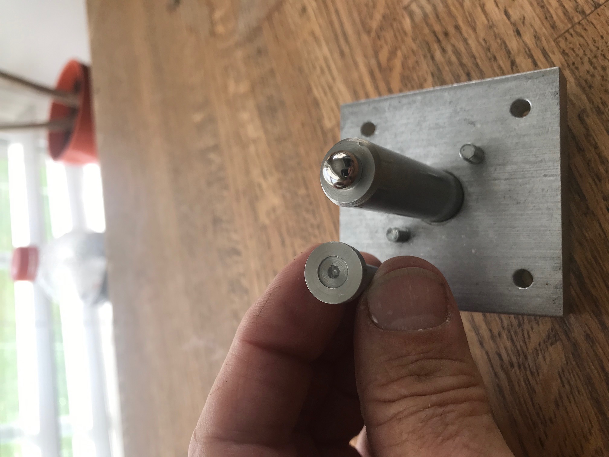

While your at it, remove the plate the keeps the platter/bearing together and look at the shaft. Excessive wear will not pass the finger nail test- if you feel the ridge it has wear dispite how it might look.
A call To SOTA a few years back mentioned they used Tuffoil lubricant. 2 drops per bushing.
Mine is the vacuum version. This seemed too little, but a youtube video asking this very question and the same size bushing showed when heated to an extreme- only 2 drops came out of each.
