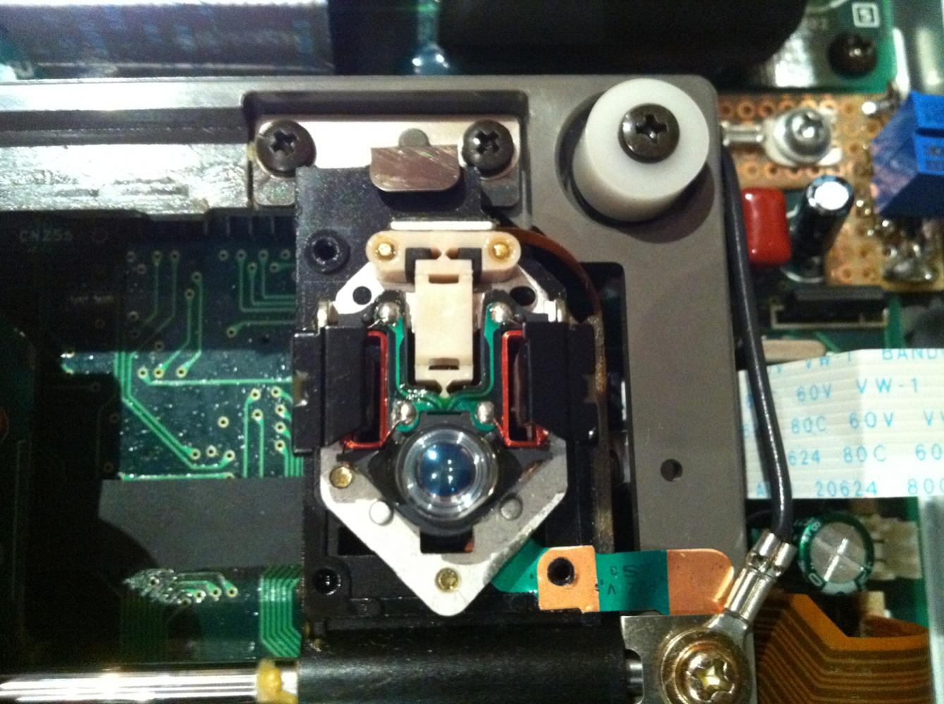

I did replace the laser - same effect. Trying to heat only the laser with the hairdryer makes the pops go away. I guess while working the laser gets warm anyway.Also very interesting.
In almost 16 years, the lens gut dusty or fogged up. But there seems no difference between the old and new laser.
I attached a photo of the old one.
Somebody wrote earlier that maybe the plastic bridge holding the the lens
gets too stiff when being cold. Hey Sony, did you really charge more than $1000 for this?
But this kind of plastic bridge / laser design must be in millions of players,
maybe even CD-Rom drives...:confused:

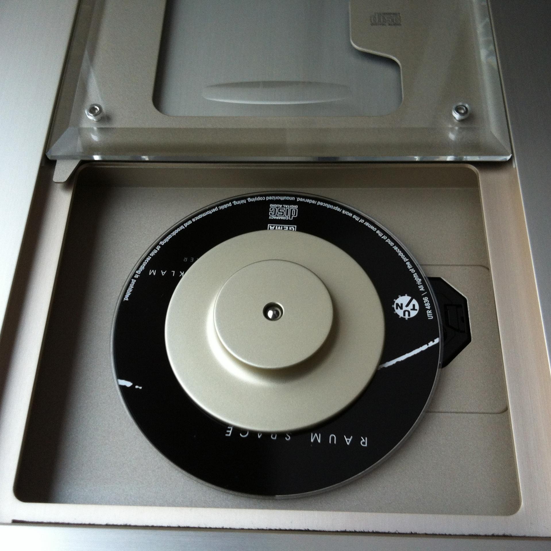

BTW I did mill stabilizers for the X5000 which weight about the half of the original stabilizer. With the clicking problem, the lesser and more favorable mass of the stabilizer makes no difference...
