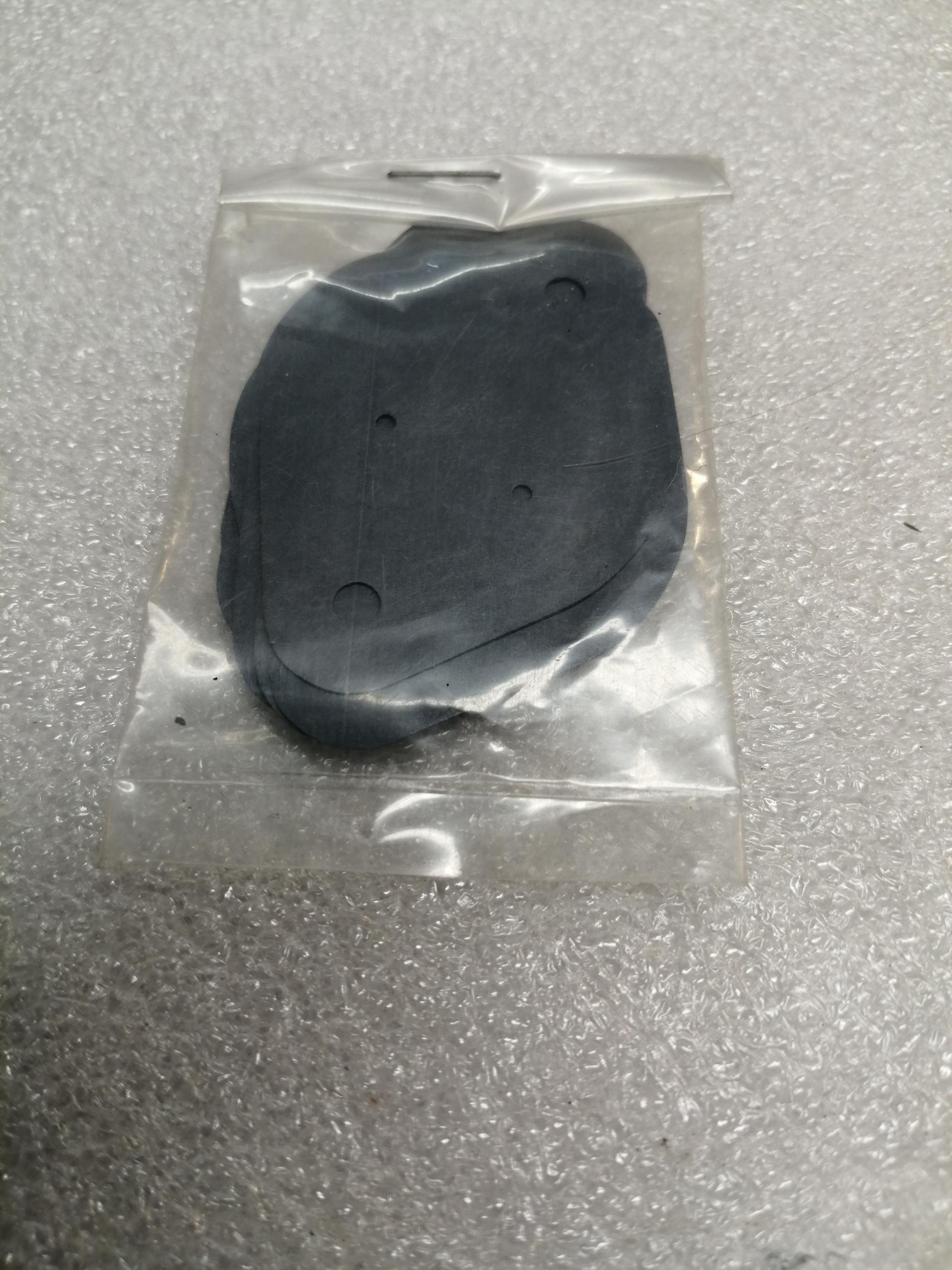

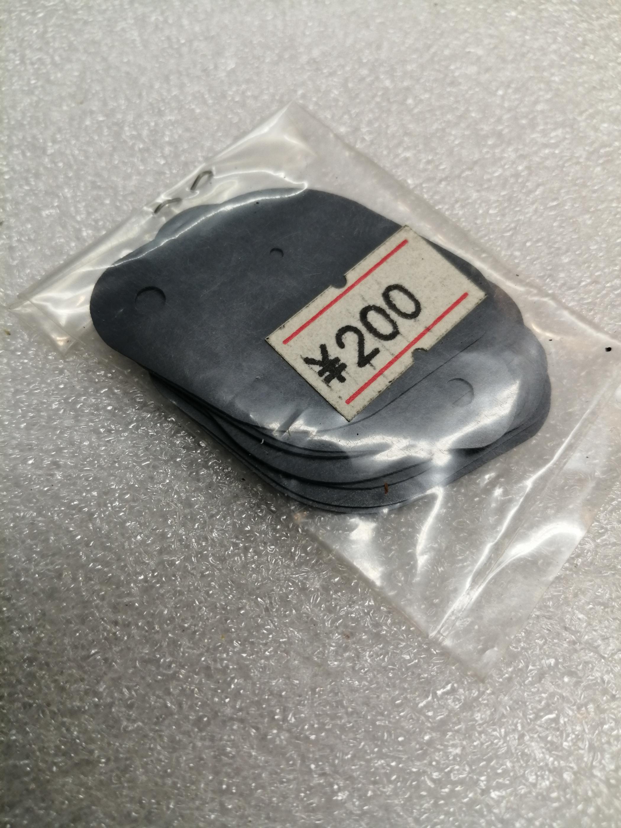

Has anyone not used Mica & goop ?
I found these in the "japanese exotics" drawer and would like to give them a try without risking to fry the Vfets...
The CMF55 in this value are actually in stock at Mouser and I wil replace them.
coolnose said:Has anyone not used Mica & goop ?
I use mica & silicone heatsink goop exclusively in all my past SS builds.
https://www.diyaudio.com/forums/pass-labs/359938-sony-vfet-csx1-adventures-grief.html#post6335476
I have not the need to go with silicone rubber pads etc. and fancy thermal paste (sometimes found in high end PC gaming machines). I do feel that as long as the surface area makes the transfer... good enough. How fast it transfers i'm not fussed about.
