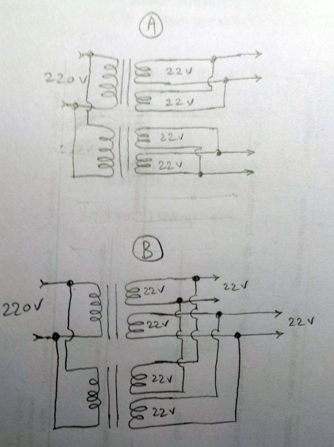

psu transformer
i am using a 300w trani which seems to be sufficient for this amp. however, i own also a second transformer of the same type , so i was thinking to parallel them (300w+300w = 600w ;) ) to check if there is any impact of a stronger transformer in the psu on the overall sound quality.
do you recommend this approach? is paralleling the transformers almost the same effect as using a bigger one or is there is any drawbacks?
if there is no risk doing that , which case would be the better one, A or B?
thanks and regards
