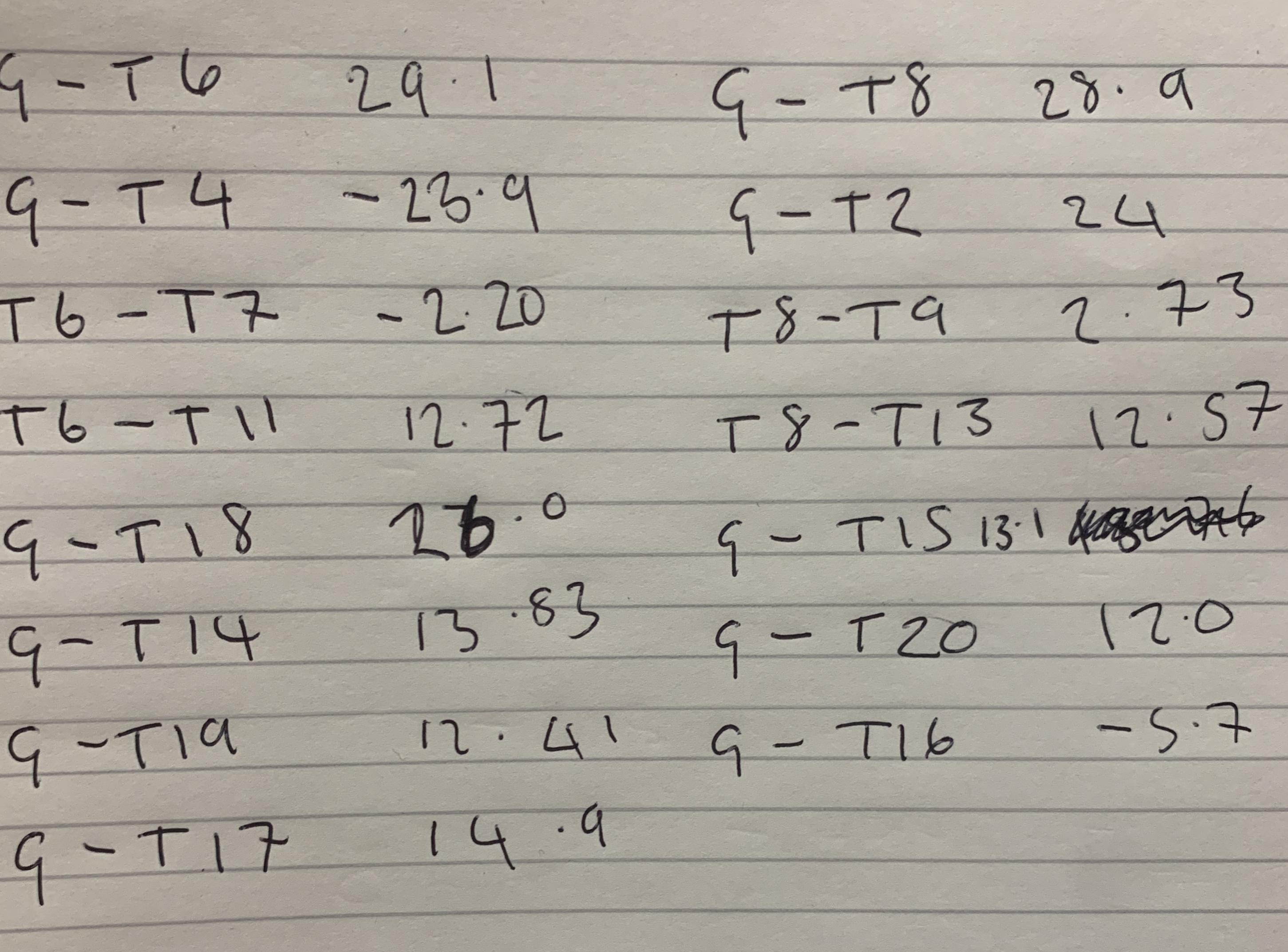

Can you try continue adjusting P4 to lower the G-T18 offset? See if you can get
it to less than 200mV.
Before you get all far, don't forget to adjust P1 and P2 so that
the T16 and T17 voltages are high enough to ensure the Vfets
have low bias when you install them.
( See top of page 8 of http://www.firstwatt.com/pdf/art_diy_sony_vfet.pdf )

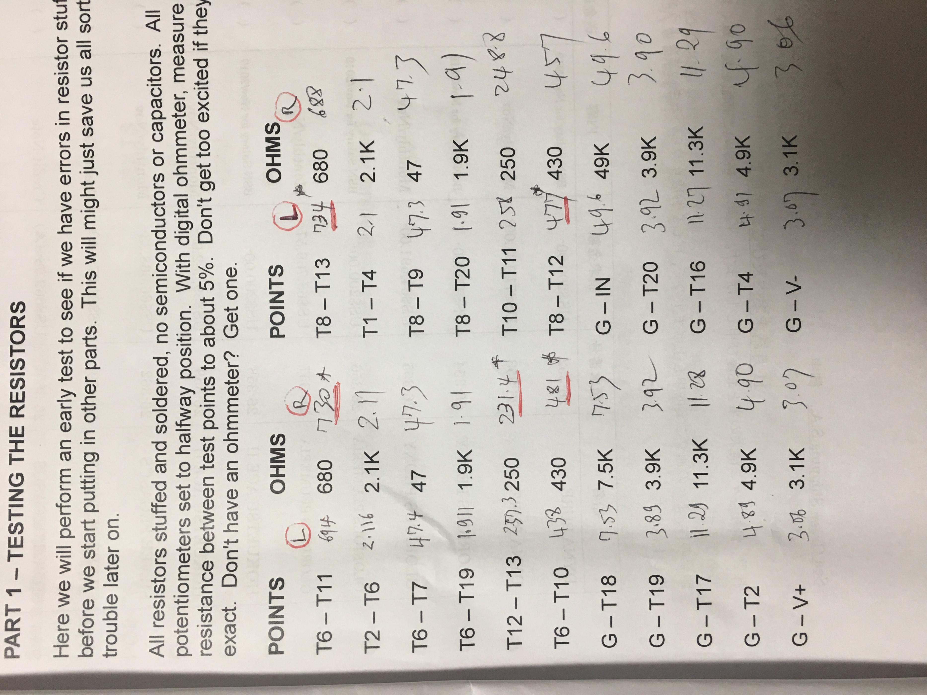

R15 and R16
Papa has noties: with 24VDC:
22V = 2.5V * (R15+4750 ohms)/4750 ohms 22V *4750 ohms / 2.5V = R15 +4750 ohms 41800 ohms = R15 + 4750 ohms
R15 = 37050 ohms.
You would pick the closest 1% resistor, which would be 36K or 36.5K for R15 and R16.
So with 28 vdc we have R15 or R16 is 44650 ohms. But in the schematic resistors 15 and 16 is 41.2 kohm
Which value is right for 28vdc voltage? 44.6 kohm or 41.2 kohm?
R15 = 37050 ohms.
41.2K will get you about 20V at T3, whereas 44.6K will get you about 22V.
It's more a question of the rail voltage you want to run the amp at. I suspect
both are fine, though the higher rail will run the vfets a bit hotter, but probably
a little bit more output.
41.2K should give you an amp with performance as documented.
Dennis

I didn't read papa's words carefully: 'If your supply is lower than this, you should adjust R15 and R16 down so that
the R19 and R20 have at least 2 volts across them. '. So if we use a bigger power source like 29v or 30v, we can still use this resistor value (41.2Kohm) without changing it, right?
thanks
Everything is pretty close, carry on.
