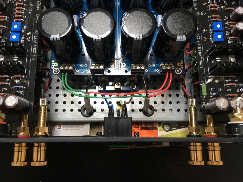

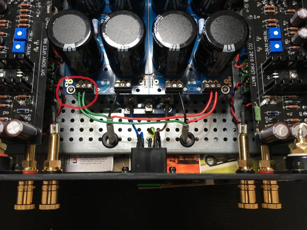

Hello,
I need your advice because I do not understand a breakdown on the Vfet amp that I just finished.
1 / Before connecting it to the sources and speakers for listening, I turned it on "idle" for more than 6 hours, Bias settings, offset, DC output are in the specifications.
3 / Yesterday at the end of the day so I hooked up to listen for 15 ' and everything worked.
3 / This morning turned on to hear it longer, as soon as the 2 mains fuses of the amp jump, I replace these 2 fuses delayed 1.6A by T 2A and run it on Empty by checking the settings that are in the specifications: everything is ok
4 / Re start-up for listening therefore connected to the sources and HP and there again the fuses T of 2A "jump" as soon as the switch is switched on.
5 / I connect another amp and the whole works, so this problem is not related to the connections of the sources and HP.
Conclusion: the amp works empty and is well regulated, as soon as it connects with the sources and outputs HP, it slams its 2 fuses.
Solution: Should I put fuses with more amperage?
(The transformer is a 400VA so 1.6A should be the norm)
Or do you have another diagnosis?
Christophe

show us some pictures

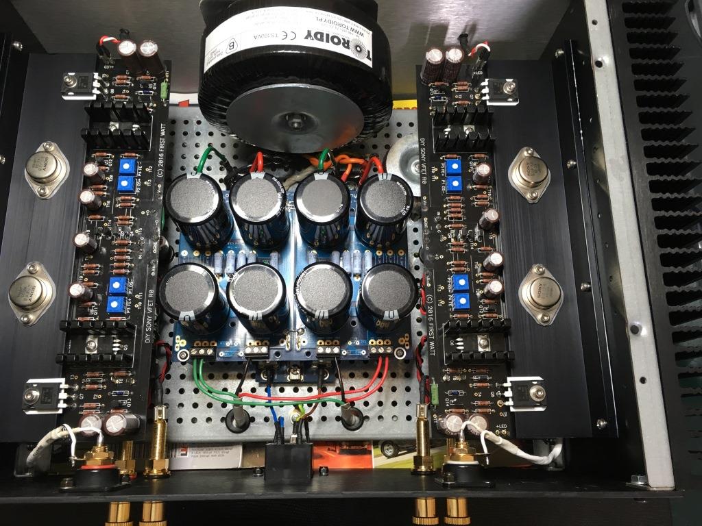

Hello
Bingo, after 6 hours of research I found the failure of the amp:
A miserable washer that touched the ground of the PSU. (see the first photo)
Now everything is back in order and the amp works perfectly.
Christophe

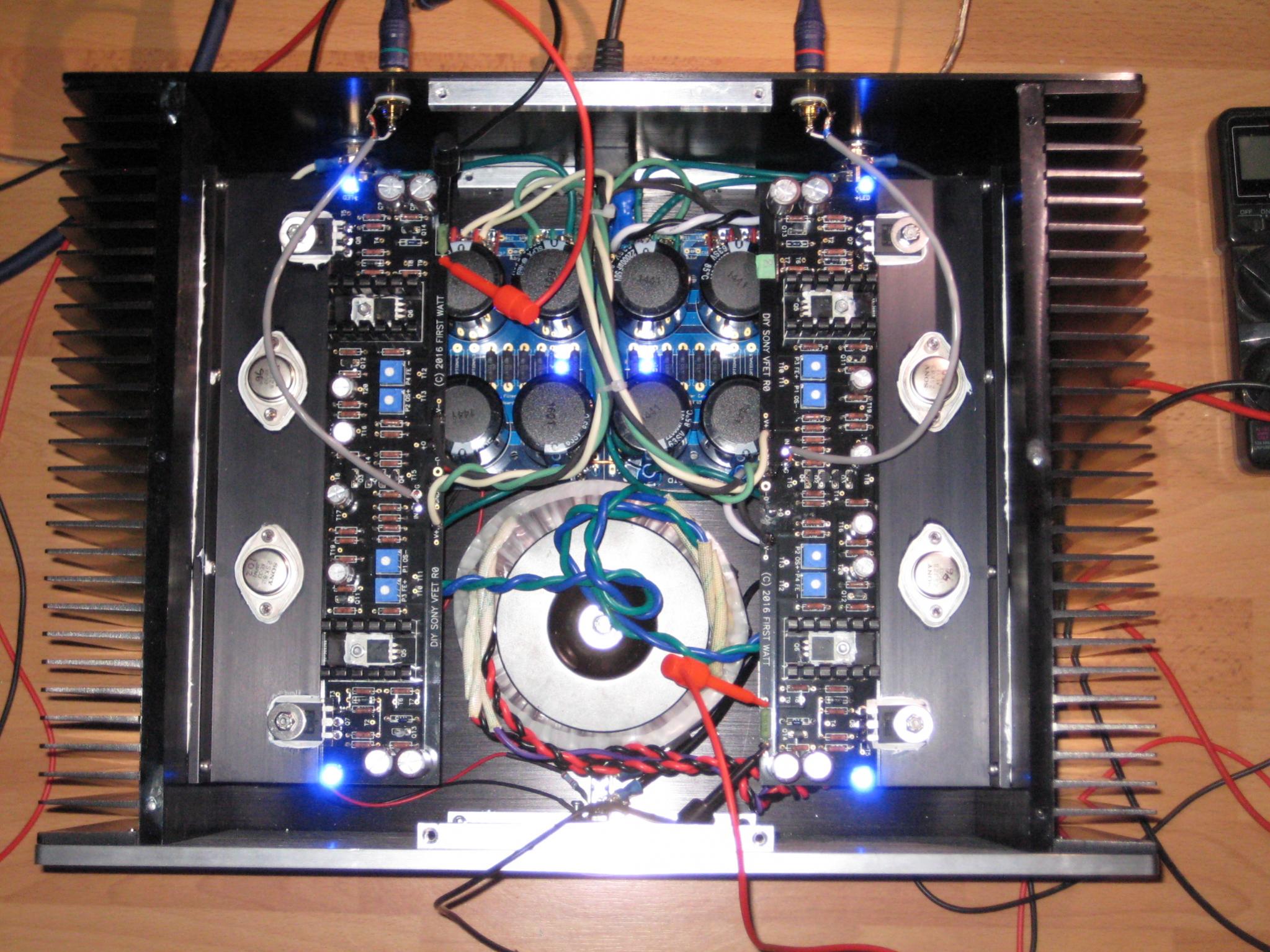

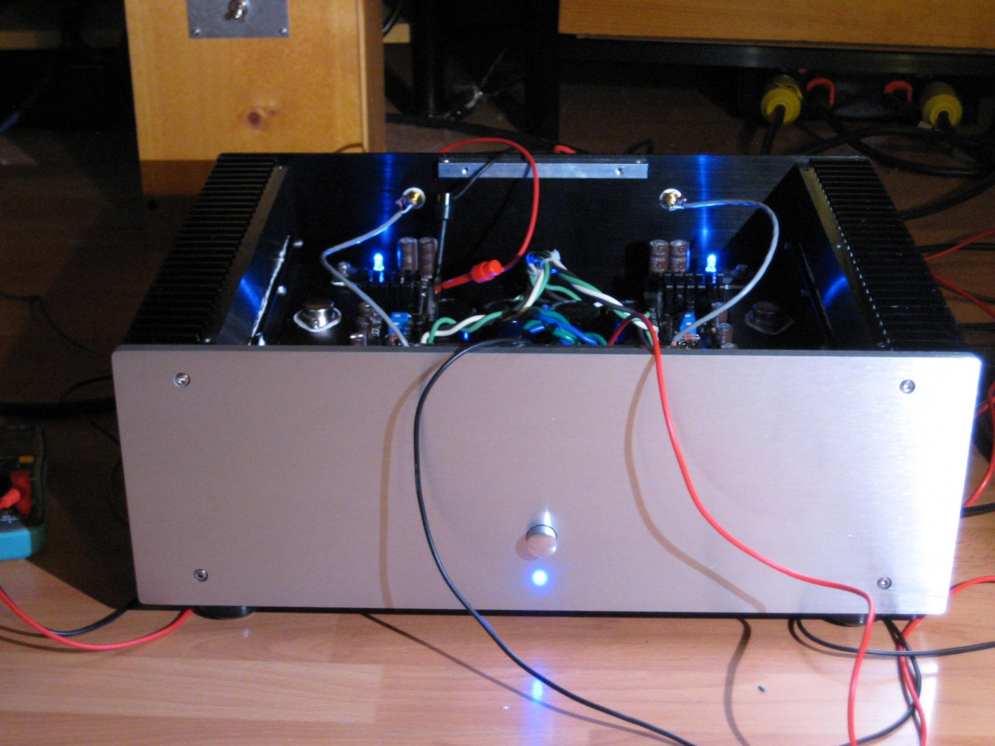

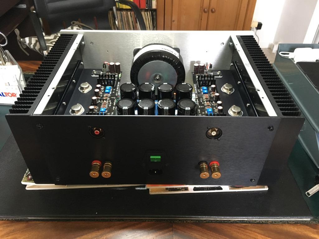

Joined 2012
I finished my Vfet amp a few days ago and have been listening to it on my test speakers. I must say that I don't recall ever hearing my old Dynaco A25s sound so good. So thank you Nelson and the DiyAudio team.
However, I think I do have a problem. The right speaker DC offset has a big difference between cold and hot operating condition. The right channel speaker offset measured +156mV cold and -16mV hot. T18 was +1440mV cold and +68mV hot. On the other hand the left channel speaker offset measured +62mV cold and -1mV hot. T18 was +572mV cold and -13mV hot.
This was the third or fourth attempt at setting up the right channel. During one of the other attempts I had output offset of +1mV hot and +165mV cold. I did not record all of the attempts so I don't have numbers for the other instances. It seemed that no matter what I did, there was an approximate 160mV difference between hot and cold speaker offset. The right channel T18 when cold seemed high too.
I also reset the left channel once and I was able to get good results both times.
During the build (with Batch 3 Essentials and Supplemental kits), I measured and recorded the resistances at the test points and they were within 2% or less between channels. I also measured the resistors before installation and they were more or less identical between channels, except for the pots where there were differences of I think 10%. I did not write the values down but I do recall that I noticed that they were not very close matches between channels.
When I first applied power to the front end, most of the test point voltages were very close between the two channels. There were a few that were not as close:
G - T17 .......... left -9.9v ........ right -10.9v
G - T8 ............ left -29.5v ....... right -28.9v
G - T20 ........... left -12.0v........ right -13.1v
V+,V- left was +-29.8, right was +-29.2. Measurements left and right were done at different times of the day.
I also noticed that the component temperature made a big difference to the offsets. The first time that I adjusted both channels, I left the top cover off. When I was satisfied with the numbers, I put the cover on thinking I was done. I measured again later and the offsets had changed considerably. So now I have been running the amp with the cover on and only sliding the cover plate far enough to take the measurements.
Any ideas on what I should check and do to lower the difference between the hot and cold DC offset of the right channel output?

Official Court Jester
Joined 2003
dunno for that ...... I was speaking of output offset
regarding T18 ..... clarify what you mean by "having XX voltage at T18"
edit: now , when I looked at schmtc to refresh memory , I see that T18 is test point , not transistor name :)
I presume that you bought input Jfets from Store ?
triple checked all soldering points ........ usual mumbojumbo?
Joined 2012
I've been going through the other Vfet thread, Sony VFET Amplifier Part 2, and I see that another Diyer in post #2867 had a reading of 1V at T18 at switch on from cold. So maybe what I am seeing with my amplifier is not abnormal.
Being new to solid state amps, maybe I am just being too cautious.
