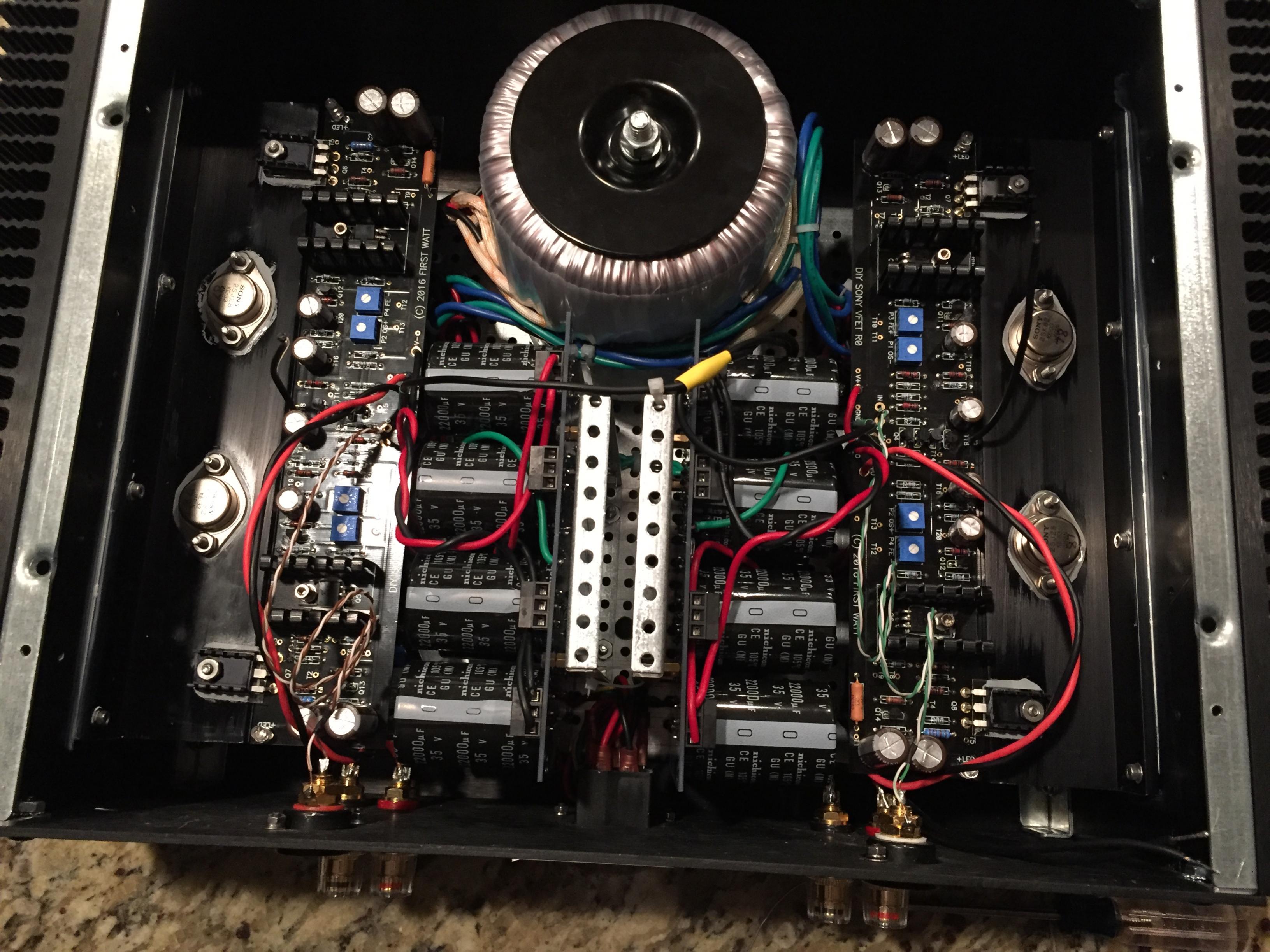

Going with dual mono with the trafos in the middle and capacitors below each board.

My progress report. Mine as well post this before I try and smoke the VFETs. She weighs in at 42#. Wish me luck!
Joe
Congratulation! It's very nice!
