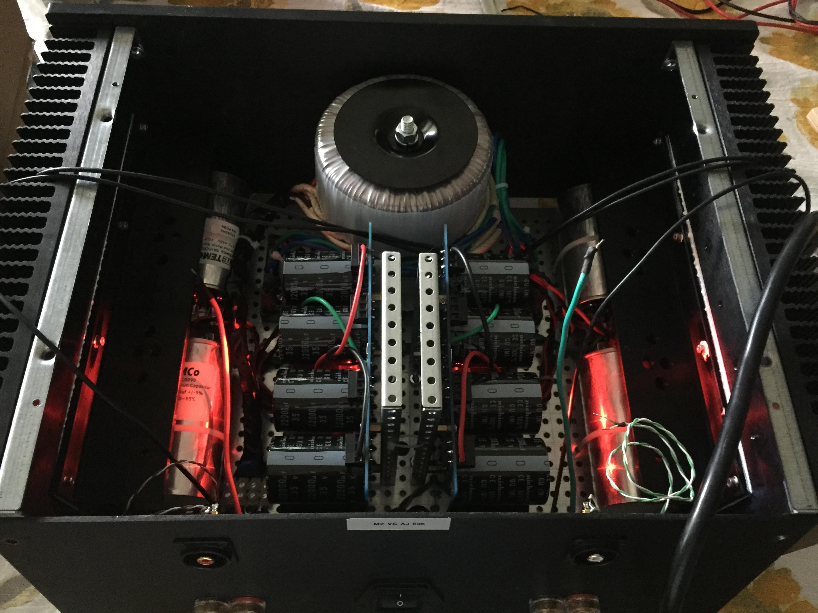

I am on the heels of Wdecho. Here is my freshly finished PS for the VFET I will be building. It is a tight fit in the 5U, but can be done. I'll begin the audio boards ASAP.
Joe
Looking good! I always enjoy seeing someone put something into the chassis in a different orientation.
Just a stupid question though, where do you put the motor run caps in the PSU schematic? Just across the rails somewhere after the resistors?
Easy, just put wires on one motor run cap and attach one to V+ and the other wire to star ground. Put wires on motor run cap and attach one to V- and the other wire to star ground. On the schematic you have just added two more caps.
The picture Cantilope posted does not show too well that he has 2 PS and 2 transformers in one big 5U case. I am envious. He is going to have monos but one case.
