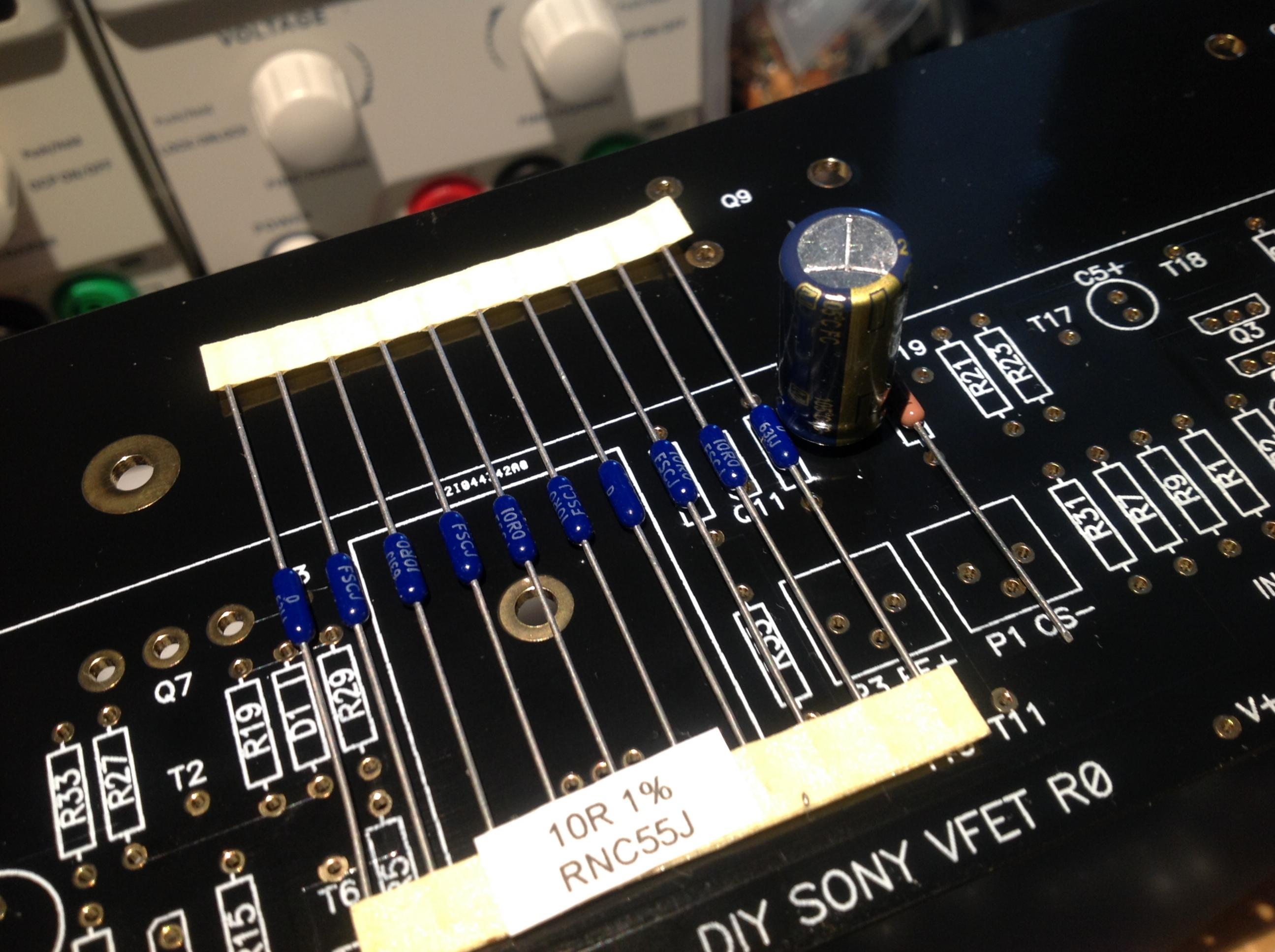

C3-6 (47uF) board lead spacing is 2.5mm and silkscreen diameter is 6mm. 10mm diameter Silmic II could be pushing it?
BK
Plenty of space on the DiyVfet pcb :D
Only C3 is little close to resistors if you use biger diameter capacitor
but ok if resistors diameter is like dale RN55C model or similar :)
ps . capacitor example are 10 mm diameter

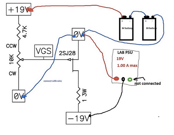

The attached image is the test setup I used to measure my VFets. I then used the following protocol to measure them:
1) Connect first meter across 1R0 3w resistor, connect second meter across Gate and Source pins of transistor
2) Connect the VFET to a 20V bench supply, limited in current at 1A for protection
3) Attach 18v battery supply across the pot
4) Start with pot at full CCW and increase the Vgate until you measure 0.5v across the 1R0 resistor
5) Record Vgs reading from transistor
6) Disconnect battery and PSU
The two Vfets that measured 11 & 12v also got hotter than the other Vfets during the few seconds it took to test them.
Any insights would be appreciated.

Great pic! I'm still a bit uneasy about the resistor proximity. There is a corresponding 47uF 25V Silmic II that has the right lead spacing and is 6mm diameter. What's a healthy cap voltage spec for this part - is 25V enough?
Are any locations actually better suited for a good non-audio grade cap such as Panasonic FC?? I get a warm fuzzy whenever I see long-life 105C caps with lots of voltage headroom...
BK
Looking at the schematic a 25V should be adequate. Test point T19 shows +14. Using a larger cap is no problem for me. Caps have long leads to suspend the cap away from everything and from what I have read it is not a good idea to put a cap directly on a board because of contracting and expansion pulling the leads of a cap. Probably never happen but.

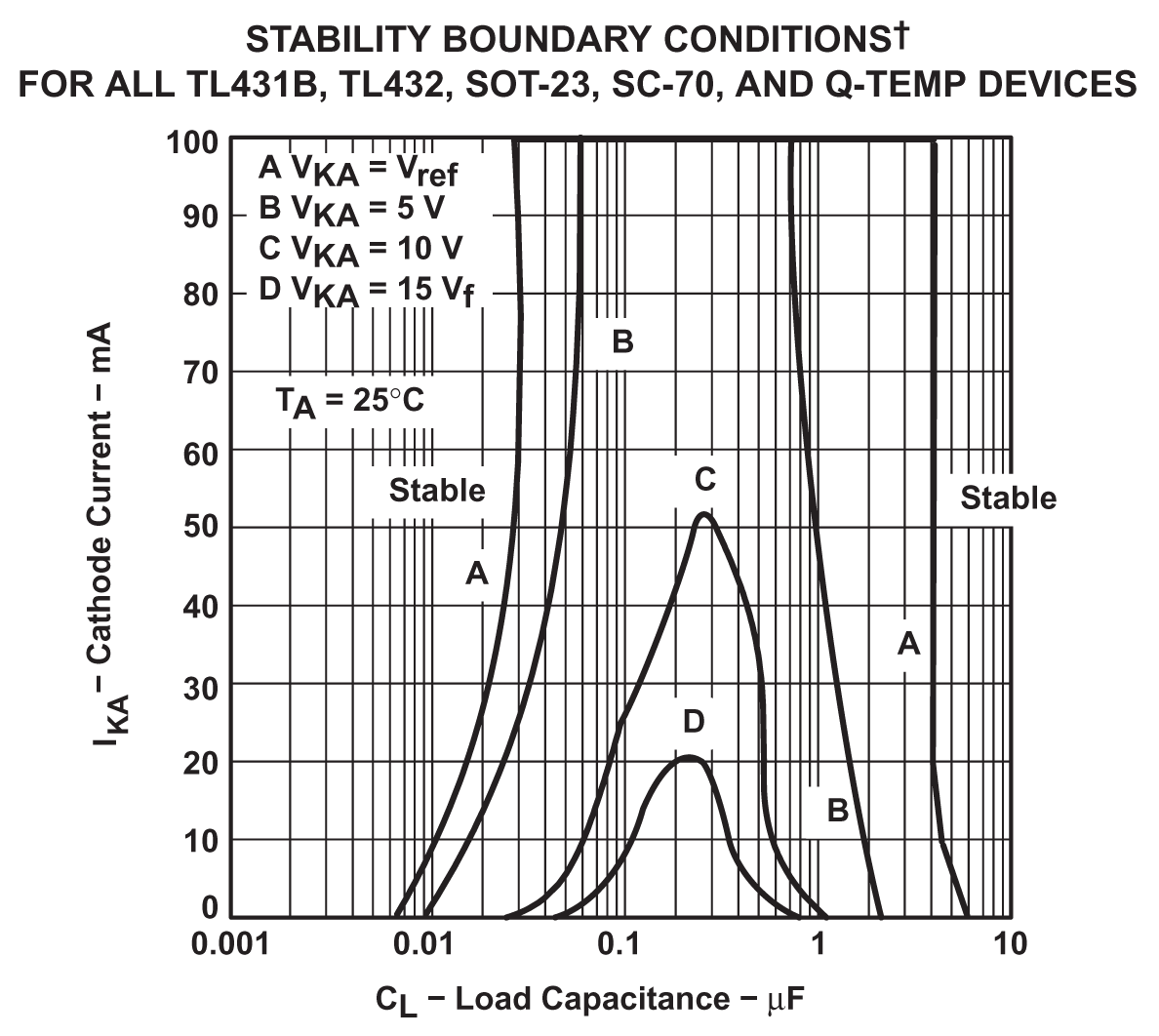

Attached (borrowed from TI data sheet) graph of stability vs conditions
for the B part which is a little less stable than the A part.
I have personally seen oscillation in the regulator with this amp for high
bypass values, so the maximum cap value I used was 220uF.

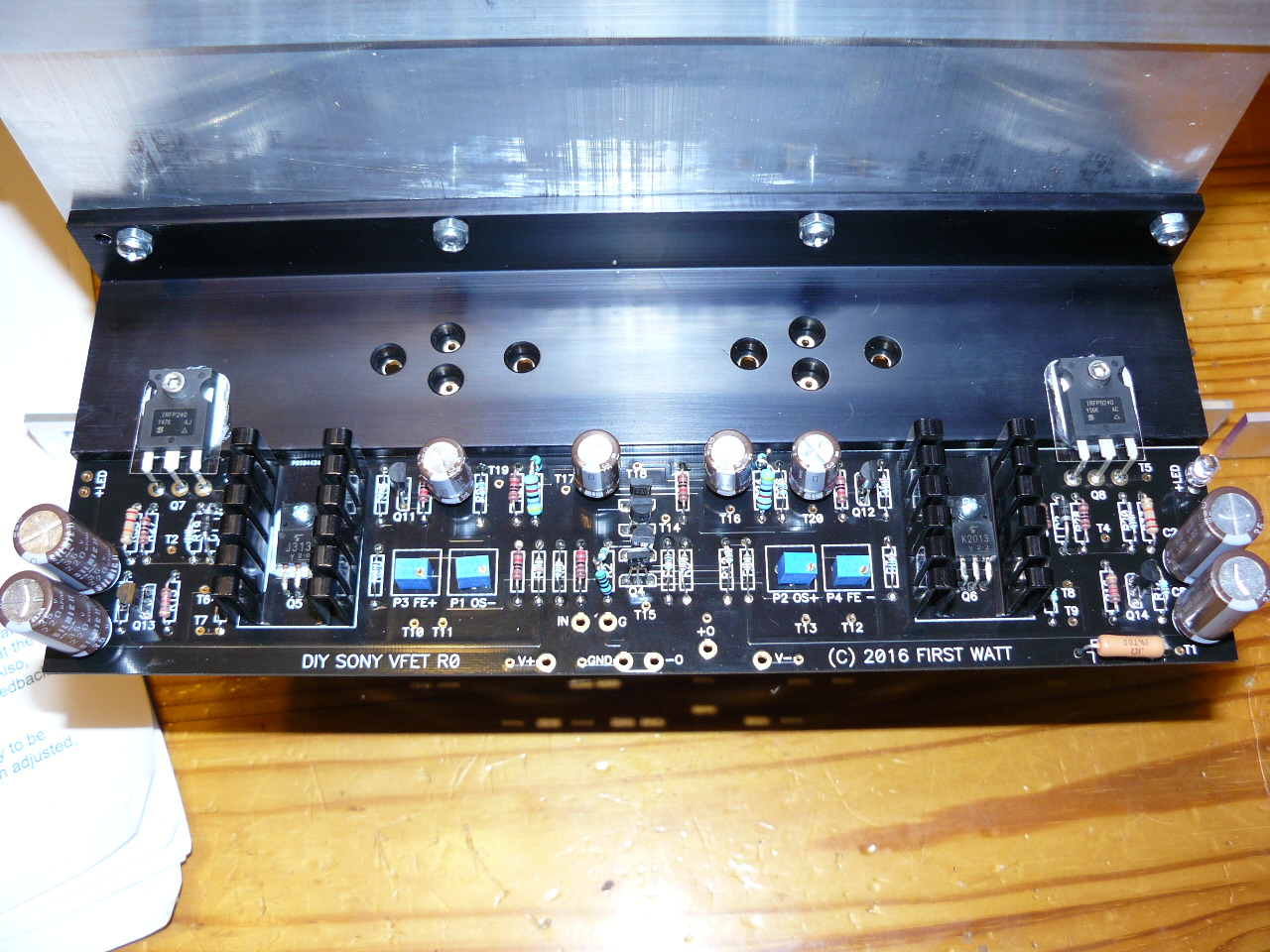

Also one can plan ahead with the resistors adjacent to the caps and put them a tiny bit off to the side. So will 25v work at all positions of the caps?
However that is EXACTLY what I'm asking you guys to check. Mechanical stuff, wrong resistor values, something ignored entirely,etc.
As far as the caps go I've also heard the opposite. That its its better to have caps tight to the board so they don't move and fatigue their leads. I actually agree that for caps that size it doesn't matter...

Is it possible to determine if the part is oscillating without the use of an oscilloscope?

From my very limited understanding of electronics I assume from Zen Mod's and Nelson's statements that the A's are best but the B's are good enough the way they are used in this circuit. Someone with more knowledgeable correct me if I am wrong.
To answer your question, again from my limited understanding, if there is oscillation you will not need an oscilloscope to know something is wrong. You may need one to find where it is coming from.
The symptom I saw was motor-boating, so if you have the right voltage
and it remains constant, I wouldn't worry about it.
For all I know, the larger caps I tried had some other issue with high
frequency impedance.
Trying using the caps as specified, and I don't think you will have any
problems.
