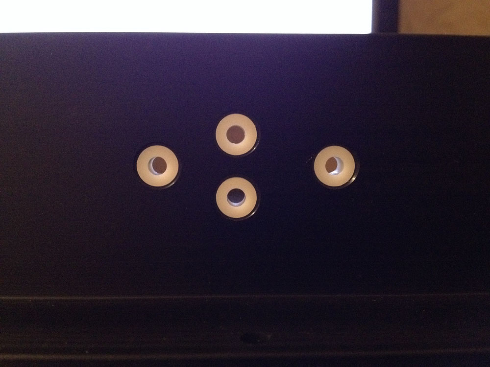

I bought nylon spacers from AliExpress, will check how they fit soon.
They are 5mm length, 7mm outside diameter, 3mm inside diameter for V-FET pins and 4mm inside diameter for bolts.
Now that I think about it maybe I should have bought plastic spacers.
Nylon is not the best material for hot environment.
I received my AliExpress nylon spacers.
5*7*3mm fits perfect and.. 5*7*4mm do not fit.
Actualy it's outside diameter is bigger, about 7.1-7.2mm and T-bracket predrilled V-FET holes are exact 7mm.
Although I want to use M4 mounting bolts for V-FET's those spacers are still good for M3 bolts.
