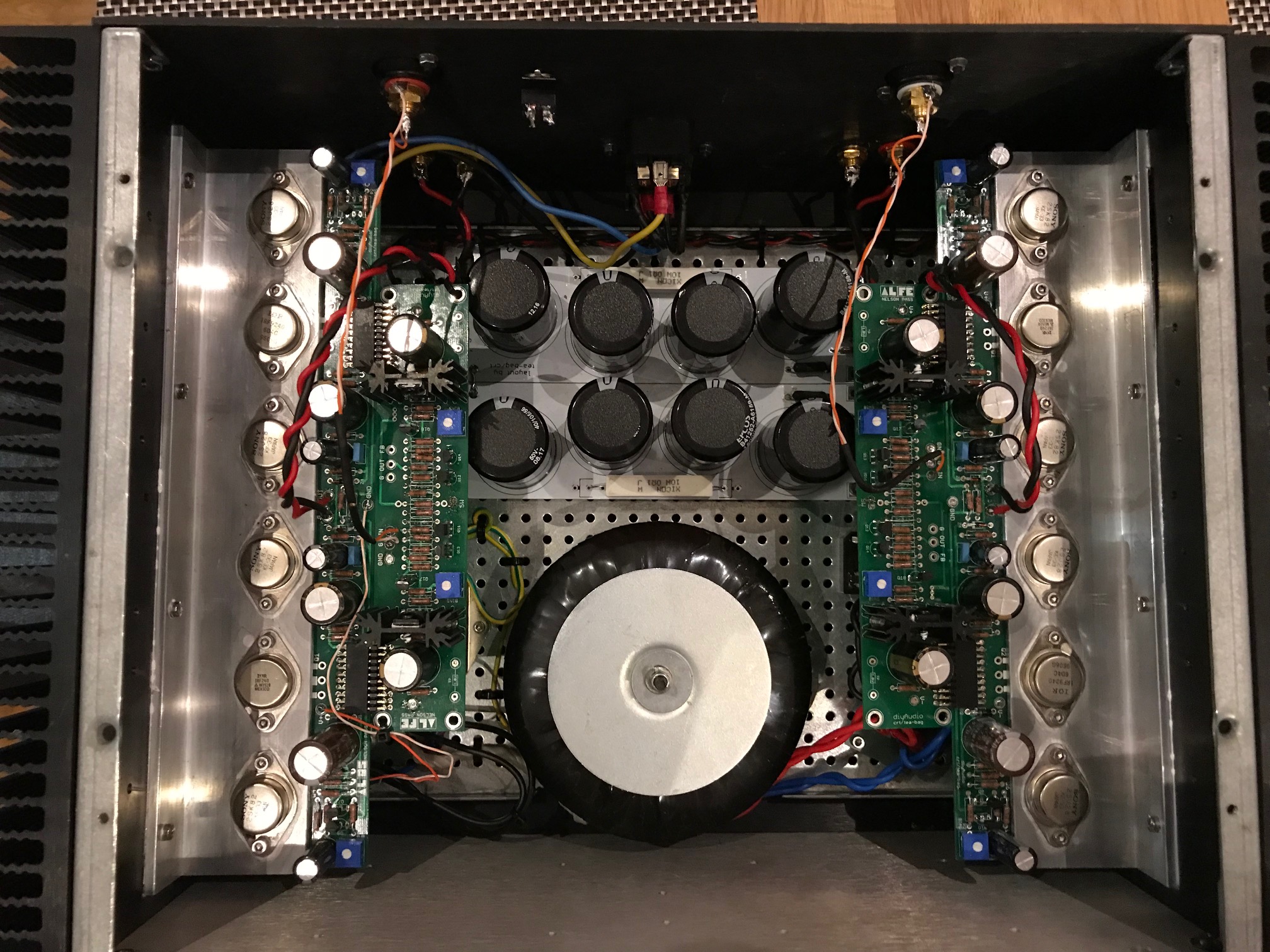

Wiring my monoblocks currently. I did successful resistor checks on the boards.
I will be mounting the boards on the heat sink with everything but the VFets, and continue the testing.
I am undecided as to whether I want to use a bench supply for testing, or the PSU I’m building for the amp. I want to be able to test the rather standard PSU before getting it hooked to the boards. With my previous amp I just hooked everything up, and biased the amp.
How would I test the PSU before hooking it up? I have some high wattage 8 ohm resistors as speaker substitutes, but I’m not sure of the actual amp impedance, or loading characteristics.
During the tests described in the article, are either the input or outputs shorted, or all open?
My mono lock amps PSUs involve 300VA toroids monolithic diode bridges (attached to the empty heat sinks on the case) and a CRC board with the standard values.
Am I just being too chicken? Just finish wiring and fire it up? (Sans VFET at first)
Joined 2004
Don't short the outputs. You may short the inputs, but you don't have to.
8 Ohm with 28V across them will dissipate just shy of 100W, so...
You could use a light bulb as a load if you really want to test the PSU. Otherwise I'd just confirm that the PSU puts out an unloaded voltage fairly close to the nominal design voltage and confirm principal operation of the frontend circuit with the bench supply. After that, do the rest (frontend bias, output stage bias) with the actual PSU or the settings will be meaningless.
When I build mine, I used to test the PSU with 8ohm 50W resistors, but didn't quite get the voltage drop as is the case with the finished amp. I have dual PSU, like you are planning and got an additional +/- 2V drop. As for your second question, when testing voltages, as per test sheet, before installing the VFET's, nothing is shorted.

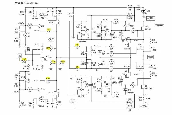

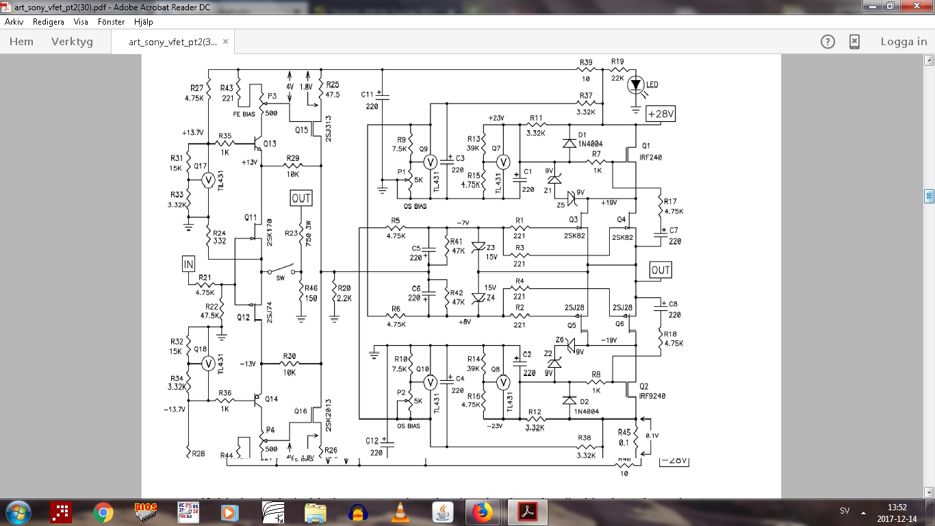

Hi!
I up and running my vfet, it sounds very good.
But i missing gain it's huge different between my F5.
My build its based on Vfet r2 (teabag), the yellow is the diff, from the original.
I have the bias about 1,5 amp 54 celsius. The frontend is 1,8v.
The SW (feedback) is open, everything seems to be ok,
The problem is it decrease gain in the frontend.
If you look at the picture from my oscilloscope.
The yellow is the input signal, 5,76 vrms, from the frontend (r20) 3,67 vrms.
What can the problem be?
hope someone can help me with this matter. :)

I'm using the Toshiba parts 2sj313and 2sk313 .
I shall tried with the switch closed, maybe i must readjust the bias voltage to get the 1.8 volts across R25 and R26.
I got a two ways switch on the backside but did not check the voltage, maybe that is the
problem. I adjusted the 1.8 volts across R25 and R26 with open switch then i used the two ways switch to test the closed mode.
Thank's
My gain is not 16 db 1v in and 6,3v out.
I can see another value on the R23 in the Japanese Diy MJ Magazine,
R23 (2,2k) in my build is it 4,75k. First i'm going to try with the switch closed (Botte) readjust the bias and the 1.8 volts across R25 and R26.
