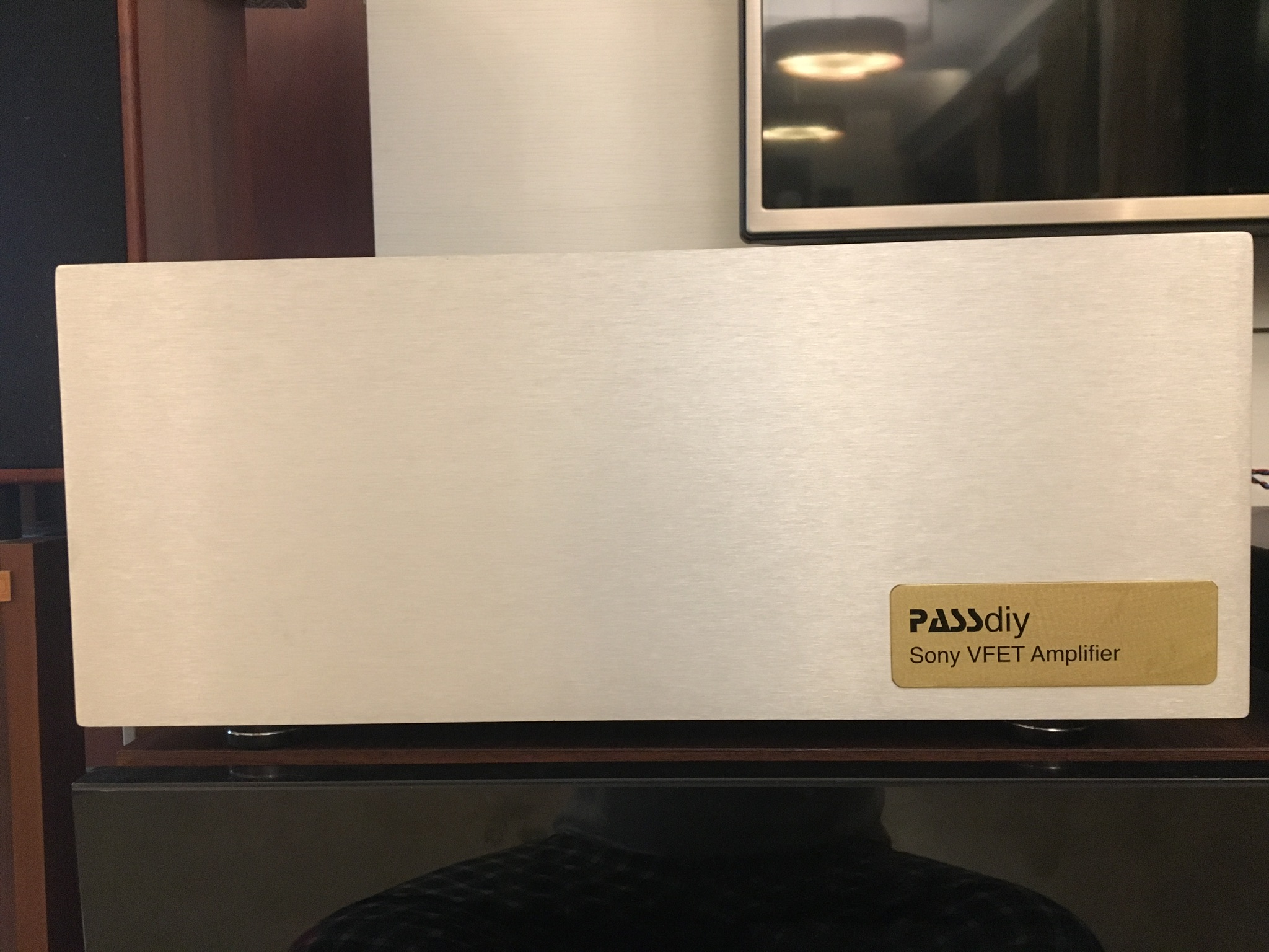

That is a nicely laid out amp
Thanks. The layout was driven by the size of the transformer. It is flatter and wider than the Antek/RKD equivalents. With that on the base plate, there was no space for the power supply boards - so, I mounted them on the front plates, which made assembly a pain! In the end, it worked out very well, as the 'flat' transformer was a nice distance from the signal boards and I could limit the power lines and the power supply components to the center of the chassis. The signal lines and power lines are nicely isolated. I have to say that it is a very nice transformer, though shipping to Asia was exorbitant......
