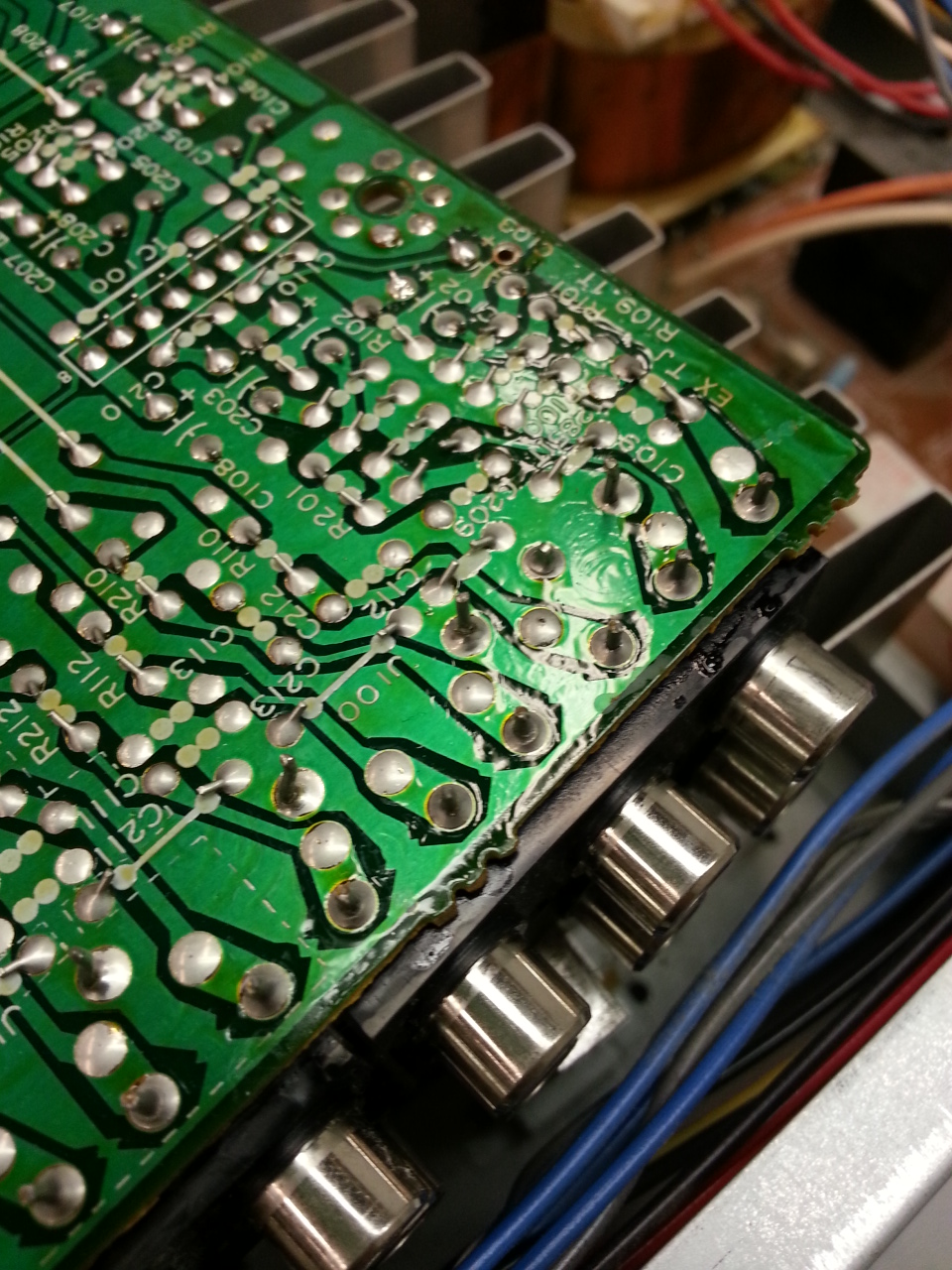

Audio cutting out
Sorry to dig up an old thread, but I figured since I have an ax380 that is cutting out in one channel, I might ask for help here.
I have tried swapping speakers and channels (A, B) but the problem persists. The amp can operate perfectly (and sound great), but after some time the Right channel will start cutting out. I can't tell if this is due to a problem with the input barrel jacks or something in the amplifier stage.
When the audio is completely cut out of the right channel you can still hear it with headphones plugged into the amp, but curiously, sometimes if I wiggle the input connectors it will crackle back in(not always). I've tried blasting the input jacks with electrical contact cleaner and scrubbing, but it doesn't seem to have helped, so I'm inclined to rule out corrosion of these components (they look clean to me.)
What is the next step for troubleshooting this problem?

Anything that responds to "wiggling" points to a poor connection or dry soldered joint somewhere.
If the right channel is correct on h/phones then you need to be looking at the area around the h/phone and speaker switching. Does the fault correct itself if you tap and "bend" the PCB with an insulated object.
Anything that responds to physical input is usually just a poor connection somewhere.
Another thought... speaker relays can be notoriously troublesome with tarnished contacts. A big clue here is that the problem can "correct" itself when the volume is increased.

Both channels affected suggests a common cause. Does the volume setting affect the noise ?
I would look over the entire for board for drys, and sometimes its worth just reflowing the whole PCB which should only take 15 minutes or so to eliminate doubt.
Both channels though has to be something common to both (and I would include the relay in that as its quite possible both sets of contacts are in the same state)
Well I had to set this project down for a few months but I've reflowed the main board and the problem persists. Spinning volume up/down may result in the sound coming back into the channel(s) or it may not. Even when it does, the sound can cut out of the channel(s) after a few seconds, so I think this doesn't affect the problem.
The sound cutting out seems to be after the amp has warmed up a bit, making me think aging capacitors. Any suggestions for troubleshooting, or am I overlooking something?

It doesn't sound like a faulty cap tbh.
Does the sound go off from both channels (and return) at exactly the same instant. If so then it points to the speaker relay cutting out, maybe because of a simple problem with the relay/relay drive/relay supply or maybe because its doing its job and a DC fault is causing an offset voltage.
Its worth monitoring and measuring the DC offset (before the relay) and seeing if there is a DC problem occurring when it cut outs.
