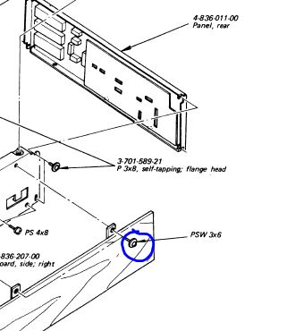

Does anyone know what is required to get the back panel on this amplifier to swivel down? Let me explain further. I have the top panel removed and there are two screws at the top and back that if removed I think will allow the swivel down to occur. But they have built-in washers that I cannot remove due to the side wood panels obstructing them. The side wood panels are each held on by two screws but these are very difficult to get to without removing other parts. This has been a weakness of me as part-time DIYer - getting this stuff apart. Any help is appreciated. Thanks, Don

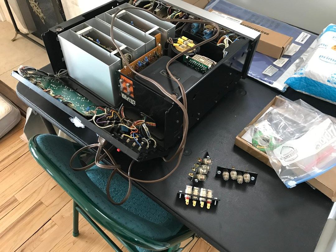

Side wood panels removed and back panel swiveled down after removing two phillips head screws from each back panel side and three phillips head screws from the underside of the back panel that attach the back panel to the chassis. Ready for replacement of speaker terminal strips and other work. I fabricated the terminal strips from scratch using 1/16" thick acrylic board and binding posts from Amazon.
