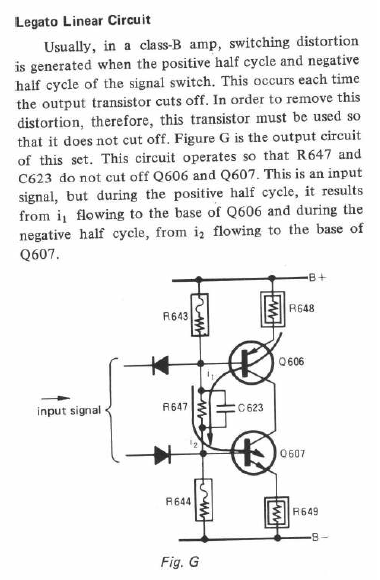

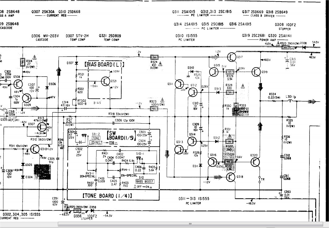

A lot of marketing "snake-oil" and "fluff".
Most , if not all - of the DIY amp projects on this forum would far
exceed that sony in both speed and SQ.
(below) , the sony does appear to be using some type of class "AB2"
output stage.
And a bit faster 2sc2681 output at 80mhz Ft .
But , that's it - no "magic" here !

Nothing special - however if you want to see the prototype of sorts for this amp, it's the sony TA=F555ES (NOT the Mk2 version). THis is the first Sony ES series integrated. THe surprising thing you might find there are Sanken LAPT transistors in the oiutput without ANY emitter resistors whatsoever. The trick is that it uses the internal array resistors. This reduces the Re to an absolute minimum and increases the size of the class A operation area. i.e. extends the crossover region to it's maximum. The trick of course is thermal stabilization but this amp handles it very well by also having thermal feedback from the drivers. The sown side is that only a single pair of transistors can be used. It is also possible to further refine the concept by using a single external emitter resistor to balance the effective value of the internal Re of the PNP and NPN part, unfortunately the value of such resistor might be impractically low.
