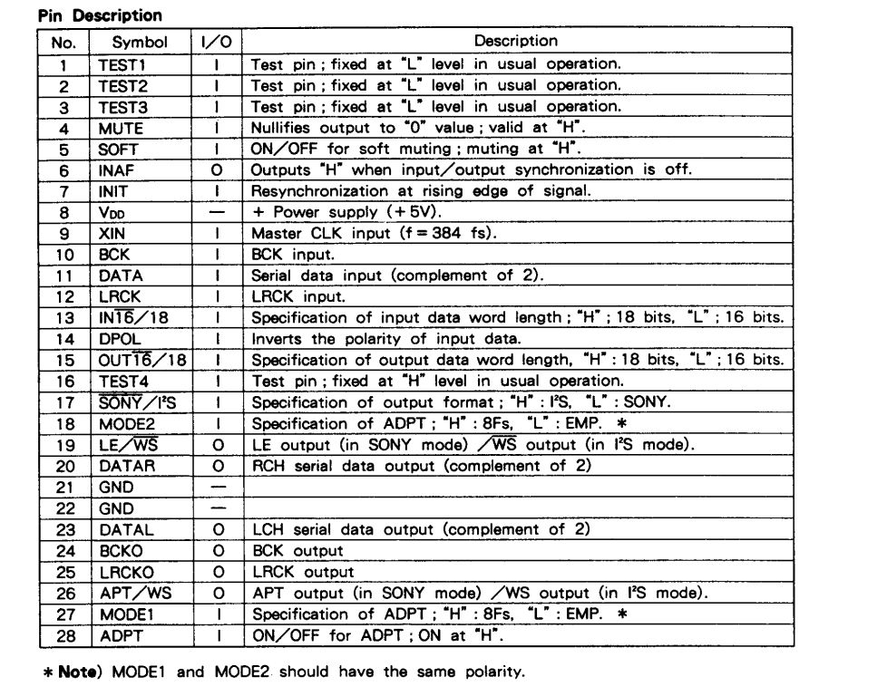

Looking more closely at the 507ESD schematic.
The WS pins are marked LE/WS and APT/WS. Not very revealing, but certainly seems to indicate that one is not the inverse of the other.
The other thing that I'd not noticed before is that, while each dac chip's AOL pins are summed to feed left out, and each chip's AOR pins are directly summed to go to right out circuit, i.e., each 1541 feeding it's r ch to r ch, left ch to left ch, as I'd said before, the CXD1144 data L is fed to only one dac, and the data R is fed only to the other. That is a brain teaser.
Also, the dac chips, which are labeled TDA1541-R1 in the physical reality, are designated TDA1541-R5 on the diagram, which suggests to me that the chips are custom matched.
Darned interesting setup, which I would not have paid attention to until it came time to mod my 507, had the OP not brought it up.
LE and APT are Sony, non-I2S options. The chip is set to I2S. One of your WS should be not-WS, like this

So if Sony used stagger to mitigate the attenuation problem, that might mean that the CXD1144 has features specifically designed to support that mode of operation, including the two outputs to the DACs WS pins.
When I've finished dinner, I'll get the 'scope out. Dual trace but not dual beam. What's the best way of investigating the relationship between the two WS signals?
