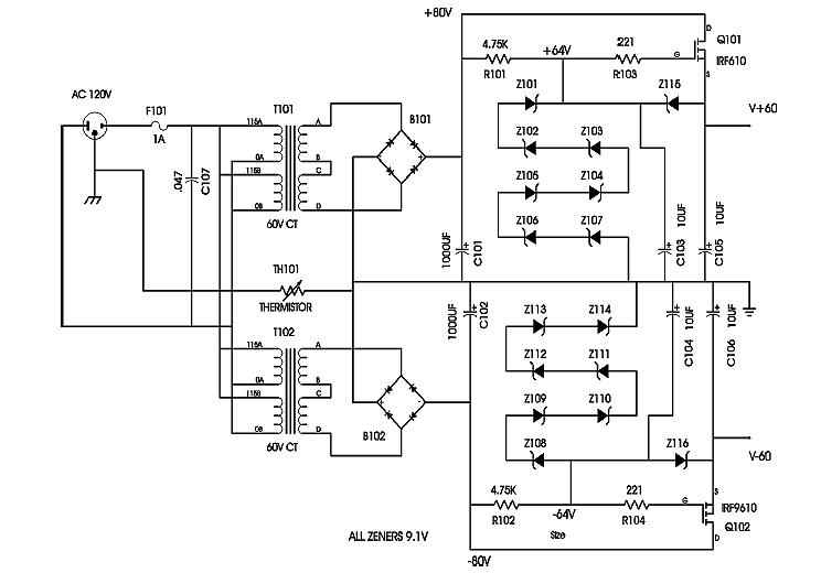

BOSOZ power supply
a.k.a. Balanzed Son of Zen...
schematic from Pass DIY document shown below.
obviously the transformer secondary, MOSFET gate voltages, etc. will be adjusted for this application. the resistors before the zeners on the gate will need to be reduced as well. bridge rectifier can be formed from HEXFRED or similar soft-recovery diodes. output of the regulator should be bypassed with something bigger, maybe 1000uF or so.
i've gotten good results with LM329 6.9V precision references, which have lower noise than generic zeners. each LM329 should be bypassed by a .1uF ceramic to resist oscillation (thanks Harry/Fred). i also use a small film cap in addition to the 10uF 'lytic to bypass the zener stack, but i don't know how good an idea this is. using two LM329's will yield 13.8V at the gate, but with a Vgs of 3 or 4 volts, the output voltage will probably be hanging around 10V... on the low side, i think 12V would probably be more ideal, but tolerable. if you absolutely must have +/-12V or greater, you can substitute different references that yield a higher value. be careful if you're using AD8260 tho, as it will only take +/-13V. for the 10V supply i suggest, a 32VCT transformer (16-0-16) should work ok.
