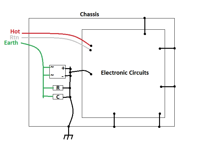

4) DIY Approach based on the article by following article Elliott Sound Products article Earthing Your Hi-Fi – Tricks and Techniques which was linked from the Tomi Engdahl’s ePanorama blog
The article references isolating all the connectors from the chassis (naturally), and creating a small circuit connected to the Earth wire.
the circuit has the following components in parallel:
-diode bridge (both inputs are shorted together and both outputs are shorted together)
- 10Ohm 5W Resistor
- 100nF Capasitor
Earth------\----->---Diode bridge---->----/----> GND
__________\----->---10 Ohnm ------>---/
Chassis-----\---->--- 100nF Cap ---->--/

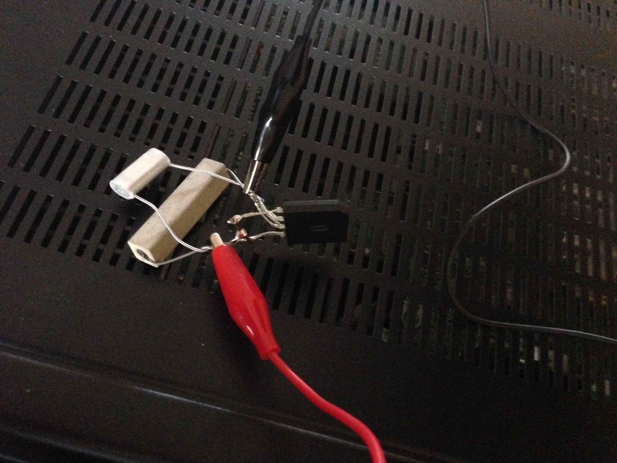

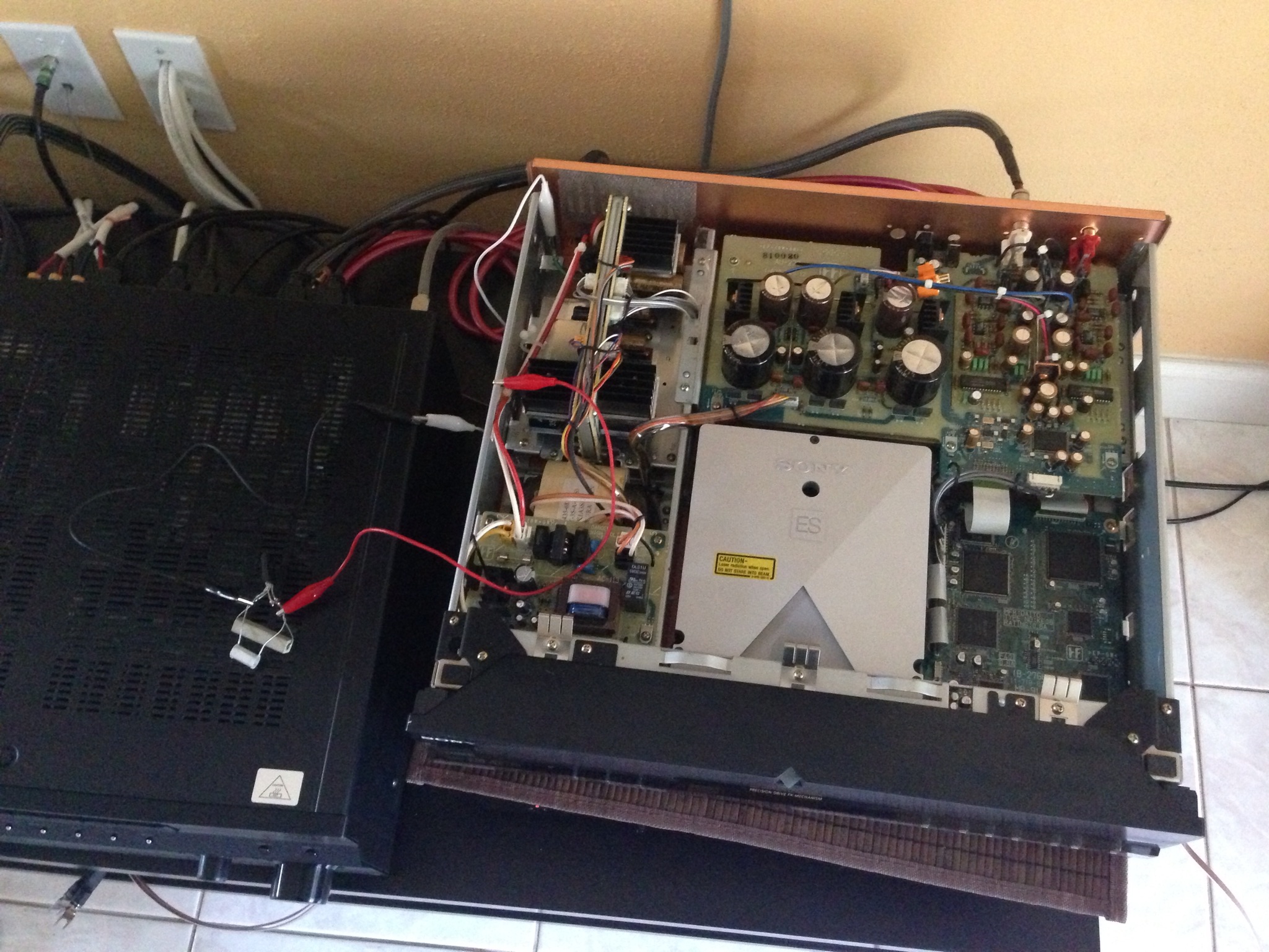

Here is the test solution
Ok, so I've made a quick and dirty Loop Breaker Circuit, and it worked! It reduced the noise significantly and it is barely noticable at 0db, but apparent at +23db.
-Circuit was based on Earthing (Grounding) Your Hi-Fi - Tricks and Techniques
The circuit is the same but with minor changes since I used what I had at the time.
components:
R=8.2Ohm (at least a 1-3W)
C= 47nF 400V Film Cap
Bridge Rectifier: 600V at 6A, P/N: G5SBA60
The Bridge Rectifier will have to be replaced with a much beefier model, and a higher watt rated resistor.
Important - the 9000 also uses a 3-wire system which plugs into a 2-wire system receiver! It basically generates loop current from Earth ground straight trough the shield of the interconnects from the 9000 to the receiver (Sony STR-DA5400ES) an back to Earth.

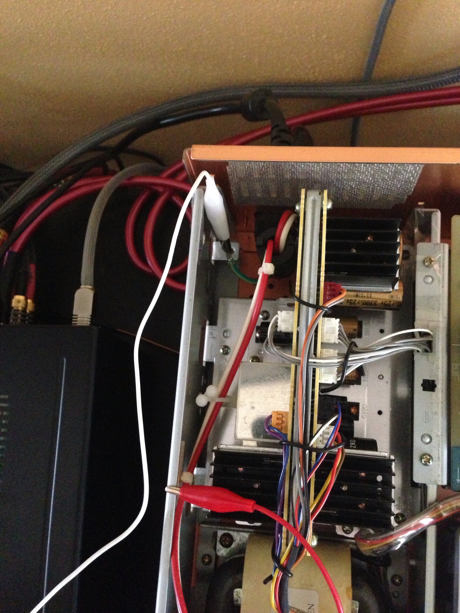

The difference in my circuit is that the Sony DVP-S9000ES' circuit boards are grounded to the chassis, tough the screws that mount them. Therefore the Chassis is not really isolated from circuitry and tying the Earth to chassis, like Elliott suggests, wont work since nothing else is isolated from the chassis and the circuits will connect straight to Earth bypassing the Loop Breaker. Therefore I had to tie the chassis to the other side of the loop breaker like in my diagram.
It is not optimal but the loop breaker basically filters out some high frequency noise via the Capacitor. Than the Resistor sinks some of that ground current and reduces the dirty voltage from the mains, therefore breaking the "loop"! The diode bridge will provide a path to Earth if there is a failure and electricity wont try to flow trough the interconnects.
I tested the resistance from the loop breaker to Earth of the outlet and it's about 8.2 Ohm (as much as the resistor).
Problem: By using the loop breaker I am not entirely confident that current will flow trough it in case of a failure and that all of that current will shoot trough the interconnect shielding and into the receiver :/. Elliot mentions that the capacitor will also let the circuit see a direct path to ground but I am not entirely understanding that. The loop still exists tho at 0db since there is very unnoticeable hum, so he might be right.
Also, grounding to Earth, BEFORE, the transformers causes this loud hum, but if I ground to Earth AFTER the transformer, the hum is gone.... is that safe, same thing as just lifting the Earth from the chassis, and the transformers isolate the electronics and large currents and voltages can go throughout the chassis, and that of course is dangerous.
Feedback anyone?:eek:

Thanks for writing about such a mundane thing. I have suddenly got this problem in my setup with a cheap Panasonic and Sony DVD player. It is giving me the the willies. I have never read of anybody else making Rod Elliott's bridge, so just some advice please.
  1. Could you explain what the WHITE alligator clip is connected to?
  2. It looks like the red clip is connected to the chassis. Is that correct?
  3. To do the modification, I presume that I need to install a new three lead AC cord and wire it according to your diagram?
  4. (I thought of running a flying earth lead to the chassis of an earthed piece of equipment, but that would still need to run through a grommet in the DVD player's chassis, which would be harder to do - and possibly less safe with mechanical abrasion of the lead on the chassis - than with standard mains parts for running a new AC cord, I think.)
  5. Should I expect the Chassis and the Electronics Earth/0V to be NOT connected to one another in a double insulated DVD player?

1. The white aligator clip is connected to EARTH wire in the plug not chassis. Look at my diagram and not the picture for what is happening in terms of wiring.
2. Yes but I would stick to the diagram because I moved the clip around and ended up clipping the ground loop breaker closer to the psu as possible. They say you should insert it near the transformer ground but I couldn't clip to any so PSU ground for me.
3. Hmm this was made for the 3 prong outlet hence the "ground" part in ground loop breaker. I reckon it would work for two prong as well but you need to be careful and maybe read up on it first. You will be isolating your player from the return and it will be somewhat floating.
4. Flying earth wire might be better. What you will have to do is attach it to the chassis but you might introduce more noise and if that happens disconnect it! Be careful!
