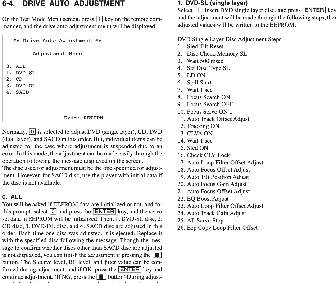

Next step is to download the service manual and read the “test and adjustment” section. There is a built-in “diagnostic menu” feature which can be used to check and adjust the servo system.
In particular there is an adjustment named “mirror time” which must be set up properly in order for the player to distinguish whether the disc is a DVD or a CD.

Do you get the expected setup in the auto setup mode and did you try the SACD setup before you replaced a probably perfectly good laser?Taken from the service manual;
You must use the specified test disc otherwise it may not work properly!

Do you have any personal experience using this Sony “auto-adjustment” procedure?
I own 1 DVP-NS999ES and several DVP-NS755V units. Note: The DVP-NS755V is a “mid-priced” DVD/SACD/CD player from the same model years as the high-end DVP-NS999ES.
To date I haven’t ever succeeded at getting this “auto-adjustment” procedure to work for either a single-layer or dual-layer DVD. It does work with a standard CD.
I suspect the auto-adjustment for DVD requires special Sony test discs. I haven’t ever been able to obtain these special DVD test discs. Sony refers to them as the HLX-501 through HLX-507. There are separate part numbers for DVD single-layer, DVD dual-layer, and also NTSC vs. PAL video formats. One of my Sony service manuals also shows a test disc for SACD, the HLXA-509.
I have been successful getting all of my disc players to work by performing one specific adjustment known as “mirror time” or “disc check memory.” This adjustment doesn’t require any special discs. It does require one each of a single-layer DVD, a dual-layer DVD, and a CD. Otherwise I leave the servo parameters at their existing values. By doing this “mirror time” adjustment I have been able to move optical pickups from one player to another and end up with everything functioning well.

To clarify one thing I learned about Sony DVD players:
The adjustment process, whether automatic or manual, must be performed in the following order:
1) Put a “known to be good” single-layer DVD into the player. Check “mirror time” for single-layer DVD (service menu shorthand is “DVD SL”) and adjust if needed. Check that this single-layer DVD is able to be played after adjusting.
2) Put a “known to be good” standard CD disc into the player. Check and adjust “mirror time” for CD.
3) Optional: Some Sony models also have a “mirror time” item for dual-layer DVD. If so, put a known-to-be-good dual layer DVD into the player and check/adjust mirror time (aka “disc check memory”) for “DVD DL.”
Note that if you wish to use any of the “automatic adjustment” procedures, then they should be performed “one disc at a time” by first adjusting for single-layer DVD (aka DVD SL), then for standard CD, and finally for dual-layer DVD (DVD DL).

I took a close look at the DVP-S9000ES service manual. Some details of its "Test Mode" (section 6) differ in comparison to the later DVP-NS series. That said, many items are still quite similar.
In particular, the single most important adjustment is "Disc Check Memory."
The details for adjusting it are given on page 6-8 of the service manual. This procedure adjusts the stored EEPROM data for a parameter known as "mirror time."

So, here is the detailed procedure:
You must have 3 "known-to-be-good" discs in order to perform this step:
1) Single-layer DVD
2) Standard CD
3) Dual-layer DVD​
Get into the "test mode" and select "2. Drive Manual Operation."
Next select "0. Disc Check Memory."
Now put a single-layer DVD into the tray. (The open/close button remains functional at this time).
Then select "0. Reset SLED TILT" followed by "1. SL Disc Check."
At this time a 2-digit hex number may appear on the screen. This is the measured mirror time for the DVD-SL disc.
Then eject the disc and put in a standard audio CD
Again select "0. Reset SLED TILT" followed by "2. CD Disc Check."
Again a 2-digit hex number should appear on the screen and be about 2x the value of the DVD-SL value
Eject the CD and put in a dual-layer DVD.
Again select "0. Reset SLED TILT" followed by "3. DL Disc Check."
The 2-digit hex number should be roughly similar to the number for the single-layer DVD.
That's it. Switch off the player and turn it back on in normal operation mode.

To conclude, it would be helpful if you could look at these screens and either write down and post the data, or (this is how I do it), photograph each screen with your smartphone. Then post the photos.
