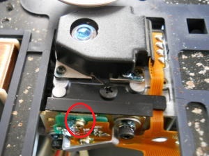

Sony CDP-552 esd not reading discs- no rf pattern?
I would like to ask for some help diagnosing a fault on my Sony CDP-552esd which unfortunately spins the discs and opens up the drawer. No TOC anymore. I had a look at the SM and followed the troubleshooting section flowchart and i got to the point where I am directed to check for the eye pattern rf signal on my scope.
I connected my scope to the rf test point and just switched on the cd player to monitor the pattern but I do not get any output it seems. I do see a faint-ish red laser beam however only viewed through a dentist type of mirror as it's otherwise hard to detect.
Am I right in thinking that I should be able to see the rf pattern without a disc being played but by just turning on the cd player?
How can I tweak the settings on the rf board to try and adjust the output as it is not indicated on how to do this on the SM. The only adjustments are focus and gain at different test points on the servo board.
Does it sound like the laser unit is busted or is there some hope? On the rf board there are 3 trimpots but i don't want to guess and try my luck without advice.

DON‘T EVER RAISE LASER POWER.
Try this solution:

I shall try again but i did try with the disc spinning and it was not much different if any compared to without the disc. I connected the probe to the rf test point as advised on the SM and the ground cable to the chassis. To see some movement on the scope i had to turn the volts/div to the minimum level but there was nothing similar to what i was expecting.
The disc spins yes and then after few seconds it gets ejected. There is no TOC or anything. Any further clues please?

I have not touched any settings on the laser unit..i just checked the focus and tracking settings on my scope which seem fine as illustrated on the SM.

IC001, pin8 +5V, pin 4 -5V
IC001, pin5 should go above 1 volt to turn the laser ON
IC303, pin5 4MHz clock signal from the ceramic resonator... these are known to fail.
If the above is okay, move to IC101 and start checking RF signals and conditions.... RV102 -> if this trimpot has oxidised, and the wiper is not touching properly the graphite, the error correction will be skewed.
