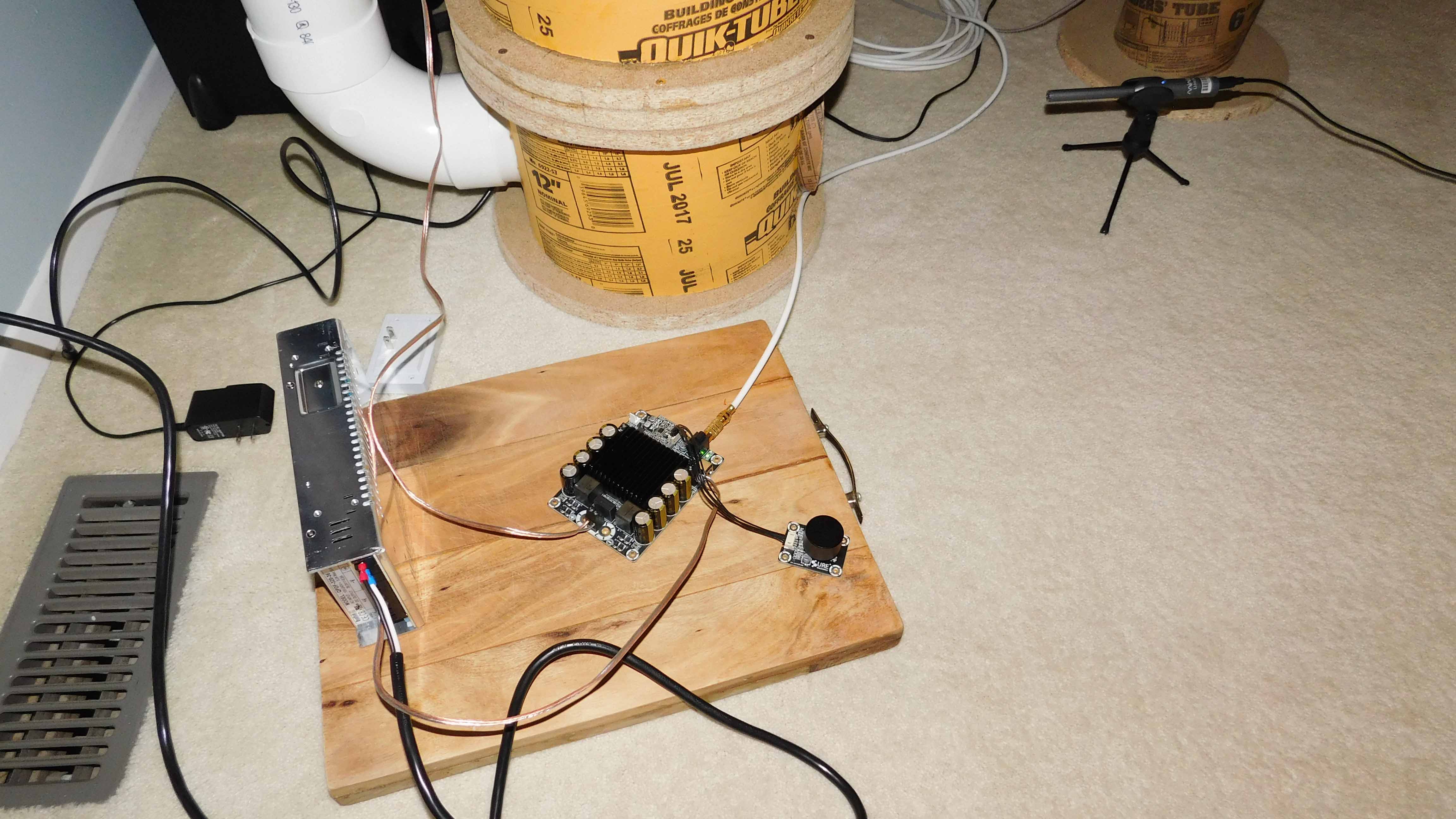

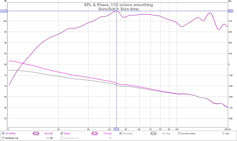

Retested using a Class D amp
I finally got my amp and p/s and these are the near field results. Sure aa-ab31282 (200W class D) and a Qualtek QPDF-320-36 (36VDC supply, 320W).
I'm very happy with the response. I typically use a sub <=100Hz so its flat enough for me. I'm surprised at how low it goes, as I was expected a sharper drop.

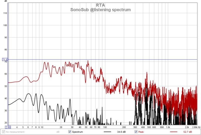

How low is required ?
That question is asked a lot. I put on a few tracks, with low freq content, and measured with REW RTA to see what's there.
The frequencies below 20Hz cannot be heard, but they can be felt. I have a mechanical stop (throat plate) than prevents woofer from extending more than 8mm. During some of those tracks, at moderate volumes, I can hear the woofer slapping the throat plate. I need to add a HP filter @20Hz to prevent these VLFs from trashing the woofer. This is also in line with the HornResp prediction of excessive Xmax for subsonics.

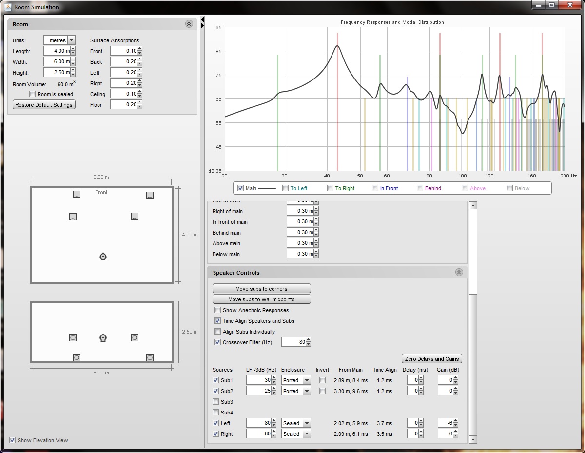

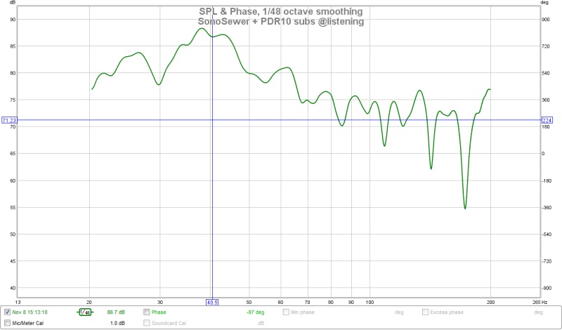

Working with multiple subs
I connected both subs to see if I could get a flattish LF response in the listening position. Initial placement and prediction using REW.
The first two graphs are the prediction and the measurement. I use Omnidirectional speakers and I have the LF at +6dB so the higher frequencies are more smoothed than predicted and the LF is raised. I also prefer a "bump" that can be EQ'd down over a "null" that can never be EQ'd out. The graphs have 1/48 octave smoothing to emphasis peaks and dips.
The third graph is an average (12 sample) over the listening area couch. Measurements can change alot if you move the mic and I don't always sit in the spot marked "x".

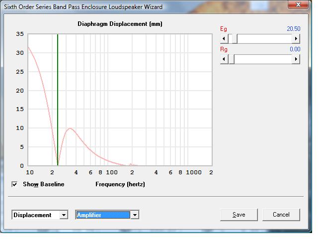

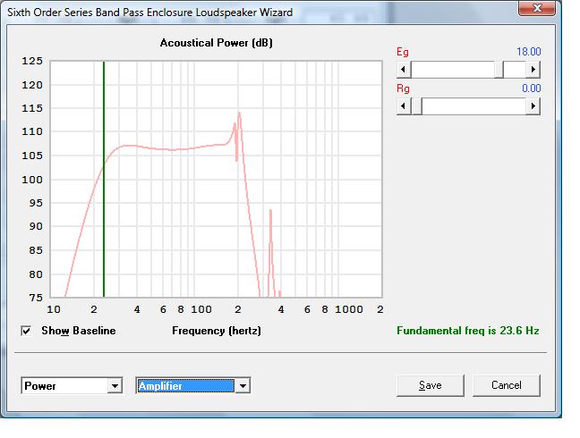

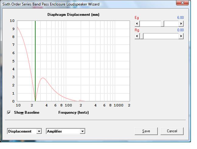

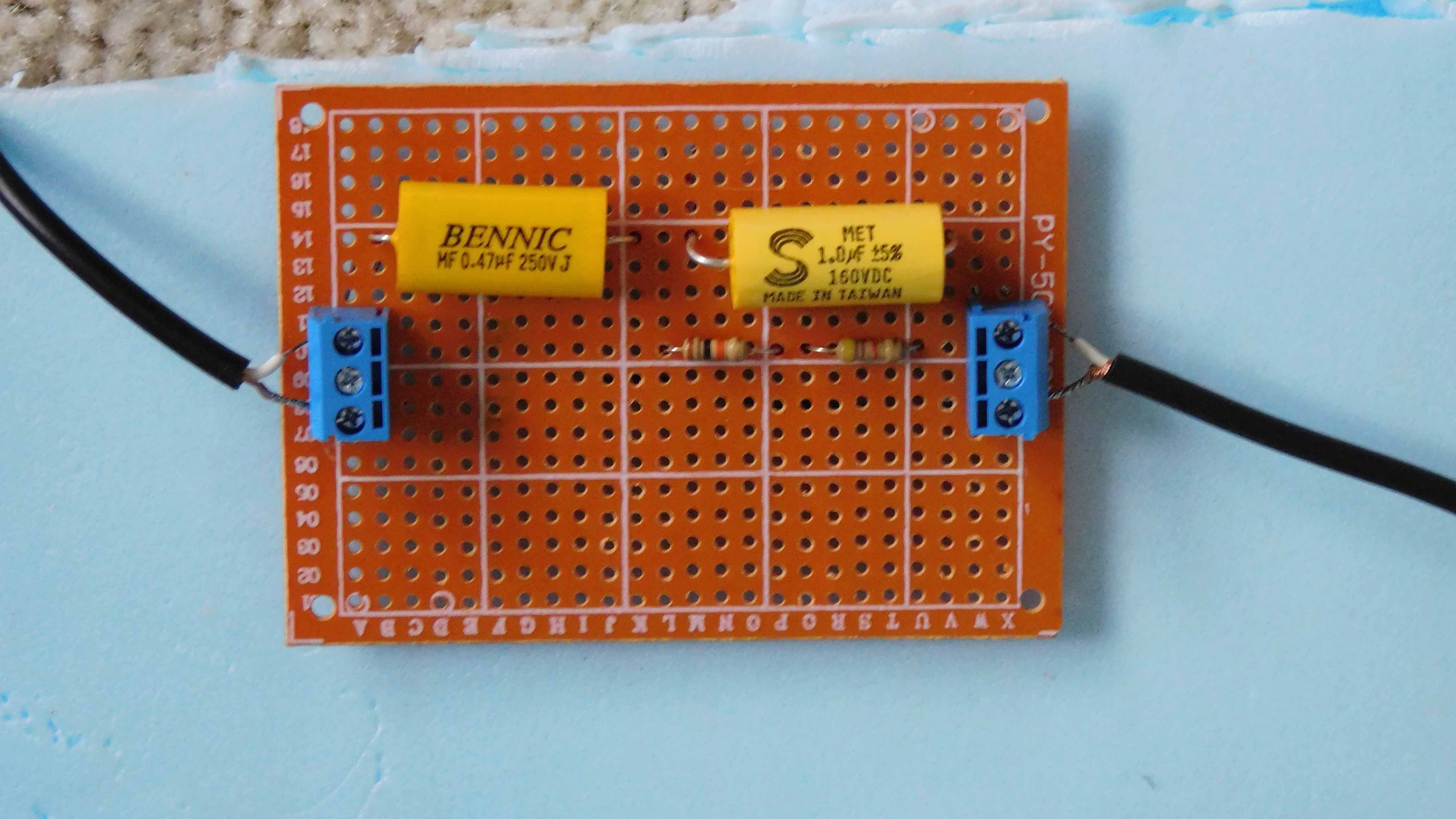

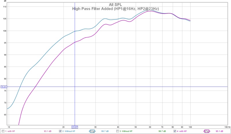

HP filter added
At VLF the woofer excursions are excessive and possibly damaging and of limited value acoustically. So I added a highpass (HP) to the input of the amplifier.
The HP filter below (pic#1) has one filter at 16Hz, and a second filter at 23Hz. Its just a couple of cascaded RC's (2 poles or 2nd order). Together they create a gentle rolloff with calc'd Fc=19Hz (-3dB). The 2nd pic (graph#1) compares the response with and without the filter. It behaves as expected. I have level shifted the filtered version up 1.5dB due to insertion loss in order to compare the curves.
As shown in graph#2, I can apply approx 100W before exceeding Xmax at 35Hz . This is from HornResp, but notice the problem for VLF displacement.
At 10Hz I have approx -15dB attn or just 18% of the VLF signal passes. Graph#3 show the max displacement, without a filter, is reached with only 9W. That is a problem. With the filter you could apply a signal equivalent to 9/0.18=50W and before reaching Xmax @10Hz. Still not perfect but its much better. More attenuation would require another filter (3rd order) and add another -6db or allow only 8% of VLF @10Hz would pass.
So far it seems like its enough. More listening is required :)

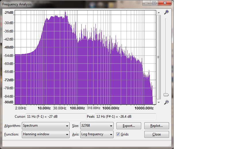

I can now play this safely..
The HP filter and woofer excursion issue was from a problem playing this file (Mannheim SteamRoller, Fresh Aire 8, Big Bang). It has a lot of VLF and was causing the sub problems in an area that's not audible. It can be felt though. Still sounds the same without the woofer thrashing about at 10Hz.

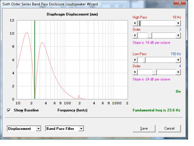

HPF changes and max power estimate
I adjusted the input filters to 2nd order @16Hz, and discovered the amp also has a HPF in the 20Hz region. Sure Electronics is not specific about it, but it gives me a 3rd order HPF.
Re-running a few numbers in HornResp and verifying the approx displacement (min/max) vs freq using REW's generator. It now appears that I can drive the system with about 80W before exceeding Xmax and touching the throat plate. At that power level I get about 106dB, which I think is enough. If its not enough power, I can add a spacer and get more X-travel at the expense of increased distortion. The 200W amp I have can actually supply 155W with this driver.

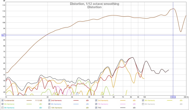

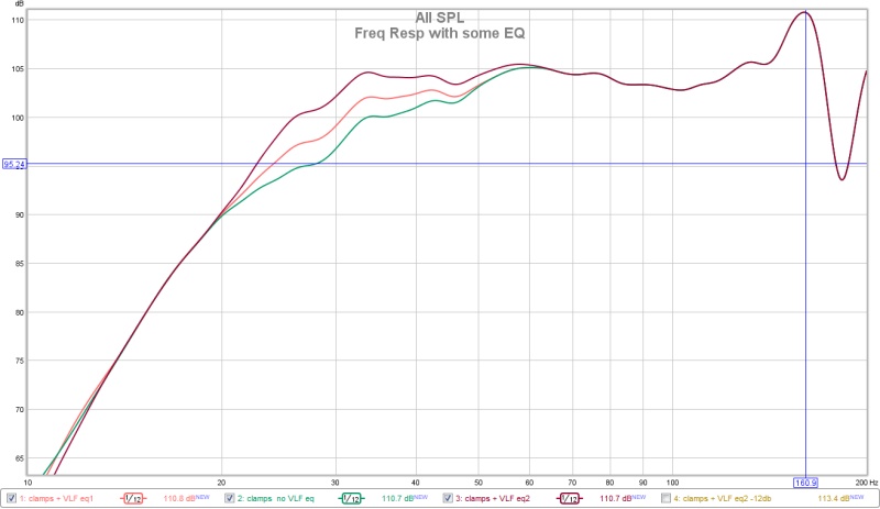

BW, EQ and distortion
I did a few more measurements with the HPF filter changes.
I also added a couple of steel band gear clamps (used 2x6" to form a 1x12") to strengthen the seal at both ends of the upper sonotube.
Graph#1 shows a few levels of EQ when I tried boosting the 30Hz knee to flatten out the FR. It looks better graphically, but it's only a near field measurement and the room response matters more. I need to do some listening to see if I prefer one curve over the other.
Graph#2 shows the distortion at -45dB up to about 45Hz, but then starts to rise to -35dB at 80Hz. I'm not sure if this is a problem or not and whats causing it. I don't seem to notice it and I typically roll off at 80-100Hz anyways.

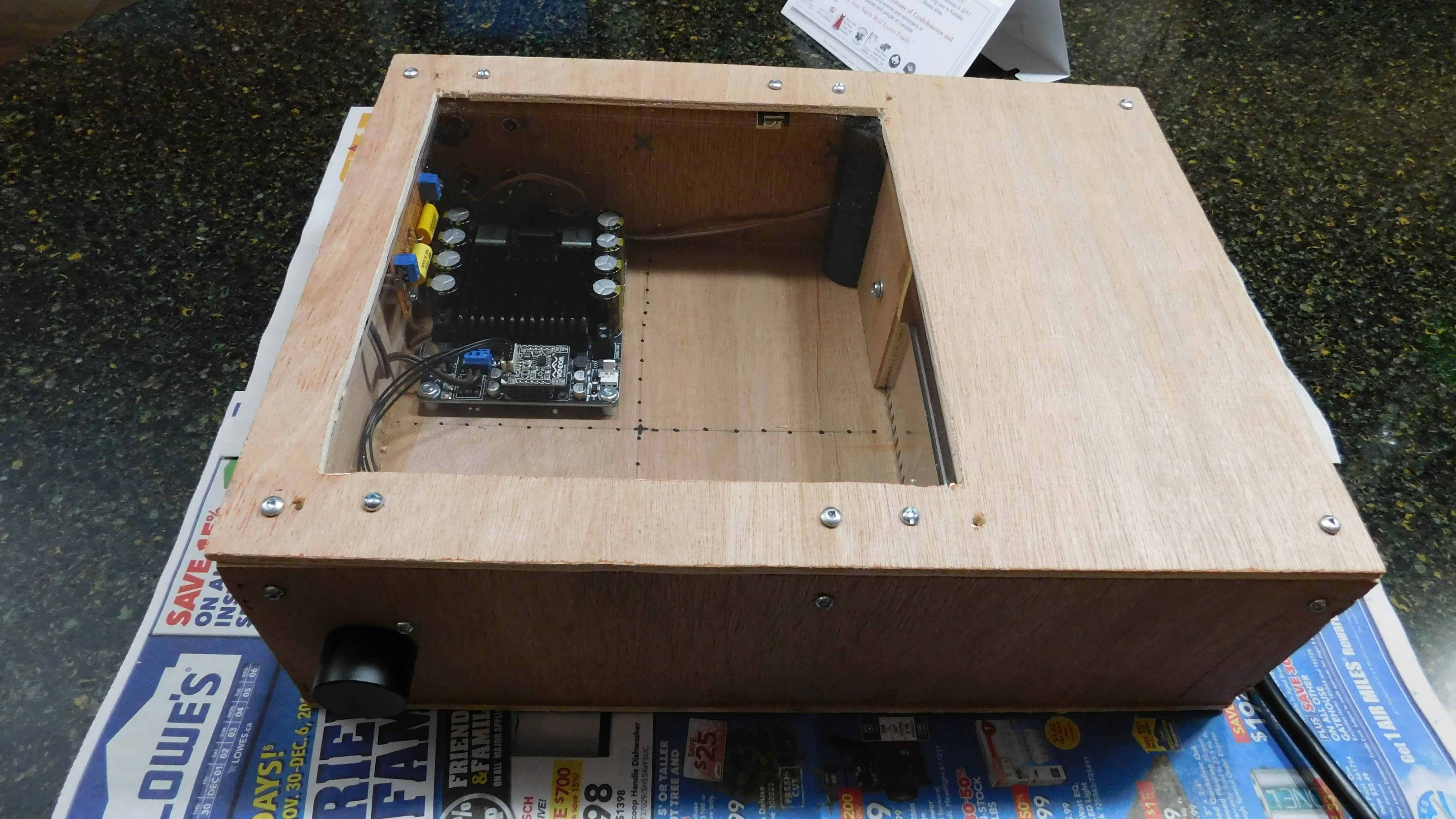

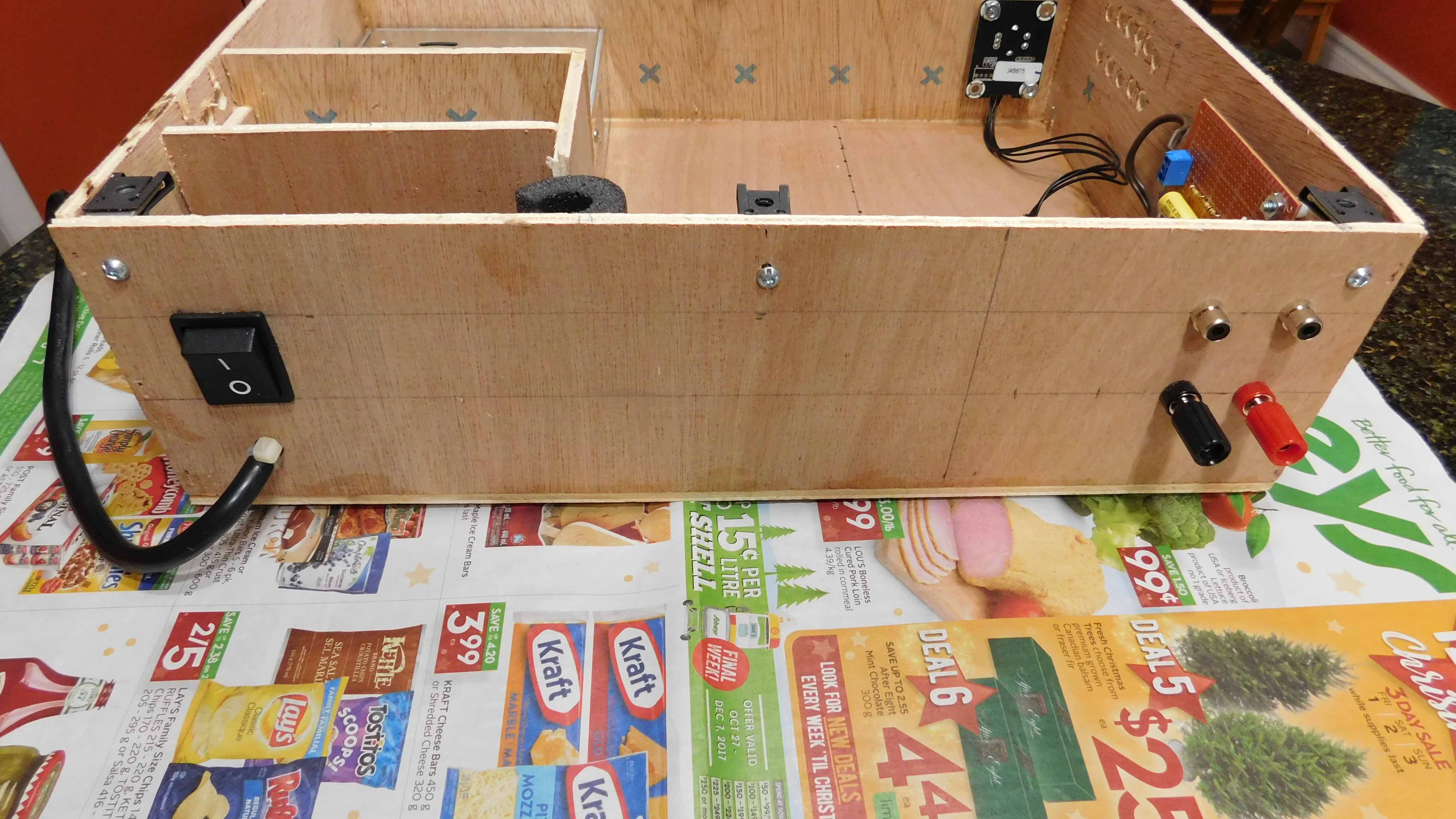

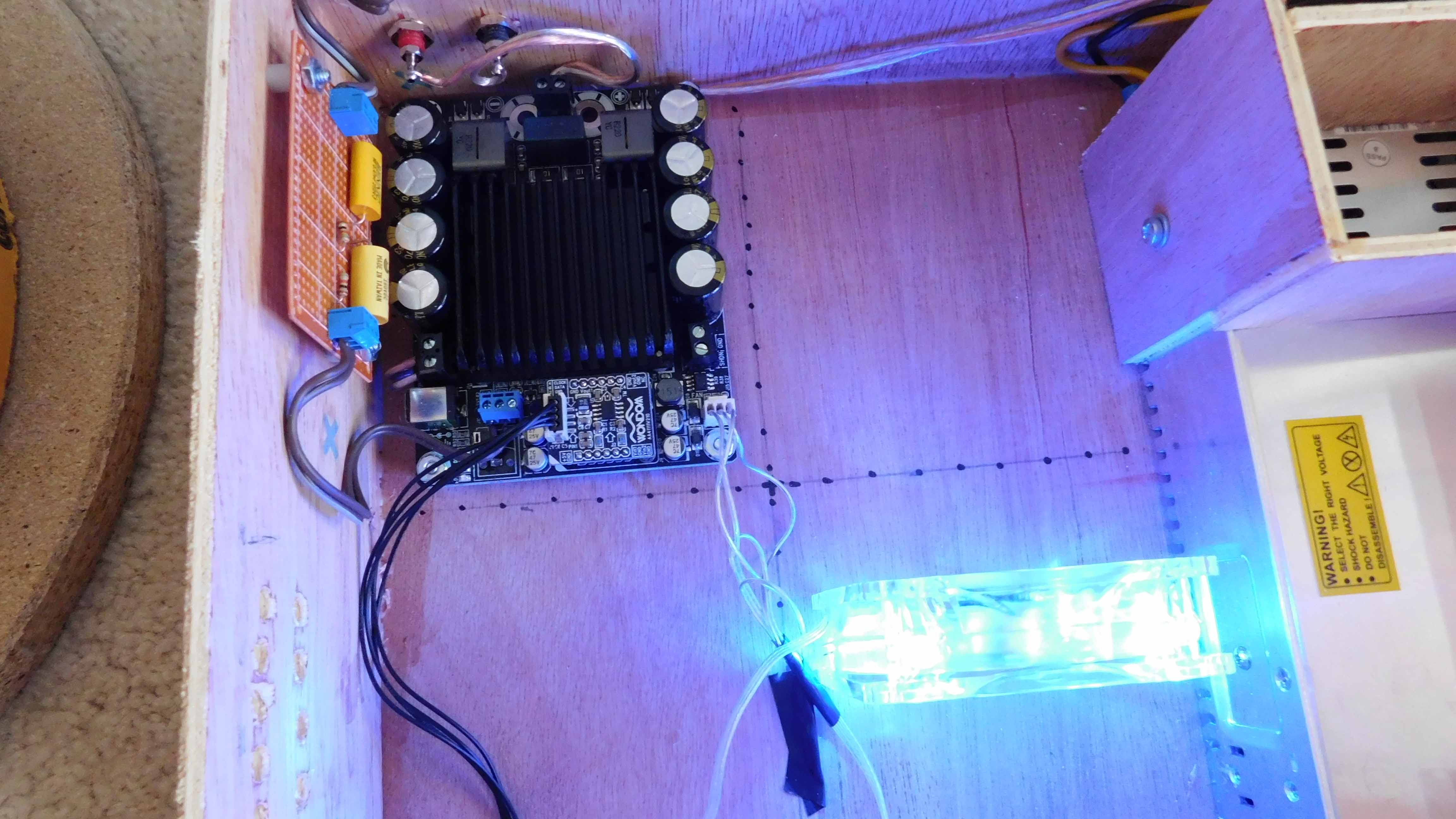

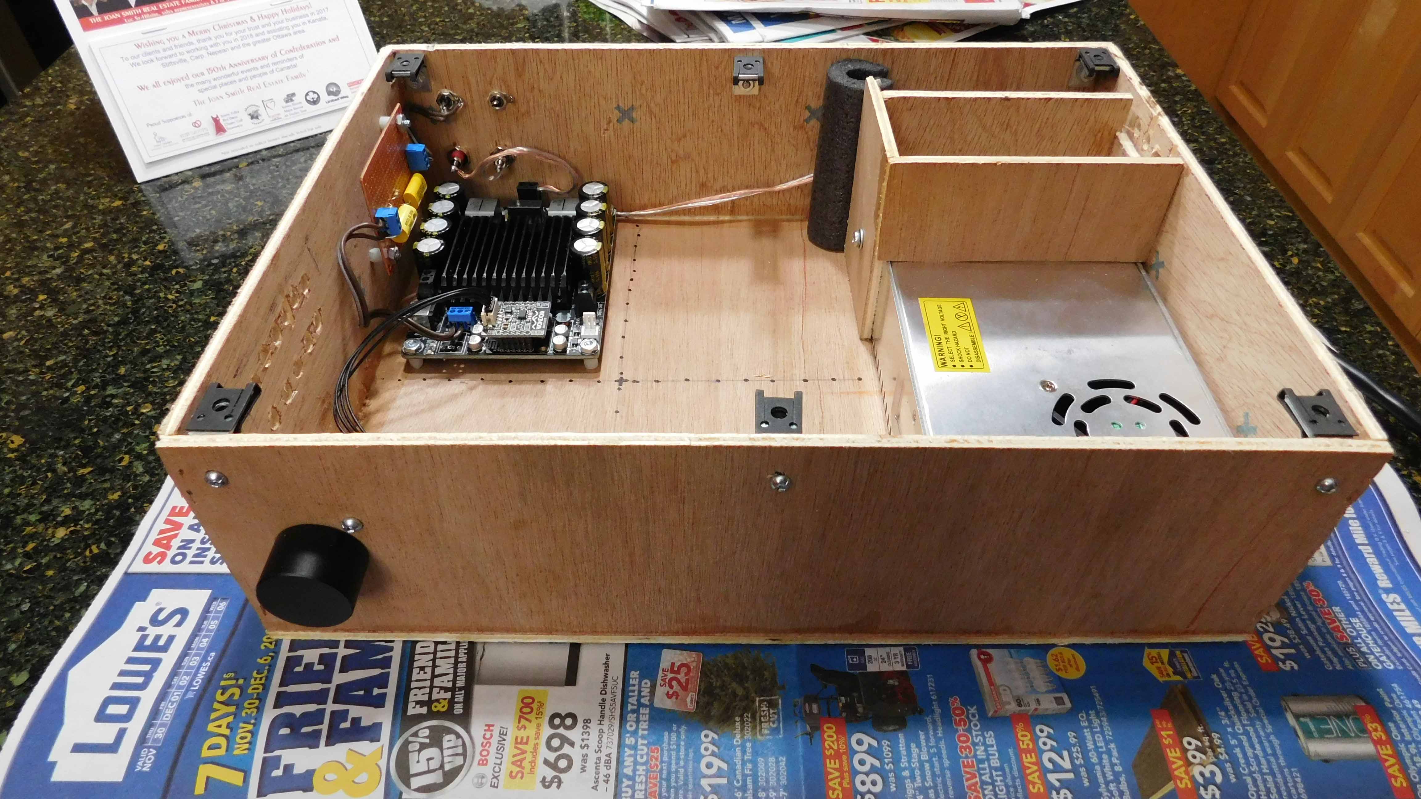

Amplifier box
I'm not using a standard plate amp, so my collection of parts needed a box.
I have some spare sureply that's light and easy to work with. This is the first class D amp I've used and I like it, so I'm willing to try more of them. The box has room for 3 more Sure Class D amp boards that will eventually be used to bi-amp my omni speakers. I'll add more RCA jacks, speaker posts, and volume controls as the other amp boards are added.
Cooling is provided by dual purposing the power supply's fan. An intake plenum on the right side and output vents on the left side. I checked with a candle and it's definitely moving air across the case as intended. The p/s fan is not as quiet as I'd like and will be replaced/modified eventually.
A plexiglass window in the lid is used view the amp status LEDs.

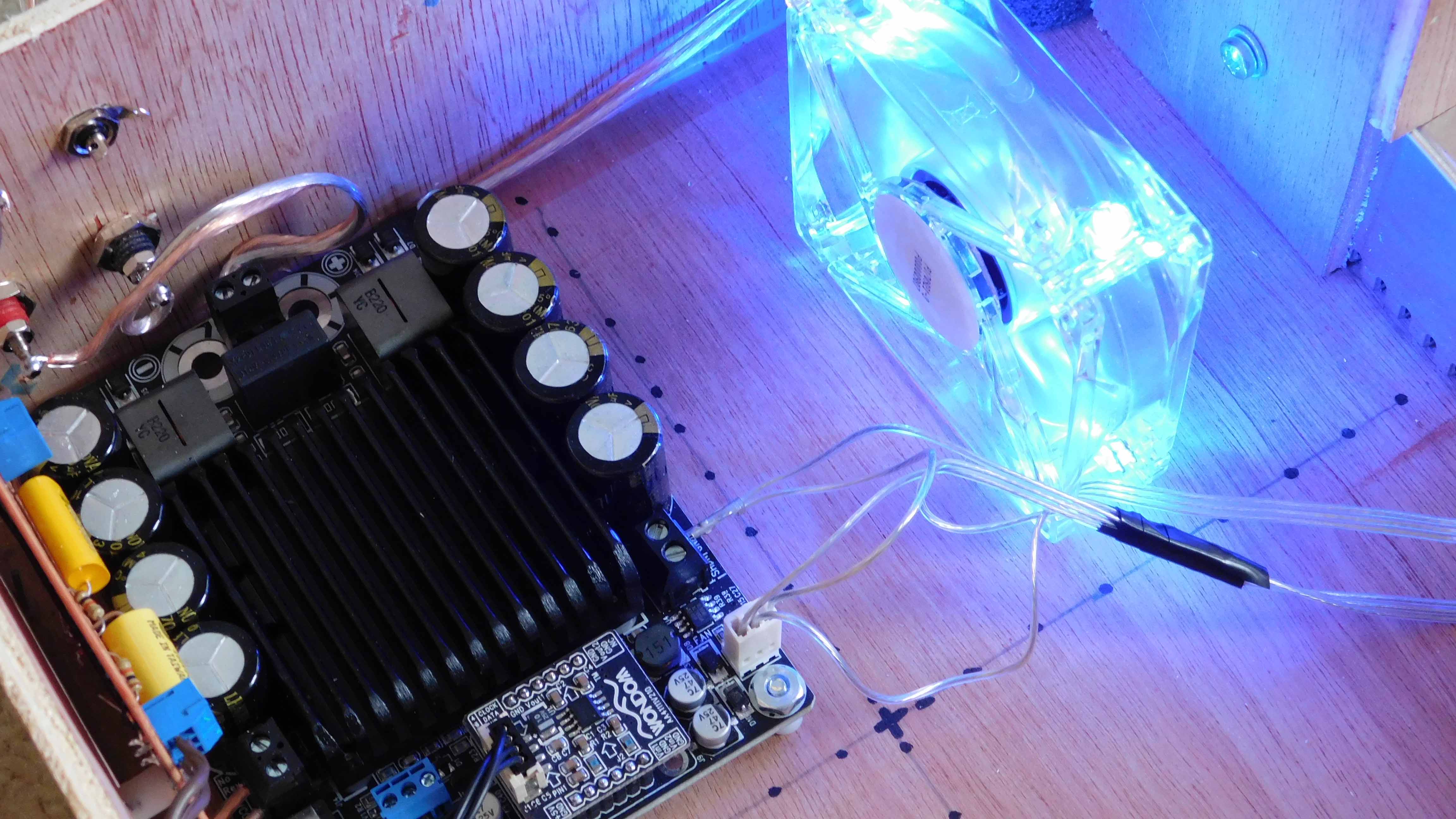

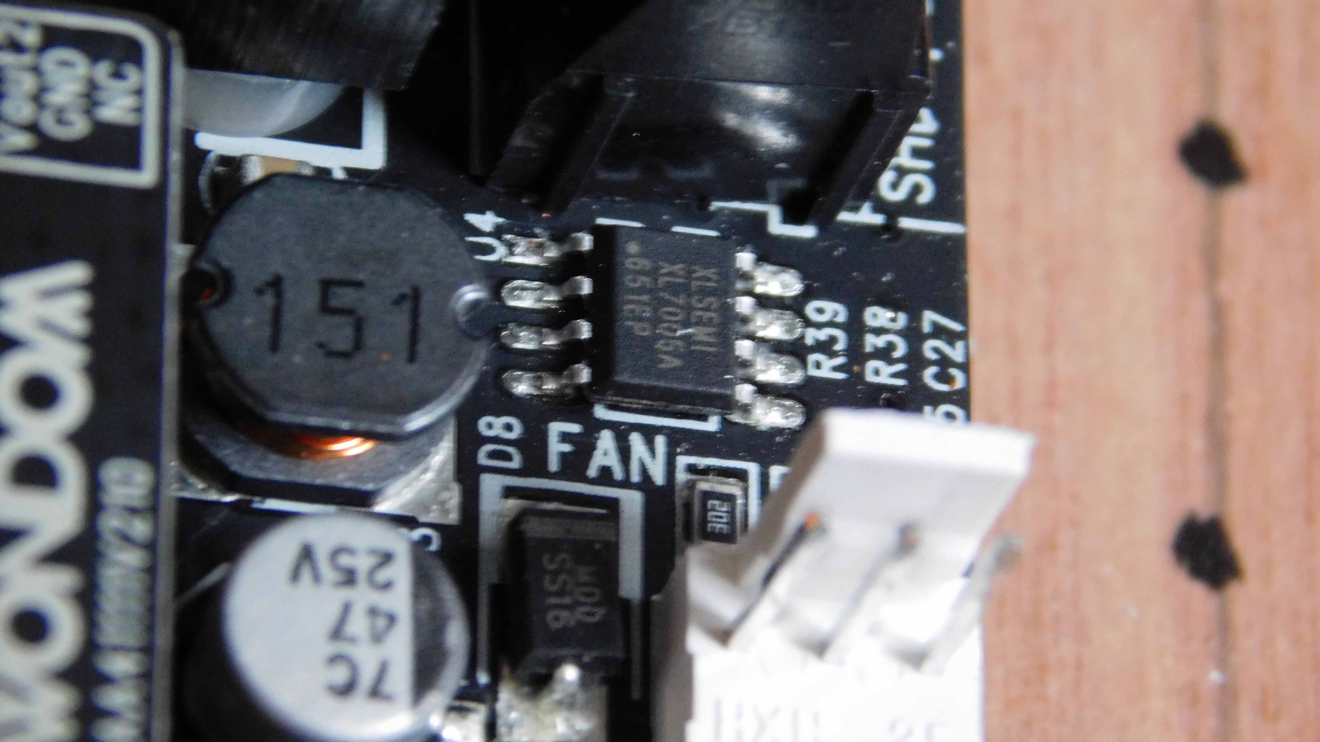

Sure AA-AB31282 where is that fan control ?
The spec for this amp says it has "optional fan control". When I try to get information from Sure, they tell me it has no fan ? When I ask on Parts Express I also get "there is no fan connector".
So I thought I post how to use optional the fan control, because I want to replace the power supply fan and possible just use a lower speed quieter case fan. The board has a connector labelled "fan". It's the standard 3 pin connector used on PCs. In the pic below the pins are (3=tach=left, 2=pwr=middle, 1=gnd=right).
The board uses an XL7005A buck converter (pic#1) to get +12VDC from the +36VDC input. The circuit is nearly right off the datasheet. There is a snubber diode across pin#1 and #2 to prevent negative back emf when the fan is shut off. The current capacity (see datasheet) depends on the input voltage however 200mA seems possible. The +12VDC is always running in case you want to use it for something else.
Option#1 : If you want to use the temperature based control, pin#1 will be connected to gnd only when Temp>=50C completing the circuit and turning the fan on. You can attach a small std 3-pin fan this way (pic#2).
Option#2 : If you want the fan continuously on, you can just connect the fan's pin#1 to gnd seperately (shown) Luckily, there is another nearby terminal block (shutdown) that has a gnd connection. In this configuration the fan continuously from the amp board (pic#3).
