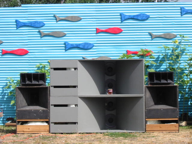

I thought he might have something like this:
Oops, that's more jacking, sorry.
