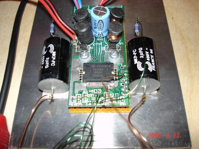

Just finished the stealth mod on one of my new t-amps. I replaced the little tank cap, and jumpered the power. My board says 2005.09.07, LG-102F REV:A0. There is no solder blob under the chip. Just a bunch of little through-holes in an array, that I think are supposed to be somewhat like a heat sink.
Wow... the input mod really fattens up the bass. I likes. I just used some polypropylene 2.2uF caps that I found at the shop. The kick drum has a lot more kick. I have 60mV offset on one channel of the modded version, and 40mV on the other. Is this bad? Could I have caused some kind of dc offset on the input? I definitely removed R01 and R02. I didn't use the soldering iron to do this, I just pried them off with pliers. Any ideas?
I haven't set up the smps yet. I'm just using a 12V 4A ac adapter that I had for my LCD monitor. But you guys were right. It's nice. With the little power brick, it's a little hissy when I stick my head up near the tweeter. Hopefully the filtering caps I put on my SMPS will help me out a bit with that noise floor. Soon, I'll have these things boxed up and ready to go.

How are you guys mounting the boards in the chassis? The only holes they used are way too big for standoffs. Some nylon standoffs? Thanks for the help.
Good to hear that your T-Amp mods were successful philibuster.
As for mounting the board, I took a piece of perf board about the same size as the T-Amp and sandwiched nylon washers between the perf board and PCB on the 2 existing holes. And added nylon washers on the top side - of course. I drilled and tapped the bottom plate of the enclosure - see pic. Works great!
-Ken
Hi Philibuster,
I drilled two holes in the chassis that correspond to the centers of the mounting holes on the board.
I then used two 1cm or 1.5cm tall nylon standoffs (wide enough to cover the holes) underneath the board. On the top, I used nylon nuts. For the screws, I used two brass screws, though I chose brass just because I had them on hand.
The screws are inserted through the holes drilled in the bottom of the chassis so that the heads of the screws end up on the outside of the chassis. The rest of the screw body goes through the chassis, standoffs, board, and then is secured with the nylon nut on top. The tension of this mounting setup holds the board parallel and suspended over the chassis bottom with no chance of it touching.
You could add a nylon washer between the nylon nut and the board, but I didn't find this necessary because the nylon nut secured right on top of the solder slug, which didn't need protection. I'm not sure how the newer boards with no slug is configured, however.

Hi Philibuster,
There are a number of things you can do to help cooling. I'm telling you now, after you've mounted the board, sorry.
The easiest is to add a stick-on heat sink on top of the chip. But th best place to draw heat out of the chip is underneath. You can add solder there thru the little holes where Sonic should have put it. The solder will contact the metal slug on the bottom of the chip and give more cooling mass. If you can mount your board upside down, then you could put a stick-on heatsink there. That would do a lot for cooling.
Another slightly tricky mod is to slip a very thin piece of copper under the chip. There is room under most of the chips for thin copper sheet, the kind you get in craft stores. Just keep the strip straight and a little narrower than the chip and you'll have no problems. One in place, you can melt solder thru the holes in the bottom to hold the copper in place. If you make the cooper strip long enough, you could attatch it to your metal case, or a piece of metal, if the case is wood or plastic. That will draw off a lot of heat.
Your chip will thank you for it.
FWIW, I use nylon screws, nuts and spacer to hold the board in place. Works great.
I was thinking about putting some solder in the little holes, but I was a bit worried about it. I might not have a hot enough soldering iron to do so. It's a shame they didn't put the little thermal interface on the frontside. Probably because they thought that just a little solder slug would be enough. I'll try putting some solder in that bad boy. What do you think about thermal paste? I might try the copper strip trick. I think that that probably would be the best idea. Is the metal block on the chip tied to ground or floating?
