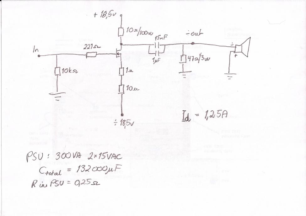

So, tried "Half Son of Zen"
Had the parts, and did not take to long time to build :)
It plays music but should probably have 8ohm resistor instead of 10 and higher PSU voltge to get "sweetnes".
Know you guys in here said so, but had to give it a try! :)
Gain is also very low.
