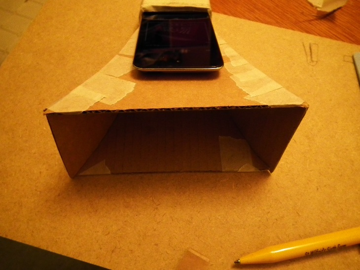

Something a little different: quick-and-easy iPod Horn
Here's my bass bin inspired horn for my Nokia phone. It's a bit messy as I was planning and cutting as I go. At first I thought it wasn't giving as much gain as I hoped but then I was relying on the back of the phone to seal the first expansion flare. Then I decided to seal it up and wow! It does get pretty loud. not hi-fi quality but the built in speaker isn't the best one there is and the player EQ did help a bit.
Sorry for the pic quality (and no pic of the phone on it) as I was using the phone to take the pictures.

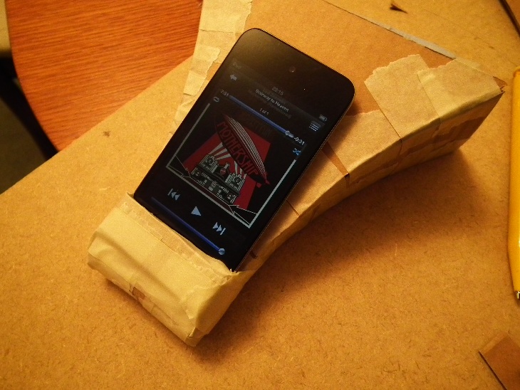

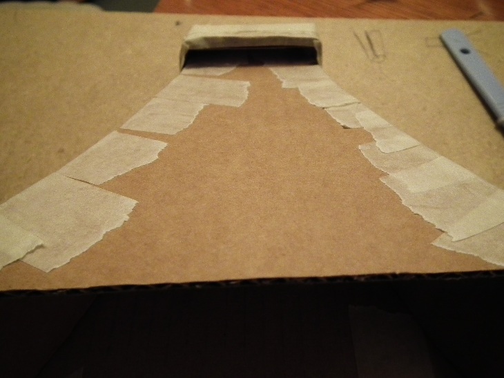

HTC Incredible - Audio Horn
Couldn't stand it........spent some time today making one myself. Phone is the Gen 1 HTC Incredible. Took the "DIY Dummy" route and just started cutting cardboard (no measurements, traced the phone to get me started and went from there). Had a blast!
Hot Tip: use a glue gun, tape sucks! :)
Pics here. I found that the sound got even better by facing it in a corner of my desk - enjoy.......
p.s. this represents my first-ever DIY audio project - woohoo!!!

Not bad for a first time project! :)

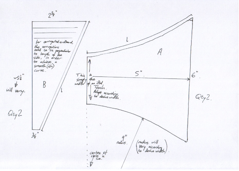

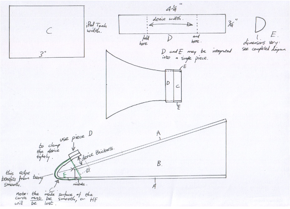

it looks like a K-slot ...
Just echo the curve of a K-slot (the magazine scan). Make a bunch and alter the opening on each until you get the best sound...
