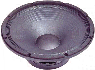

The driver you choose is not suitable for bass bins due to the low wattage for a pa speaker 350w max is 175 w rms,and not sensitive enough.
So I can imagine your on a low budget, So the Eminence Delta 15 400w rms,Kappa 15 450w rms,kappa 15lf 600w rms,kappa pro 15 500w rms all costing around under 100 quid.
Not any driver works in any box,and horn cabinets for pa need drivers of low QTS,high BL product[ high motor strength] and highish EBP[Efficentcy Bandwidth Product].

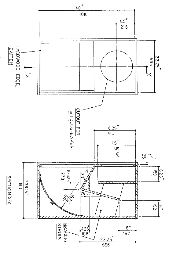

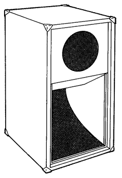

http://www.dancetech.com has many easy to build bass bin plans just look under da PA gear section-- and scroll down quite a way until u find da plans of:
W bin,15 inch scoop,15 inch/18 inch reflex bins.
All these plans on this site uses cheap-ish pa drivers such as the Eminence Kappa 15lf and Fane Classic 15300.

You can buy a good speaker from Selenium.
WPU1505 or WPU1805 (450/900W) are a good driver at low cost .

Or even cheaper than that Selenium speaker and still is pretty good the Eminence Kappa pro 15,500w rms,3 inch voice coil,80 0z magnet[ which I use in my bass bins].

There’s an awful lot of good PA that can be done with a scoop and a horn. The best part about them is that they multiply out into bigger systems well.
Double scoops used to be all the rage. They often had a bevel cut into the back to hold a pair of casters. Grab the handles and tilt it back and even I could get them on and off the truck.

From Experience....................
As Bull mentioned, for hornloaded cabinets Low QTS, and,
High Fs is the key of having the speaker "Load" in the
Horn.
I personally Like Woofers in W Bins with a QTS of 0.2 or
lower, and, rear loaded with a QTS of 0.3
I would recomend these woofers;

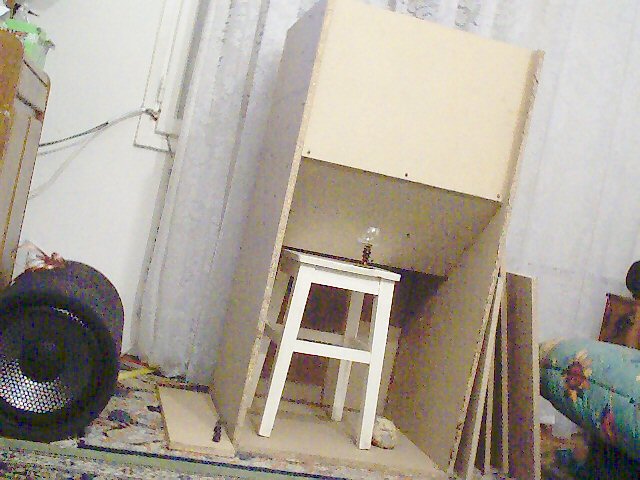

Don't mean to critise but, it's not exactly finished. The hole for the speaker ain't cut out and the 'scoop' slope is not there.
Well you could bend some 3mm ply by putting the ply in the bath and put some bricks at each side, carefully filling up the bath with boiling water[eg from kettle] in the bath
will make the ply bend if it's thin 3mm.
Then do the same to another 3mm piece of ply.
Then glue the two pieces together and nail or screw them to the box to make the slope.
Alternatively you could get a normal piece of 3/4 inch mdf or ply and put it at an angle to make the slope,although the scope would be steeper effect the response.
The driver cut out hole can be made with a jigsaw and a drill to make a hole for the blade to pass through or a router.
The hole has to be slightly smaller than the driver itself.
Fix the driver to the box using T-nuts and drill small holes for them and screw type bolts to hold the driver,which you can buy from most handware stores.
If you want to paint the cabinet,install the driver last.
Either use a couple of cans of matt black spray paint, wear mask and glothes and do in area which crappy otherwise newspaper everywhere .Or use black paint in a tin.
To protect the driver from damage buy a 15 inch round metal grille and 4 metal clamps and 4 more t-nuts and screw-bolts to secure the grille to the driver.
And a speakon connector on metal plate for pro use or a gold plated or red/black binding post for home use.
Use 18 gauge ofc cable inside minimum, I prefer to use between 10-16 gauge ofc[Oxygen Free Copper] cable for bass bins
And it's better to use spade type crimp connections to driver instead of direct solder to stronger joint.
Then add the finishing touches, plastic or metal corners, metal spring loaded handles or metal bar handles to sides or top and castors[wheels] to bottom.
The cheapest driver which works ok in scoops is the Eminence Delta 15 rated 400w rms,56 oz mag,2.5 inch vc,40hz-4khz, and costs £65,as it says in my Eminence High Power enclosure design and construction book, that all the Eminence speakers except Alpha,Beta,Kilomax work well in scoops.

Also what is it built out of Darkm8n???
Plywood or MDF or crappy chipboard.
Plywood is very good,lightish and pretty strong but expensive
MDF is heavy,very heavy in big enclosures like your one so your need castors[wheels] on bottom and spring loaded handles to move it about.And MDF is cheaper than ply and also pretty strong.
Chipboard is awful crap which breaks easily and only ok if you do not plan to move them about and is about 1 inch thick.
Well the cerment loaded grades of chipboard are very heavy and not that stronger but better than normal chipboard, but not as good as MDF.
So I'd say ply for big enclosures you wish to move about unless your on a low budget then use 3/4 inch MDF and use castors and metal spring handles.

The box isn't finish yet , as the scoop shape is missing ... i will build them and finish all the speaker with some good textile material , specialy for speaker .
I use 18 mm MDF , yes , the box is very heavy .. al least 80 kg .
For me .. a 15 years old kid .. i can't move it .. or if i struggle a bit .. a can only drag it ...
Hope it will sound good , promise to post a picture after i finish this cab , with all the accessiories and everythink , including driver , an Selenium driver or an Eminence .
I know how to make the curve board , thank's for the explication !
I make it but i didn't fix it inside the cab .
Hope this work isn't for a crap sound ....
