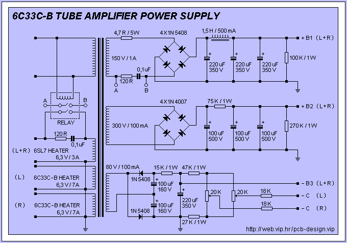

Hey guys (and girls),
I am trying my darndest to become an "expert" at reading a schematic, but I am having some issues. Particularly, when I see the actual amplifier section of the design, I am constantly wondering where the power supply is (and sometimes, how its wired to the output transformer)...Can anyone point me to a tube-amp specific site where I can see a complete schematic showing power supply, amplifier section and output?

OK...that settled, I am ready to move to the next step...Fully understanding the schematics, like for instance, I can never fully understand how different areas of the circuit are powered...I can see that the power transformer has multiple windings, but when the schematic has different sections (ie, not shown all wired together), I get somewhat confused. I'd like to get that down prior to beginning any project..

I am reviewing information from Ryder's guide and looking in particular about things showing circuits and their connections to the various components.
If you have any advice in this area, your suggestions would be appreciated
Hello,
Here is a little different amplifier, and it is very clearly drawn.
Hopeing it would help to someone.
Best regards,
Kristijan Kljucaric
http://web.vip.hr/pcb-design.vip
