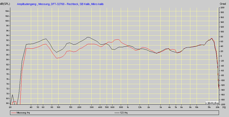

here´s some measurements:
red: ML Prodigy, black: My panel of ML Sequel-size, just the panels, without frames or baffles.
You can easily see the quite serious resonances at 160Hz/250Hz.
These have to be notched. Even though he Prodigy panel is of larger size it features a higher Fs-value because the thicker membrane can withstand higher tension values.
It follows a range from ~300Hz to 1kHz where phase cancellation rules and a audible suckout takes place (keep in mind that the curves are nearfield. The suckout is much stronger at the listening position). You have to equalize this range.
The range from ~1kHz to 4kHz is a little bit too loud in most cases. This adds ´speed´ and ´livelyness´ to the sound, but sound may become itchy at elevated levels, especially when playing high pitched female voices. The lower SPL above 7kHz with the Prodigy panel is solely due to the thicker membrane (12µm vers 3.5µm).
ML crosses the Prodigy over at 250Hz thereby using the panels´s resonance for eqing purposes. You can do this easily with a 2nd order HP with high Q and crossover freqency raised to around 400Hz, thereby equalizing the suckout region and giving a wonderful linear response down to 250Hz and highest output. The drawback is, that it only looks good on paper. Not only does the HP feature a higher Q, but the panel exhibits a long long long decay on its Fs too. And this is clearly audible. Below 250Hz SPL drops with ~6th order! Couple a typical heavy bass to it (with lots of boom), cross over with just 2nd order and voila, we have the typical ML/Hybrid- sound that so many people take as typical for hybrids and that lead to the bad image of this type of ESL.
The more complex but imo better sounding solution is to cross over at a higher freq. Than You need a mirrored frequency response with Your crossover network. A HP plus Notch plus some equing around 1-4kHz. In passive technology the notch alone may already cost You 10dB in output. In active technology You won´t loose output because of the possible gain of the filter network. Besides ESLs honor active drive by better sound and I can only recommend to drive panels actively when You are looking for best performance.

Hi Calvin,
How much dB do you loose because of phase cancellation in the range of 300 Hz to 1 kHz?
Looking to several measurements of different esls, the cancellation dip is centered around 100 to 300 Hz. Above 300 Hz it is fairly lineair most times.
Maybe the 'wings' on for example the old sequel will have some benefits here.
MartinJan
MartinJan
Hi
My plan was to avoid notch filters and equalizing as much as possible.
The notch filter probably can be avoided by silicone dots on the membrane. I've used this technique with several esls (it is also used by audiostatic) and this kills the resonance very effectively. However, in case of curved esls, the dots cannot be (partially) hidden by the horizontal bars as the dots must be placed in the middle of the membrane. So you will see them. Not a big problem for me.
Hopefully the equalizer can be avoided by the wings, but we can only know after measurements.
martinjan

You can add wings to lower the frequency where Phase-Cancellation starts, but You´d need unpractical wide wings. With a 10" wide panel P-C effects the range below ~800Hz, a 5" wide Panel will be effected below ~600Hz. So You won´t come around using some kind of equing.
Using less mechanical tension lowers the resonance freq, but doesn´t help with P-C. P-C is a phenomenon of panel size/baffle size only.
Since it is not difficult to build a panel the size You wish, be it larger or smaller, it is always beneficial to build as large as possible. Wings are just dead area (acoustical wise). Having active membrane area instead is far better. When You build ´transparent designs´ a larger panel looks better than a solid wing too.
What the dots do:
Putting dots between stator and membrane raises stiffness. As result You get a higher Fs and a rather lower Qt. The higher stiffness is beneficial in that way that You can drive the panel with higher signal voltages and the point when it comes to an overload situation where the diaphragm hits the stator is raised.
What it doesn´t do:
It doesn´t kill Fs or high Qts. To lower the Qt You need damping. That is one of the reasons why most fullrangers are not transparent. The damping mats would look rather ugly.
The silicone dots used by Audiostatic introduce not much damping, because silicone has rather low damping values.
So, with regard to Fs and Qt the two ways -using high tension, or using lower tension and dots- lead to similar results.
When placing the dots it should be kept in mind, that they reduce the maximum diaphragm travel and output. This isn´t a real problem with hybrid panels, but could be one with fullrangers. So a certain minimum distance between the dots has to be supplied for. This minimum distance could be reduced only if the dots feature some compressability, like foam does.

With regard to measurements. I did that with a 10" panel and 4" Wings and there is still a considerable drop out at 300Hz.

The damping properties of silicone dots are irrelevant. You could get the same thing with hard dots. If it would seriously raise Fs, all the full range esls of audiostatic would have a big problem. They wouldn't be able to generate low bass and they would resonate at a higher freq. This is not the case.
I would suggest that you try this experiment yourself. Seeing and hearing it is better than 1000 words.
The measurement you did, was it an electrically divided esl?
The mirror drive of audiostatic (used to compensate phase cancellation) starts to operate below 300 Hz. Final 1.2 starts to drop below around 300 Hz as well.
