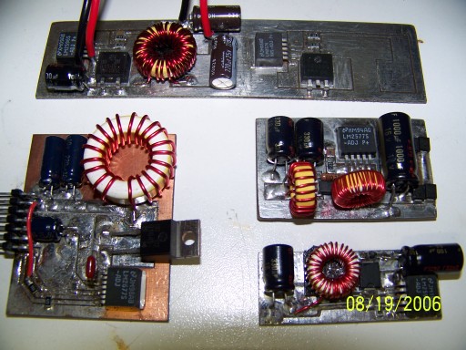

Last One: UCC3806 Controller board
This I did for a modular DC-DC PWM Current-mode SMPS. I wanted to try different controllers, like the UC1846/2846/3846, UCC3806 (BiCMOS version of the '1846), UC3856 (high-speed version of the '1846), and MC33025/34025, without having to re-do the entire board. 90-degree headers made things really easy. Note the optoisolated input for taking feedback from across the Galvanic barrier (transformer).
Gotta love those 1% RN-55D's :D

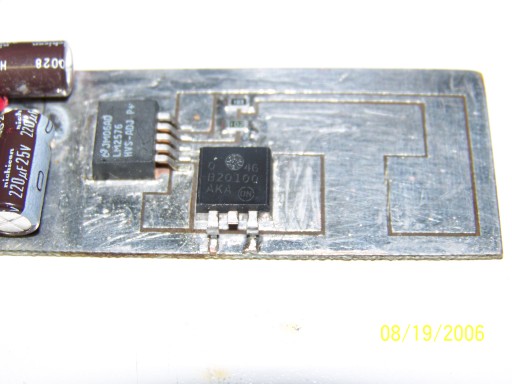

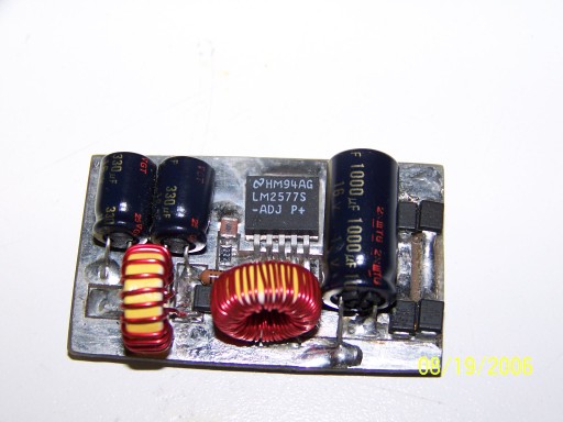

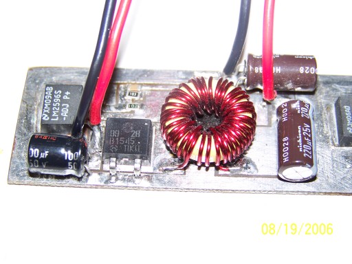

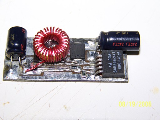

Not too hard, especially since they're using smt components, I don;t have any hole drilling to do. I do the traces and close-in parts using dry rub-on transfers, and masking tape for the wide-open spaces to make the ground plane. So, what's actually being etched are the separations between all the nodes. Like I said before, two advasntages here: 1) less copper is eaten, so less FeCl3 is used, and 2) takes much shorter time to etch because of #1.
