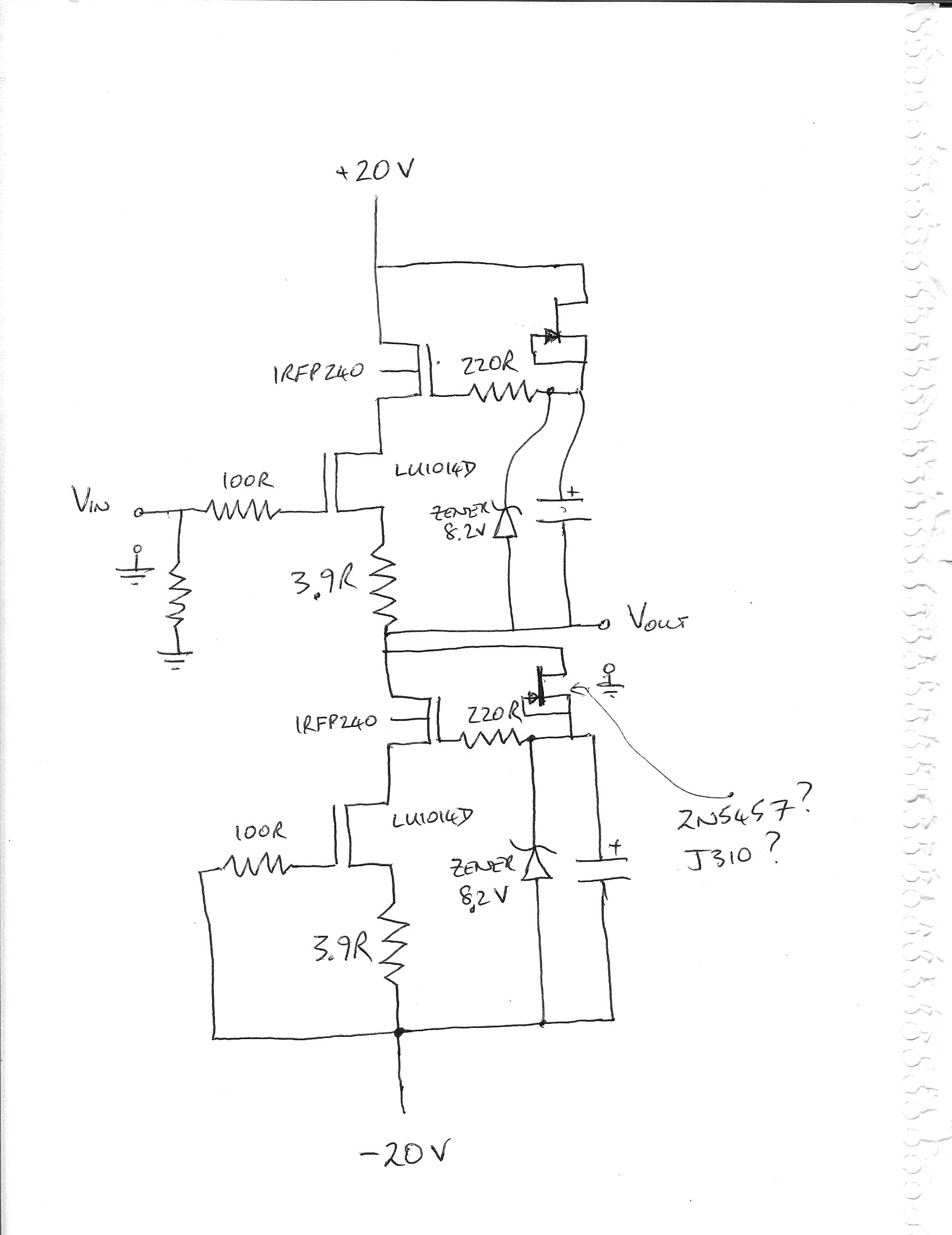

Hi Everyone,
I thought I'd post a progress report, and ask a few questions.
I've finished the chassis, (first version of a) power supply, and a protection and muting circuit. The PSU is a CRCRC filtered, unregulated supply, giving about +/-21V DC. A friend helped me measure ripple - at around 65mV peak-to-peak when supplying about 400mA, which is close to normal use in this case. (That's in an Elec. Eng. lab with the top of the supply off, so a really noisy environment. Ripple will probably be a bit better than that in practice.) The PSU is in a separate case from the amp; there is a further "snubberised" 4700uF on each rail inside the amp itself. Protection and muting circuit is the one from the ESP site (project 33).
I'm doing the DAO without Taylor mod. I've decided to do this and live with it while on leave (as mentioned above). I can mod it or build another when I come back if I feel like it. I also decided to go with the first pcb design; this may have been a mistake, in retrospect, but it's too late now...
I've posted a schematic below, adapted from one the one discussed on the other site. (Sorry my artwork is so bad... Hope it's legible). Although I couldn't find one with the caps on it, I'm sure I saw it somewhere, and the pcb clearly shows them, so they should be there, I guess, as they are on the DAO with Taylo.
Here are a few questions
1. Earlier in the thread Patrick suggested using a jfet in place of the J511. Have I got them wired up right on the schematic?
2. I have a few 2N5457 on hand, and should have rather more J309 or J310 here somewhere. Any need to use matched pairs in the circuit? If so, I probably don't have enough 2N5457, so how about J309/310, or MPF102, which I know I can get my hands on?
3. Is the function of the capacitors just to eliminate noise from the zeners? I notice that the original version Steenoe built didn't use them, so I guess the circuit should work OK without them. (Right?) I ask because I am using the small boards, and the caps I have (Elna Silmic II) are surprisingly large, which makes it dificult to mount them and still get DMM probes in to measure anything once it's working. I thought I could try things out and only put them on when everything else checks out.
4. (A real newbie question) On the other thread Patrick says to use the central mounting point on the boards as the star earth point. I presume this means an insulated screw holding it to the heatsink, and the three connections shown on the board are for the input, output and voltage grounds... Right?
5. (Another newbie question) Is there any reason I shouldn't put the resistor from input to ground directly on the RCA input socket? I've done it before with other amps, but this time I've gone to the trouble of importing "quality" parts and so on, so I'd like to really try and keep noise and hum down as far as possible.
I'll post photos when finished if anyone is interested.
Cheers
Nigel

Thanks, Patrick.
1. OK
2. I've got 2SK170BL also, I think, so no problem. (I don't know why I didn't think of those...)
3. The schematic for the DAO with Taylor showed 220uF, so that's what I bought. I can change to 22uF easily enough, although they'll be Epcos or something, not Elna. (Probably makes little/no difference...)
No answers to 4 and 5? Too obvious?
Thanks again
Cheers
Nigel

Hi juma,
I don't think that high Idss is an obstacle to use J309. One Source resistor solves that - something between 100R and 220R should be OK.
Yes, but there's very little space for an extra resistor, so since I have plenty of 2SK170 (I think - I'll have to check...) I can just use those.
What about 4 and 5? Only issue is avoiding ground loops and minimising noise, other than that it's all clear to me.
Cheers
Nigel

How about tantalum caps?
I stopped off after work to get some smaller caps, and ended up buying standard 22uF 50V aluminium electrolytics (Epcos) and also some nice-looking 22uF 35V tantalums. The parts guy there (who knows his stuff but isn't into audio at all) says they are much better quality than the Epcos (and they certainly look a better quality part), but I've never used tantalums before.
A search on the web showed they are often used for bypassing and so forth, which sounds like much the same thing as here. Since I'm going to try the amp without caps first, I could also just try both types to see, but in this case it'll be a real pain in the a** to pull caps in and out of such a small space, so I thought I'd ask here if there is any downside to the tantalums before I put them in.
Anyone have any thoughts?
Cheers
Nigel
Nigel.
Caps - you're just going to have to listen for yourself - it's very subjective and mostly different for everyone.
The Epcos caps that I tried were a bit "slow" and now using a Nichicon KZ on top arm of cct, and a Silmic on the bottom - it just suits my system and musical taste - I didn't like the sound of Tants here, (or Oscons, either) but you'll have to try for yourself.
My k701's now have some fancy multistranded wire on them, so h.amp requirements are a bit different.
There is a slight difference when using the fets (plus resistor) as current sources and if you are doing a perfboard build, suggest try them - quieter sound, slightly.
In fact, with such a simple cct, everything will have an effect to some degree but with the very small pcb layout, not as many options for you.
It does sound quite a bit better when running the power fets hot - somewhere between 55 -> 60*C - lot of top amps run this hot, or more, with good results.
It's much better with really good power supplies and especially revealing of the music source limitations!
Remarkable cct - well worth perservering with it.

Hi James,
What fet and resistor did you use? Following Patrick's remark above I put 2SK170 in, measured and rough-matched at around 7.5mA, no resistor.
I hope to try out different things with PSU and the main circuit, and will try the Taylor mod at some point. However, since I won't have any decent headphones until I'm actually *on* my sabb. leave and buy them, I won't be able to do much tweaking "by ear" until I get back - which is quite a long way off. Which is one of the reasons I'm asking about tantalum caps, and so forth...
Cheers
Nigel

Following Patrick's post earlier, and James reply now, I wonder if the 2SK170s I put in at 7.5mA need "throttling back" to 5mA... This means a small resistor between gate and source, right?
Thoughts? Am I OK at about 7.5mA? And what difference would a higher Idss make anyhow?
