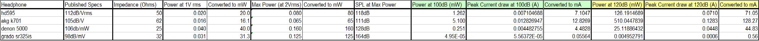

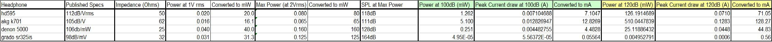

I checked the calculations again with a calculator, and there is a mistake.
There is something wrong with excel. Excel is saying 4.95, and the calculator is saying 7.95
What ever you do don't try and build a space shuttle (or anything else for that matter) using excel.
I will go through and check the other calculations with my calculator, and update the results.
To avoid confusion I will upload the results again.
There are definitely no mistakes that i can find.
Andrew might be kind enough to check the calculations.
  • apples to apples.zip
