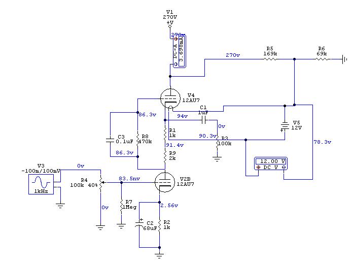

Hi Refference,
I have modified my schematic with yours instructions.
And I see on the simulation, when I put a 22k resistor I have 35v on the plate of V2B and 1.669ma of current.
I put a 2k on the place of 22k and I have 86.6v on the plate of V2B, and 3.669mA.
I put a print screen of the new schematic of the SRPP with your instructions to you confirm me if this is correct, okay?
To increase and decrease the B+ voltage, I'm thinking to make a regulator with a 2sc4923. I has found this NPN transistor in a CRT Monitor . This has a BIG Vceo voltage = 800v. But I haven't a good project of regulator with these NPN devices.
I put the B+ on the tube when the Filaments HOT...
Thanks and Best Regards,
Felipe Navarro.

Hi mod evil ,
You made some mistakes !!!
1 - The resistor R8 , should be connected between , the
control grid of V4 and the point between R1 and R9 ,
see my tip # 6 .
2 - C3 is connected correctly . OK !!
3 - R9 is wrong , its value is 22K , not 2K , see my tip # 5 .
4 - EXTRACT ( eliminate ) C1 and R3 from the circuit , they
must be ELIMINATED , see my tip # 3 .
5 – FORGET about +B regulated power supply !!!
It’s not necessary . The high time constant obtained
with a RC filter , is more than enough , to mantain the
+B value constant , see my tip # 8 .
Make the corrections above , redraw all the stuff
and try again !!!! I’m waiting your reply !!
Good luck ,
Carlos

Hi again mod evil ,
Now your circuit is OK !! You are almost there !!
ONLY ONE MORE “TIP”: If you change the value of
R1 and R2 from 1K to 1K2 , AND change the
value of R9 from 22K to 24K ( 2 x 12K series ),
the current will decrease a little bit and stay closer
to 3 mA ( the desired value ) .
The signal output will be taken from the CATHODE
of V4 ( this is a low impedance output ) . Connect
a mylar or polypropilene capacitor ( 2.2 uf or
4.7 uf x 400 V ) to the CATHODE of V4 ( the top
triode ) , and after the capacitor connect a 470K x
1/4 Watt resistor , to work like load , and “voilá”
that is the output .
Your 820 uf x 200v caps , are not useful , the correct
and the IDEAL solution is the follows :
1 – Try to get a power transformer with a 270 VAC
secondary , if you can not , try to use two power
trannys one at 220 VAC and other at 48 VAC
( secondary voltages ) series connected AND
IN THE SAME PHASE ( if not the voltages will
be subtracted , and not added , how should be )
2 – Rectify the AC with a bridge and filter with your
330 uf x 400 V cap .
3 – Then connect TWO 18 K x 3 Watts resistor ( one
for each channel ) at the 330 uf x 400 V cap , and
the other side of the resistors , you will connect
in TWO 220 uf x 400 V cap ( one cap for each
channel ) independently . Did you understand ?
Each 18 K x 3 Watts resistor , should be connected
to each 220 uf x 400 V , and .... “voilá” , at each
220 uf cap ( one for the left channel and the other
for the right channel ) , you will get aprox . 270 Volts
CC , WELL FILTERED , to feed the circuit , without
any hummmmm .
Try to make ALL the changes that I have suggested and
you will like the result . I’m shure !!!
Any doubt , you can ask !!!
Carlos

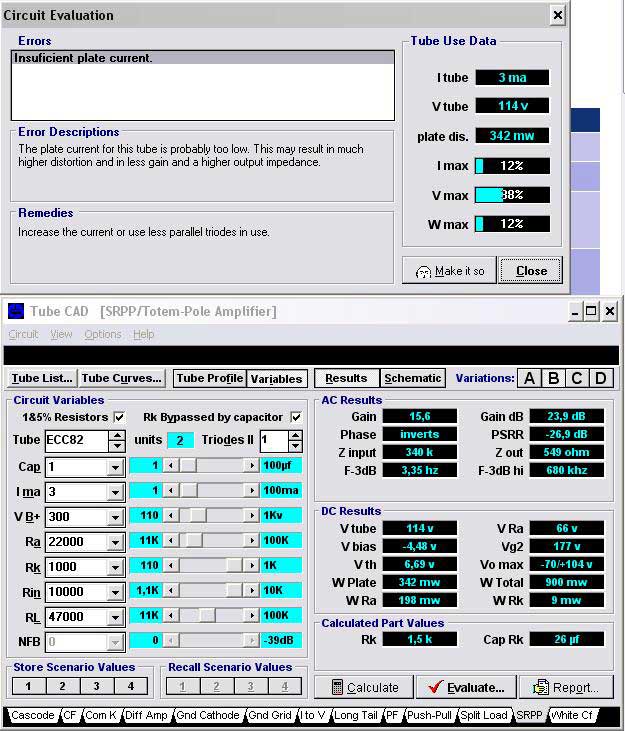

-> Refference,
I have evaluated the schematic in the TubeCad. And with 3mA, they send to me a mensage how I will have a BIG distortion because I have a low current on the plate, and this is will be a HIGH output impedance and Less gain.

The problem isn't on the conections. Because I have shorted the input to the ground and the HMMM persists.
I haven't money to buy a other power transformer. I'm a student with 15 years old.
See the file who I puted in this topic.

All Friends of DIYAUDIO,
I have remounted the SRPP with the last schematic who I post in here.
There aren't HMMM on this AMP.
But the problem. I think isn't on the my frist schematic. The problem is in the power supply. There aren't CRCRCR FILTERS ON THE FRIST SCHEMATIC. THIS IS GERATING THE PROBLEM OF HMMM.
This SRPP have a spetacular SOUND!
Best and Happy Regards,
Felipe Navarro
