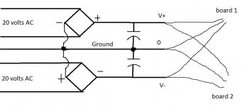

Well it's been a little delayed but i did get the boards and they are basically what's in the picture. Haven't really compared too critically though. The bad news is when powered up there was a quick buzzing sound and then nothing. No sound whatsoever coming out of the speakers even with my ear right up to the tweeter. So i think they are dead. I did have them at a shop so the machinist could machine out spaces out of big blocks of aluminum for them so he could have damaged them I suppose but unlikely both of them. The rails both read 30.8 volts when everything is hooked up. Even when it's plugged in with signal going through them and hooked up to speakers for about a minute (haven't kept it on for longer) the chips don't change temperature at all.. cold. So I guess they're effed up? Anyone got any ideas?

1. Last night the power supply rails were reading 28-30 volts with the supply disconnected from the boards. Normal. Right now they are reading around 42-43 volts. How can that be?
2. While hooked into the board last night at the same time, and checking the rails at the board input i was getting a reading of only a few volts. 3-4 maybe..
How can the power supply fluctuate like that? It's possible the filter caps are damaged. They did overheat severely once for a few seconds while building a different power supply due to wrong wiring. I unplugged it quickly though, they didn't burst, swell, or leak anything so i figured they are fine. Can this be responsible for the power jump though?
I certainly hope it's the mute or standby pins. But if 42 volts was what went into the board it's probably fried right?

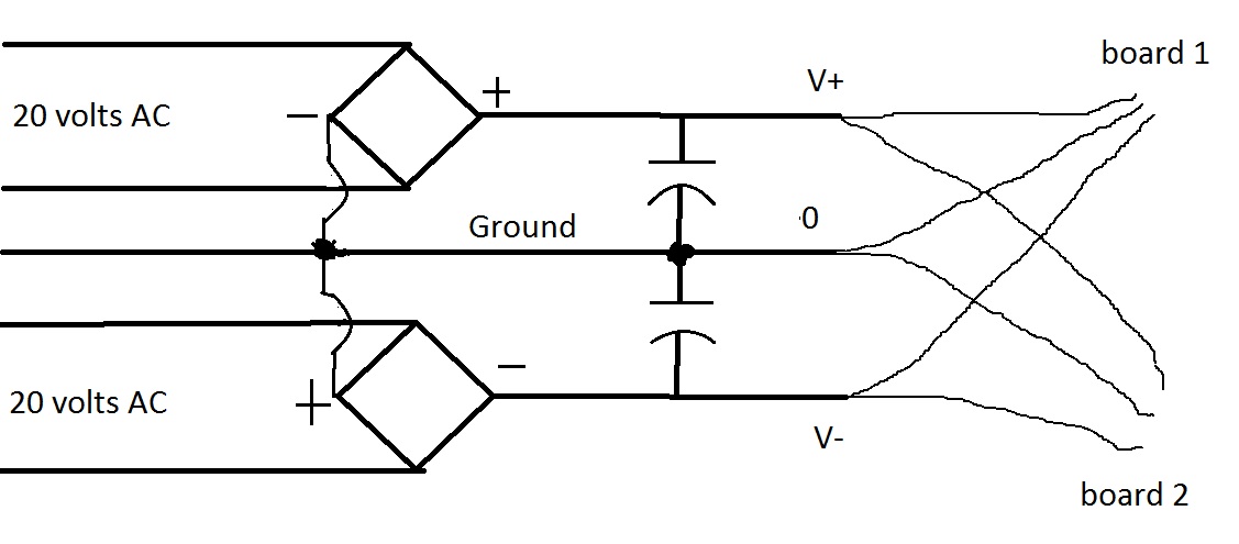

This is how my power supply is wired

No, the TDA7293 can withstand 120 V from rail to rail. Check the voltage rating of the capacitors on the board. A slight overvoltage won't kill them immediately either, but if they are rated for much less then 42 V, they might have been damaged.
Anyhow the 20 V AC should give 28-30 V with no load, so you should expect to get 56-60 V from V- to V+.
Ok, let me recap. Connecting voltmeter from v- to v+ with no load, after the rectifiers/capacitors i'm getting around 48 volts (not 42, sorry). Connecting from ground to v+ i'm getting 30. Does this make sense?
Only, if you have 18 V from V- to ground. That would indeed hint at damaged capacitors or a still existing wiring error in the negative power supply.
Just checked again this moment. From 0V to -V I'm getting exactly 30.0 V. From 0V to +V I'm getting 28.9 V. From -V to +V i'm getting 47.1 V.
The capacitors are rated 80 VDC
Its' wired the way it is in the picture, no doubt about it. So i guess i'll get some new caps. Too bad, these ones were $60 a piece :eek:
Yeah.. I don't know what it was. I bought some new caps and rewired the whole thing and got the correct voltage. 60 V exactly. However, one of the chips on one board fried immediately after plug in. And the other board was just putting out some noise through the speaker.. hmmm. I will have to order another pair of boards and have a go at this once more. Will update then..
I haven't inquired about it to be honest. There is DOA policy which you have to report within a few days of receiving the product but that wasn't possible in my case since i had to wait longer than that to get the heat sinks made. But I will send them a message. I just don't want them to give me some answer that will **** me off and stop me from buying another pair lol.. the aluminum slabs are predrilled already for the chips. For the price it's worth another try.. around $70 shipped and assembled pair. The one chip is dead and i'm not getting into ordering one and replacing it. So I will have to order at least one more board. Whether they decide to take the blame for it or not i dont know. I have my doubts. We'll see.
