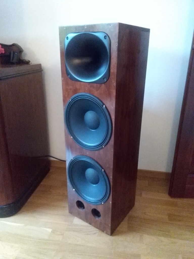

First I will test all these with my present 2 way speakers ... by the way, did I show some pictures with actual diy speakers? If someone curious I attach some ...
