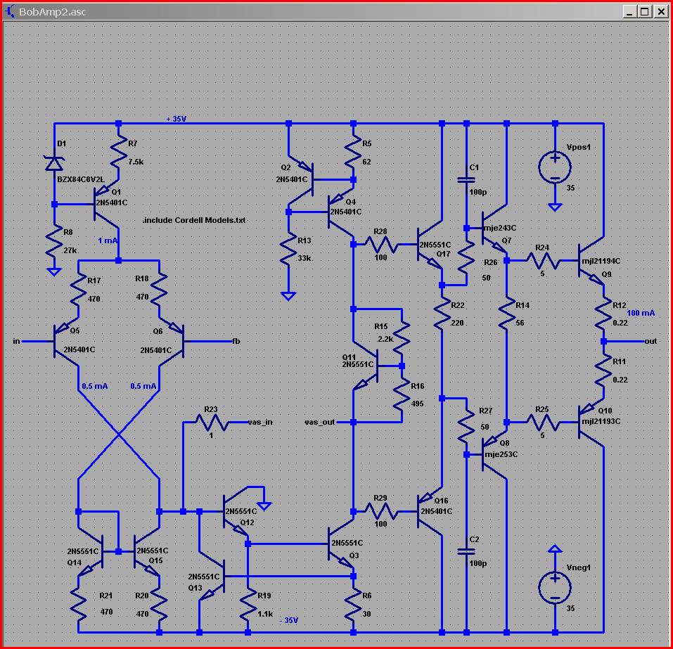

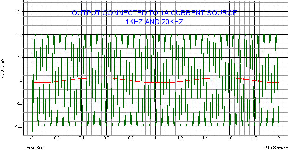

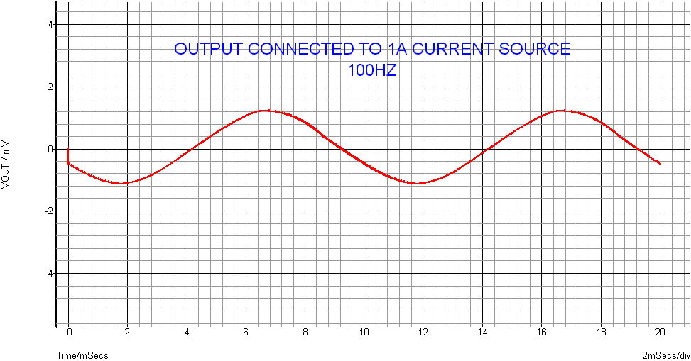

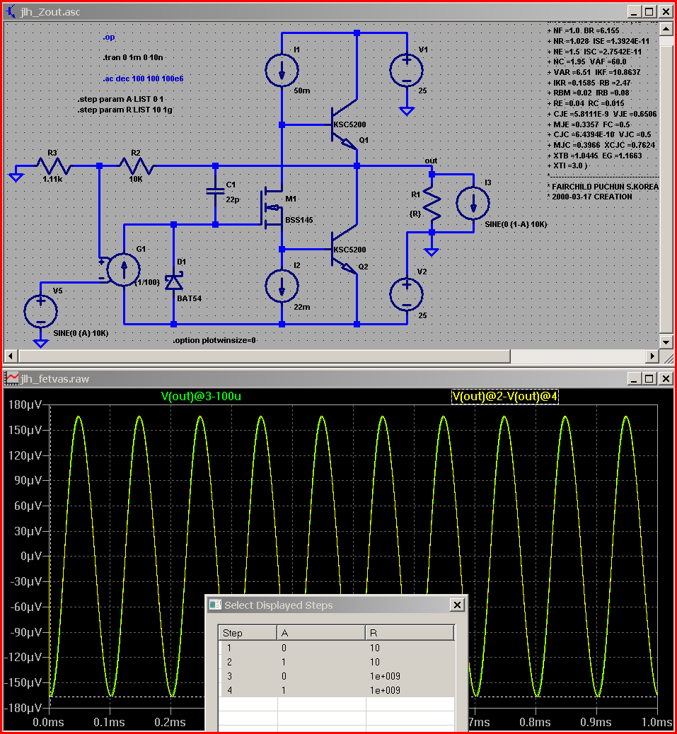

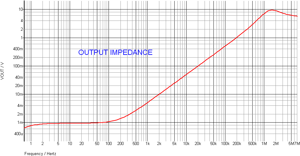

meaurements may take a while - haven't restored my home lab since getting pushed out of my previous job with a complete lab where there were occasional moonlight audio explorations
but sims I can can do
this one uses a modification of the earlier JLH style output simplified amp sim - Fairchild Q model, ~2.2 A Class A bais
the gain is 10x, the .step functions step input vs output V, I sources amplitudes, both at 10 kHz, the load is stepped from 10 Ohms to "infinite"
the plot is the 1 A "output driven" output V green trace vs the diff V between 10 Ohm and "infinite" load for the forward 1 V input, 10x gain which gives 1 A output yellow trace
you can barely see the difference in AC amplitude when I adjust the DC offset to overlay the green and yellow plots
simmed Z_out measured both in "forward" and "output driven" directions is essentially identical in this sim @ 10 kHz (displayed below), and 1 kHz, and 100 kHz as can be verified by editing frequency, .tran args

just to see that Class A isn't a special case I repeated the above with my "BobAmp2" circuit using dominant pole compensation - the circuit, Q models are Bob Cordell's - can find discussion in his book thread
I believe Bob added the stoppers/filtering as examples of parasitic oscillation damping measures
the output Q are slow, biased to 100mA
the sim is for 2.5 A output current, a 4 Ohm Load R, 100kHz is shown
despite the substantial crossover spiking the V(out) delta's fundamentals agree quite well - I also plotted the currents to show that the forward direction phase shift is pretty well explained too
I claim this demonstrates the "small signal, linear" part of the 100 kHz Zout of the BobAmp2 sim has essentially the same value for both the "output injected current" test and the "forward" measurement
(note that even the crossover spike shapes agree to a remarkable extent)
