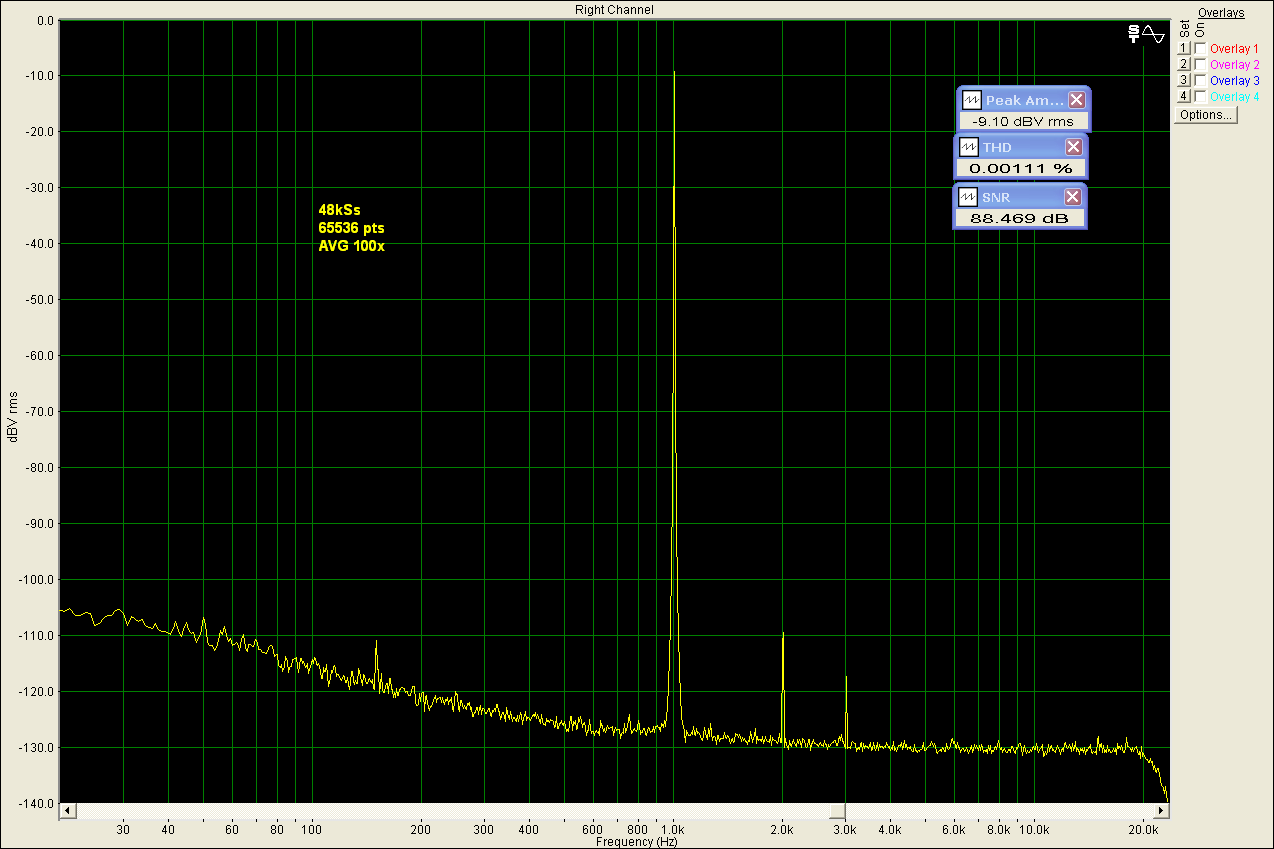

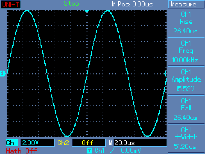

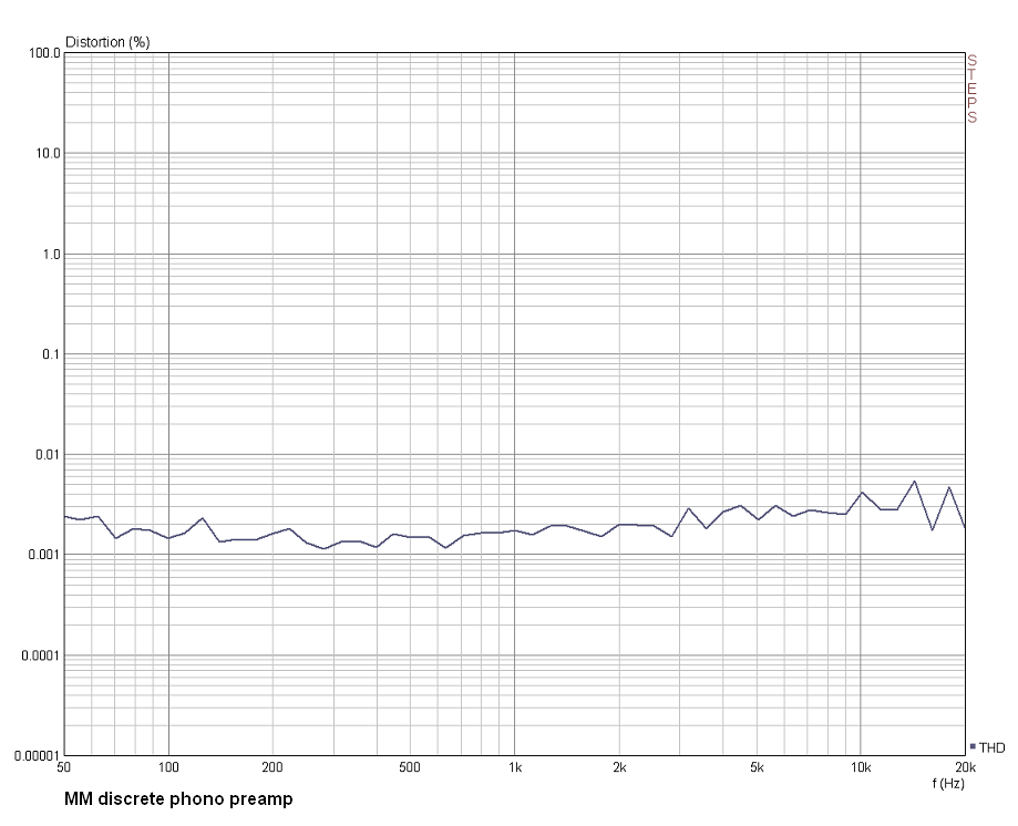

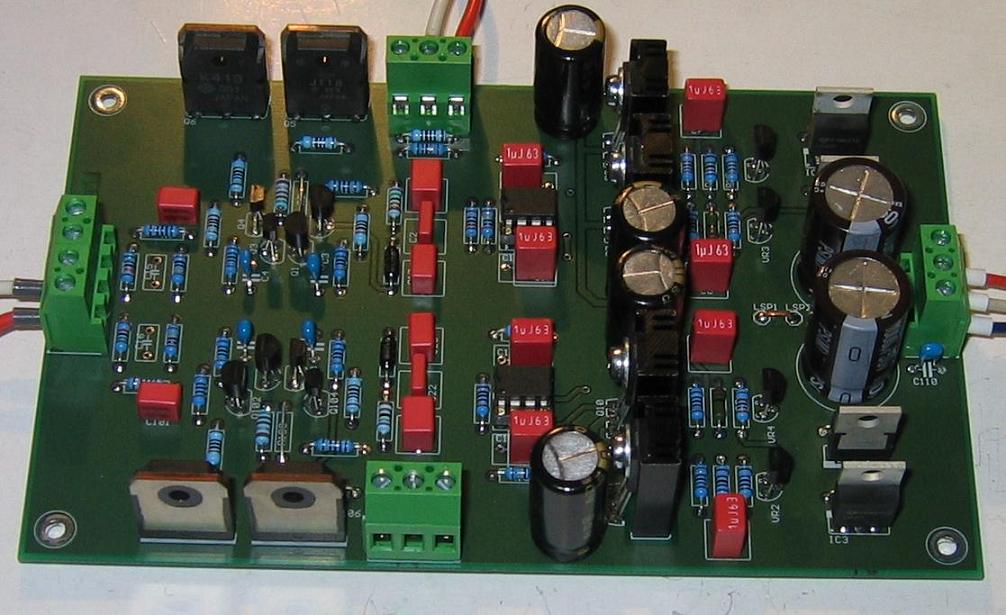

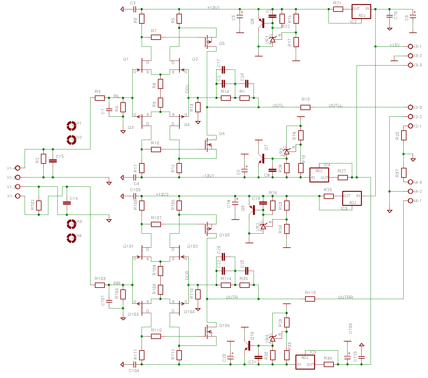

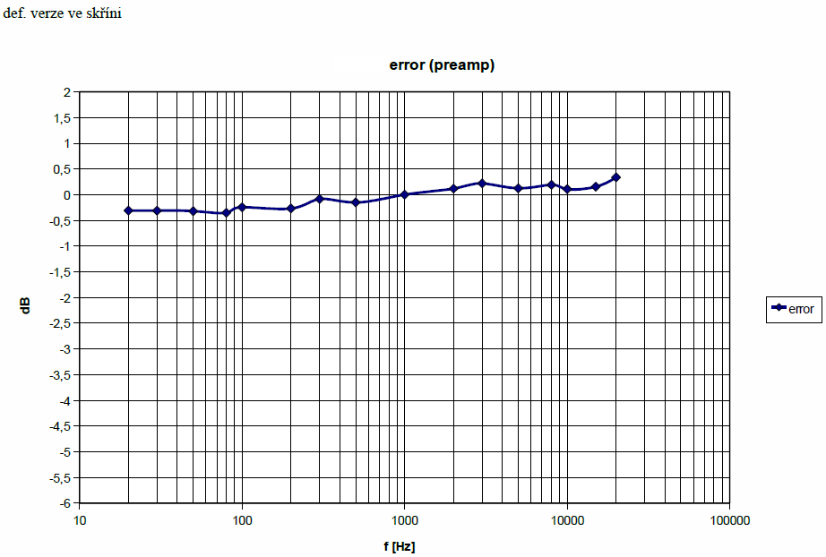

Well, finally some small progress. The evaluation sample built, for MM. All discrete, JFETs + MOSFETs. Opamp for DC servo. Equivalent input noise 2nV/rtHz. Several measurements attached.

It will have sophisticated 3 stage power supply, with conventional series voltage stabilizer followed by CCS current source and by a shunt regulator. CCS and shunt regulator will be a part of the preamp PCB, series voltage stabilizer will have its own PCB.
Close to my next phono project design, where I will use a CH-style source-follower and shunt regs.

Some measurements made, and a simple web page created.
Discrete preamplifier for MM cartridge
THD/SNR measured ref 5mV/1kHz input.
