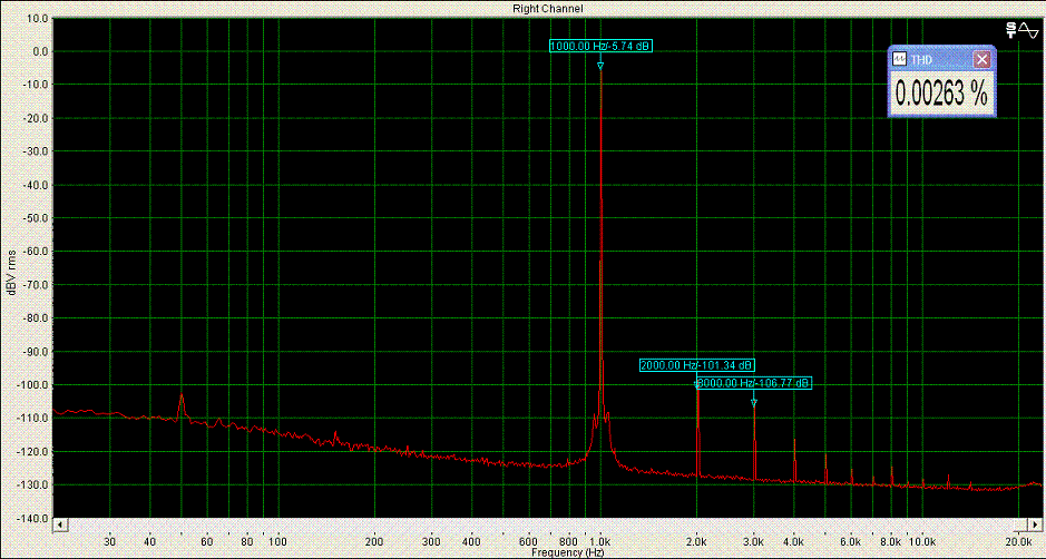

Pavel, what is the nominal THD of your functional generator? Did you use an passive attenuation network between generator and phono input?

I will repeat that meaurement with sharp 1.5kHz lowpass filter, which I use when I want to get rid of generator harmonics. Generator itself has 0.0025 - 0.003%, with dominant 2nd, then decaying 3rd, 4th, 5th .... etc. Very similar to spectrum posted.
It is 7Vrms output, with divider at the output. There was also divider at the input, for the reason of high sensitivity of the MC preamp.

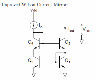

Hi Jam,
the main reasons are the currents and dissipation involved. With my particular FET's, the Q's source 26mA, which translates into approx. 250mW dissipation in a Widlar. Since the that300 transistor arrays are typical rated to only 20mA it is questionable if i can use them at all, but surely not at 250mW. The Wilson has the added bonus, that the third 'cascode' transistor does not need to be of the same brand/type.
When chosing the right cascode Q (as for example the 2sa1360/2sc3423) one gains additional bandwith and lower thd as a bonus.
Rüdiger
Rüdiger

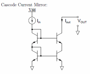

Hi Rudiger,
Thanks for your reply.
What you say makes a lot of sense. I see the advantage of the third transistor not having to be of the same type and reducing the voltage drop across the second transistor. This should reduce imbalance on the mirror due to heat.
Do you think there will be any advantage to using an enhanced Wilson current mirror or even a cascoded current mirror.
Jam
Jam
Hi Jam,
the answers to your last questions are beyond my experience.
The only thing I can say is, whenever there is a discussion here regarding the sonics of current mirrors it's said that one should keep it as simple as doable or possible for a certain design goal.
Rüdiger
Rüdiger

About current mirrors.
I use currently this type, posted by Jam here:
http://www.diyaudio.com/forums/attachment.php?s=&postid=1522114&stamp=1211926250
Uses 4 Transistors - without cascode
I have found them the most precise, while still not over-complicate things

About cascoding.
Many INPUT stages, with low AC voltage deviation across JFET / Bipolar,
do Not benefit hardly anything from Cascoding.
It is just not worth it!
It is a totally different case, when we have high voltage swing.
Like in VAS Stages or Input Stage of a Buffer-follower.
Here both BJT and JFET can benefit from cascoding.
I have setup circuits where THD was reduced considerably, bya cascode.
And this makes sense
One of the most important feature of CASCODE is to try to keep C-E (D-S) voltage changes to a low level.
Where is not so big delta voltage ( 0-1V signal when we have a supply of 20-25 DC across input pair ),
it is in this aspect not worth the trouble and 'extra addons' to cascode.
Remember, all addons and extras Are Sources of potential Problems.
Where is a device, a rail for current, there is a potential source of distortion.
Where is nothing .. there is also no medium to cause trouble!
There can be other reasons for cascoding. But this you all know.

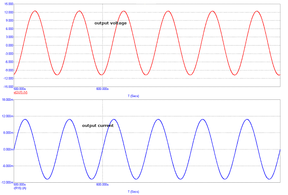

Hi Lumba,
I am enclosing output voltage and current (through eq. circuit) for 20kHz, if it helps. The output current is about 12 mA peak. Yes, the output stage must be capable to handle about 100mA.
The output DC is due to long settling of the circuit that has so high low frequency gain (80dB), but has a low frequency rolloff as well (Hz, 10Hz), a response to suddenly turned on sine. It is neither due to saturation, nor DC servo issue. Only the circuit with bandwidth starting exactly from DC would not do it.
PMA said:Only the circuit with bandwidth starting exactly from DC would not do it.
Sorry I was wrong when writing this. It certainly would, as it is a question of transient reponse of the RIAA equalization circuit /even passive/ to suddenly turned on sine.
