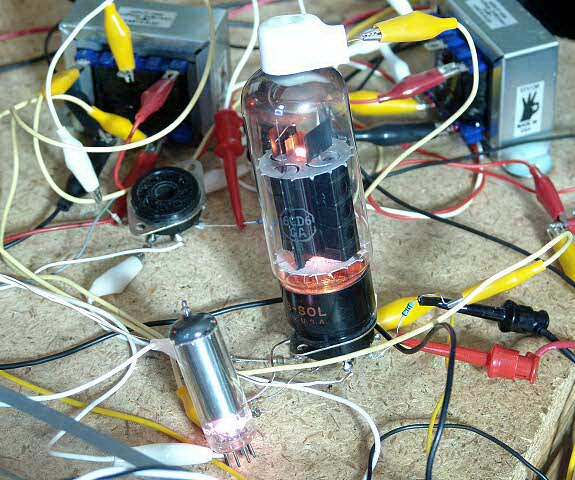

It IS possible to use a zener diode or gas VR tube to drop the G2 voltage a few volts below the plate in triode or UL mode for use with sweep tubes and other tubes with MAX G2 voltage specs significantly less than the plate voltage. This will work up to a point. When the plate voltage gets pulled toward the cathode voltage, G2 will drop to the plate voltage - the zener voltage. When the plate gets near the zener diode voltage the screen will be at zero volts or less, and severe distortion will result. This severely restricts the available undistorted power output.
From a test that I did in 2008:
I did some experiments along these lines when I was torturing some sweep tubes at plate voltages that would melt the screen grid. The results were promising but there is only so much to be gained. If you use too big of a zener the G2 voltage can approach zero on low going plate voltage excursions. For those who are sandophobic a gas regulator tube can be used. The photo below shows a 6CD6 with an 0B2 between the UL tap and the screen grid. Do not copy my unique breadboarding method. I think that an 0A2 might have been more suited because when I really cranked it the 0B2 would extinguish on peaks causing some really rude distortion.
