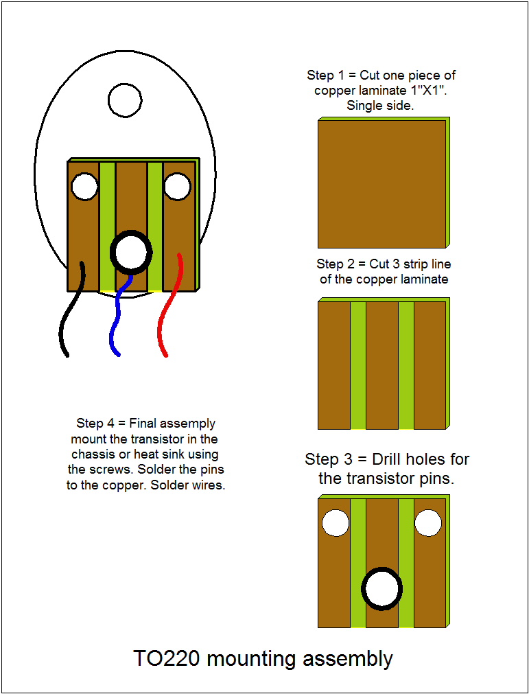

I have a cheapo way to mount the TO3 transistors. Attached is a pictorial on how to do it.

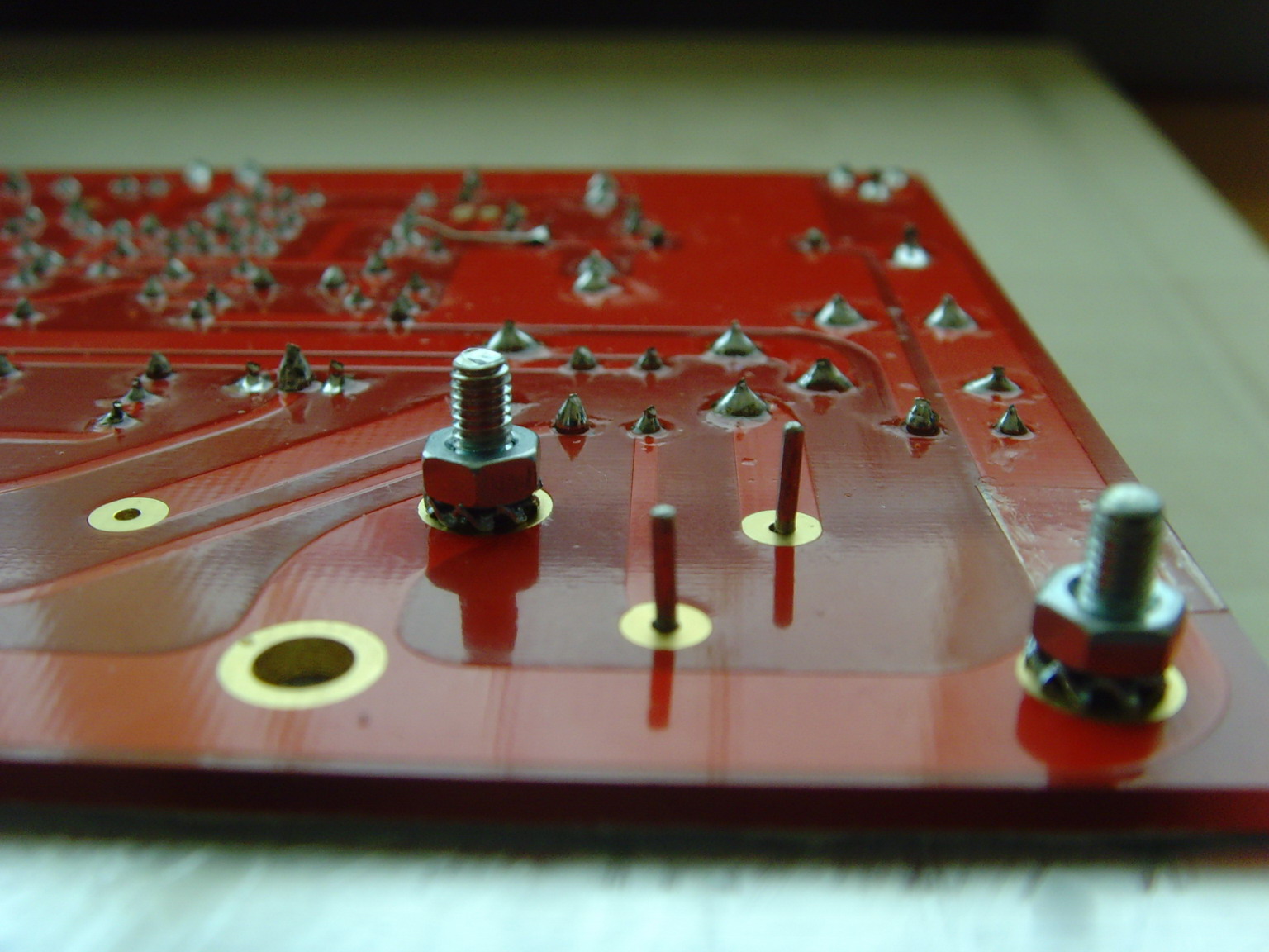

you need not solder the collector / case of a TO-3!
This is the way I did it - and: this is perfect.
Best regards - Rudi_Ratlos

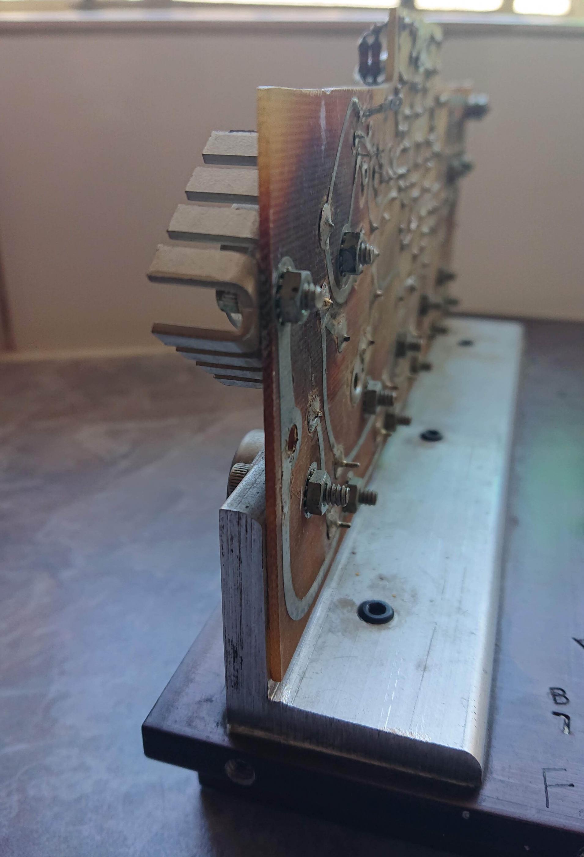

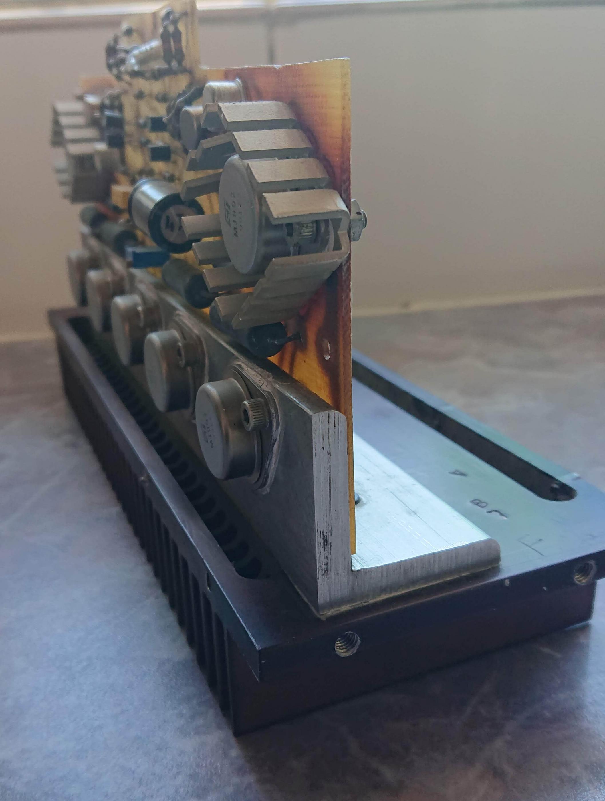

When it comes to power transistors mounted onto a heatsink, there should not be any vias on the top of the PCB, as this is clamped hard up against the bottom of the aluminium plate (TO-3 and mica on top of plate) with the pins and bolt holes going through holes in the alu and PCB. The picture Rudi shows is exactly how it needs to be done. I have also attached pictures of my Bedini 25.25 mounts original mounting.
Kevin

Crinkle washers and solder tag on the mounting bolt is how to do it. But the whole thing
is a bit of a bodge, and its one of the reasons TO3 died out as flat packages like TO247
are far easier to work with and compact and give many more mounting options.
BTW soldering the case won't damage the chip unless you really overdo it, silicon is more robust than that when not powered.

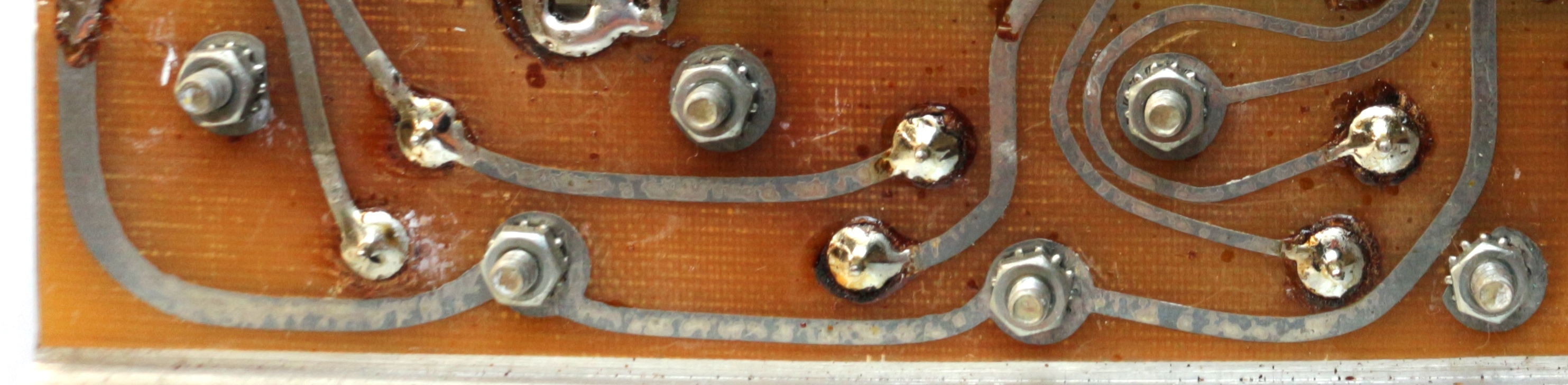

Handel, I always tin the pads lightly before trying to put the TO-3 in place, and then soldering to the base or emitter is much easier. the solder should not penetrate through the PCB as it may flow too far and cause a short to the sink. As I said in my post above there should not be any traces on the top side of the board, so there is nothing to worry about.
Close up view of soldered pads for three of the TO-3s.

No need to worry about penetrating solder at the base and emitter holes. For convenience I always drill all the holes to the same diameter of 4 mm that suits the collector insulation bushes. It's very unlikely for the solder to go that far. Hence I've never encountered any issues that could be traced from that.
Best regards!
