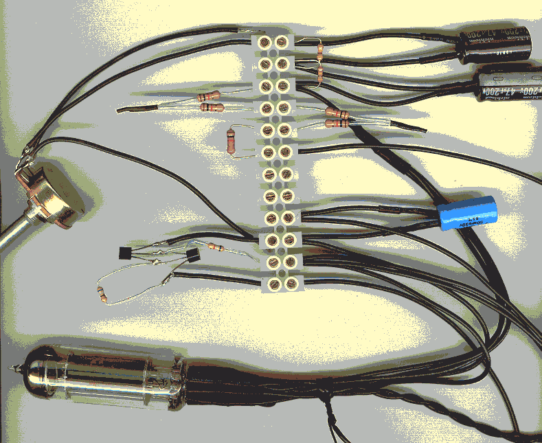

Je te le conseil pas, j`ai deja essayer, car c`est du fillage assez gros (la pin) donc ca prend du temps a chauffer. De plus, moi tout ce que j`ai réussit a faire c`est casser la pin d`un tube de 25 $....
donc non acheter toi le socket a la place.. ca en vaut le cout

Actually I did this once when I was in the same situation and too impatient to wait for the sockets to arrive. I wrapped solidcore copper wire around each pin and tried to solder them to the steel pins of a 6922 tube. Even with a 80watt iron the solder wouldn't stick to the pins. But I still got the components connected and it did work, though I dont recommend it. Not a good and longlasting connection. But if desperate enuff...
I wouldn't, particularly if it is a genie Amperex. You should be able to get sockets quite quickly from a variety of sources.

In a pinch, I have used the socket pins from a Radio Shack RS-232 connector, with some heatshrink tubing shrunk onto each socket pin. (Rat Shack has heatshrink too) Works real nice, and they are gold plated socket pins.
In fact, it worked so well, that I now use this method for a curve tracer setup, where I can pin configure the "socket" for any tube type quickly.
Soldering directly onto tube pins will likely crack the glass vacuum seal.

I've used it for the 802 pentode, socket for it seems to be almost unobtainable. Otherwise, alligator clips are the way to go, but I wouldn't suggest this without suggesting to BE CAREFUL with the high voltages, alligator clips can jump out of their place if aren't placed carefully, and maybe hit your face

Unless you need to replace the tubes at some point! Ever work on an AMC tube amplifier product? Not fun. (EL34's)Il marche bien pour les Octals.

I've used those RS232 connectors also,and even managed to solder them onto the pins of a 6X4(?? it was some kinda 7 pin tube)
The trick is to clean and sand the tube pins well,don't heat the pins any more than you have to ,and afterwards don't stress the pin connections. (I had a pin "come loose" and the 6X4 tube lost it's vaccumm.)
Octals,for some reason,seem a bit easier to solder?
Octal tube pins are just soldered over the actual lead wires coming out of the envelope. They are meant to be soldered.
There are times a "defective" octal tube only has poor connections to it's base. Resoldering the pins can fix this. I had a customer with some Chinese KT-88's that would blow fuses in the amps. Among others, grid connections were intermittent. Talk about a fun time troubleshooting that! Resoldering the tubes fixed the amp, the guy could not afford a set of good tubes.

Don't know about the sound with "air" insulation. But I have been thinking of making some Teflon socket insulator bases with holes for the RS-232 pins and slots on the side at each pin, so the pins (with attached flexible wire) can be removed and reconfigured for a different tube. Ultimate socket for prototyping, curve tracer or gm/Mu tester setup.

About RS-232, are you talking about DIN-8 plugs? I doubt you're talking about DB-9...
The tube is a $40 NOS Amperex Bugle Boy 6DJ8, and I don't want to break it...
Going at an electronics shop is not really an option...
I have a cheap IC socket that might do the job if I cut it...

Yes, DB-9 or DB-25 etc. The Rat Shack pins are not machined pins, so they have a large range of pin diameter acceptance. Then you need the heatshrink around them to tighten them up firmly. Can put a ty-rap around the wires when finished connecting up the tube, so that yanking inadvertantly on one of the leads does not bend or break the tube pin.
