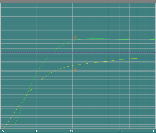

How about, taking a screenshot of each, then overlaying/mixing them accurately. If you overlay/mix the second one by making it more transparent, it "should" work :)
Here's a VERY quick example, which i didn't spend much time on, so isn't 100% perfect. But you should get the general idea ;)
I used the Free Xnview to do it !
I did compare 2 audio files in my screenie, with amplitude versus frequency ! I only showed the bass range, just as an example of what could be done with this method. This was a fairly straightforward way of visualising the difference ;)

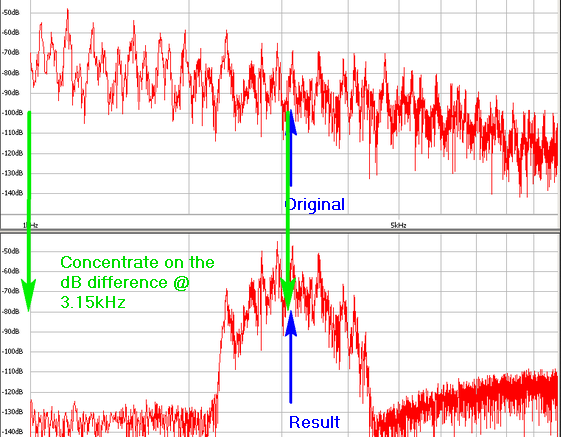

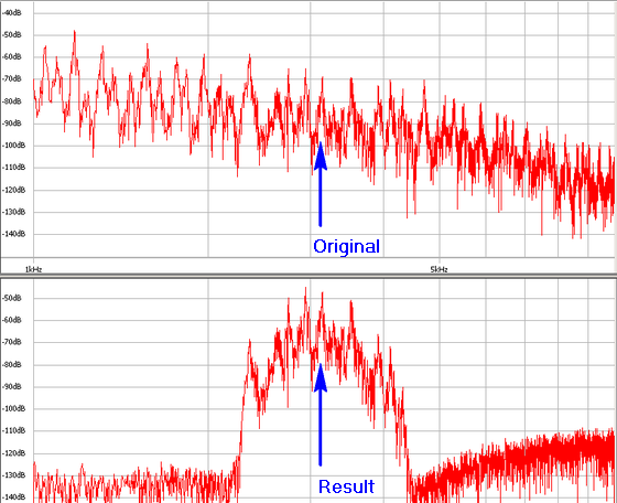

I renamed a Stereo 2 second pad sound WAV file a.WAV & placed it on Track 1 in Audacity. I then Converted it to Mono, & Normalised it to -10dB & removed any DC offset, to prevent possible clipping later in the process. Then inverted it & EQ'd it @ 3.15kHz & Exported it to my desktop as b.WAV I then imported it onto Track 2. Playing both tracks @ once i can hear just the EQ'd difference between them. I then Exported both together as a Mixed Down Single file i named c.WAV & saved to my desktop.
Then i closed Audacity & ran Wavasour, as i like their Spectrum Analysis in Tools. Opened a.WAV & used the SA & carefully took a screenie with my Screen Capture program. Any such program would do that. I did the same with c.WAV. Then displayed & arranged both together in that program, one above the other, & took the screenie posted here. You can see the boost centered @ 3.15kHz.

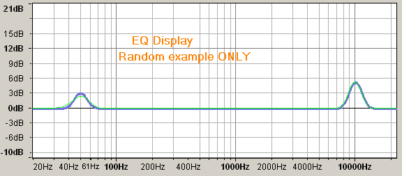

If you're expecting to try & see an exact view of any EQ curve made, as in For eg ONLY, my other screenie, i'm not aware of something that can, After the fact !

Forget about the general scaling, look @ the difference between pre/post eq points ! As i doubt you'll find something that replicates an Exact eq curve, it's got to be better than nothing. I would be able to make use of it anyway !
If you Ever discover Anything that does replicate an Exact eq curve, let us know.

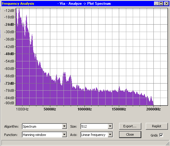

When you said "audacity can generate a graph of the track" did you mean from Analyze -> Plot Spectrum, as i mentioned, or where/what ?

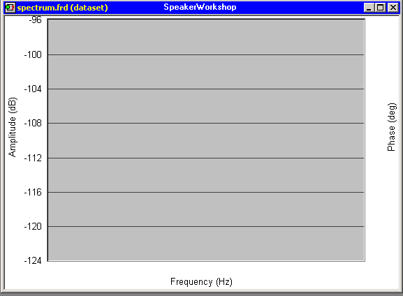

And then with the export button from the File Tab, or where/what ? When i exported it to my desktop via there, it's a .txt file = spectrum.txt. Even after renaming it to .frd & opening it in SpeakerWorkshop, i only see the grid but no data ? Importing it into SW as .txt gets me a blank image too ! spectrum.txt does have data in it though.

do analyse/plot spectrum then hit the export button in the graph window.
the resultant file has freq vs db data but no phase data, so sw displays nil.
open the file with excel and manually add "0" for phase data for all the freq using colomn C, then save the file, then rename it with .frd
